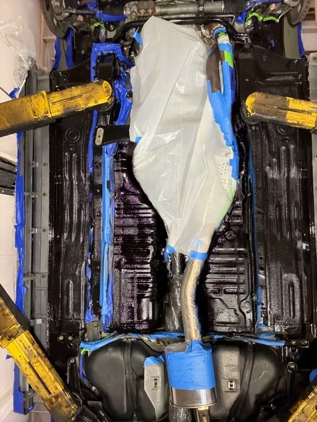

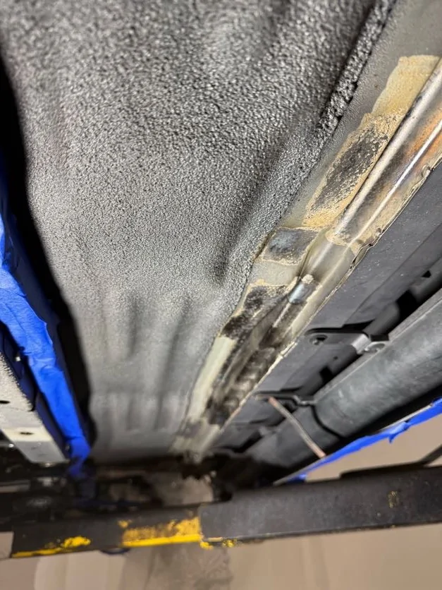

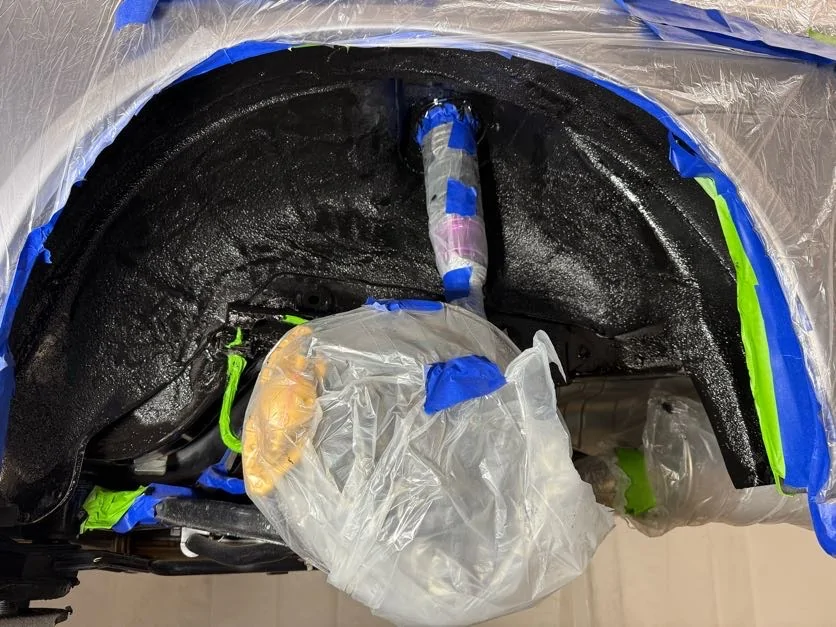

Below are pictures of my r34. All surface rust blasted off with dry ice and laser (last pic). Por15 frame rails and out. Within frame rails, the rest of the undercarriage, transmission tunnel dinitrol. Industrial grade ceramic coating over everything.
