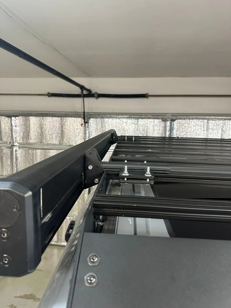

Has anyone installed a Inspired Overland Trailpeak Rooftop Tent on a Westcott Lo Profile rack with Crosswing awning? I can't see how to attach the mounting brackets to the rack cross members under the tent base. How do you get your hands in there?

Not that tent but Openroad4wd tent on the westcott lo profile rack. I am using the Wescott awning mounts.
I have the Sherpa 1" RTT mounts. I have it mounted to 3 bars. The front is accessible via sunroof, the middle with 4 mounts (one on either side of bar) is mounted to bar and remove bar when I remove tent vs remove mounts and rear is second to last and I can remove bar or use a extra long ratcheting box end wrench.
I remove the awing to install the first time and use the wrench to get things tight. It took some time and work to get things set the first time.
