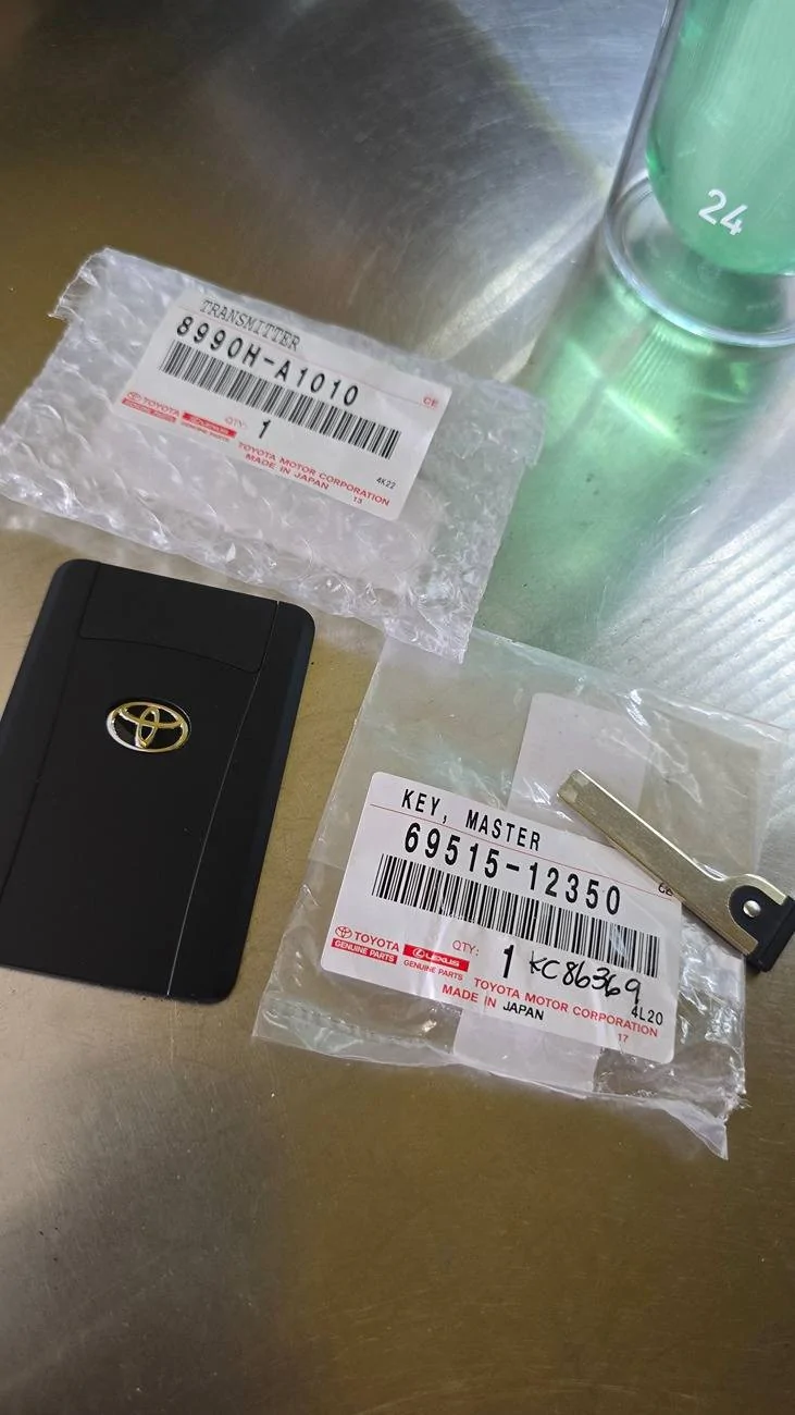

FYI: 4th Gen Tacoma Slim Key Card works with 4runner! Here's part number
ToyoTech808
May 4, 2025
76
Honolulu
25 4runner
24 25 Tacoma slim key card and metal key is confirmed to work on 25 4runner. Programmed to ORP non Hybrid. Can not tell for sure if it works on Hybrid but I don't see why not as the part number is listed for all Tacomas of that years. There is a new part number in the parts catalog but I think its a superseded part. Card key was programmed using GTS Plus on newest firmware. It programs like any other remote in the smart key control unit. With this you can leave your big remote at home and just carry this card in your wallet as long as it doesn't have rfid protection. Its a MUST if you ask me.
PN: 8890H-A1010 key card 69515-12350 metal key
