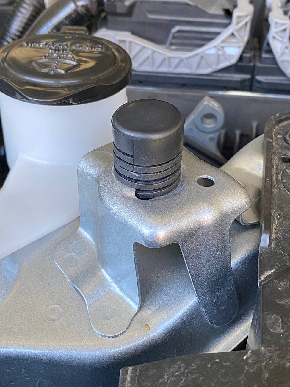

Over the past few days I have noticed a clunk in the driver side front end, seemed to sound metallic in nature. Out for a drive today and the clunk was getting a lot worse, every crack in the road or washboard down some dirt roads made it sound like I was about to lose a strut or something.
Got it home and googled front end clunk in 4th Gen Tacomas and found a thread with members saying to adjust the hood stops or whatever they are called. Sure enough went outside and pushing lightly on the hood above the drivers headlight I could hear the clunk. Quick couple turns of the plastic/rubber piece and that sound is gone.
Not sure if anyone else has come across this but took all of 2 seconds to sort out.
Picture is from the internet for reference.

Noise never came back! Super quick fix thankfully.

Cool good to know thanks, was it like a metal rattle noise for you? And when adjusting the hood stops did you adjust up or down?

It was a metallic clunk for sure, I was certain it was the suspension until I figured I should pop the hood and noticed the clunk just before I did. (For whatever reason I pushed down near the headlight)
I came up on just the drivers side, maybe a full turn. I shut the hood a couple times and pushed down near the headlights to make sure it felt the same on both sides and sure enough no noise.

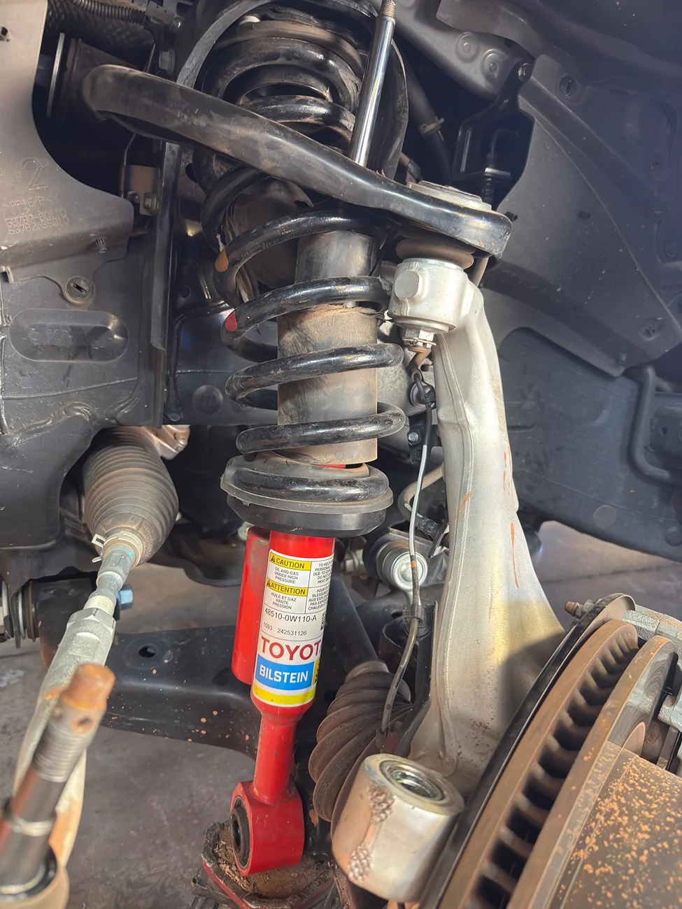

Glad it was an easy fix! I wasn’t so lucky when I heard a clunking noise from the driver’s side. Happened on the White Rim Trail, about halfway through. Have no idea how 🤷🏾‍♂️

I don’t even know exactly when it happened. Based on timestamped photographs before and after showing the damage, I know it happened within a 2 hour timeframe but neither my wife nor I can recall anything of note like a hard bottoming out or anything.
There’s definitely a story about finding ourselves stuck partway up Murphy’s Hogback in the dark, with the transmission overheating and engine refusing to rev. But not sure that it’s related to the blown out strut lol
None of the dealerships in UT or CO had a replacement in stock, so I had to wait in Moab for a week while a replacement was shipped. I will definitely be asking for warranty coverage on this! It’s all good, though 👍🏽

Hey I tried it out, and it fixed it. Drove for about an hour and went on bumpy roads and the metal clunk hasn’t come back. Very happy lol it was starting to get annoying. Hopefully it doesn’t come back
