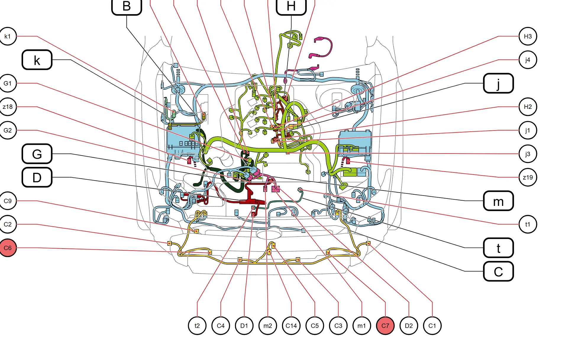

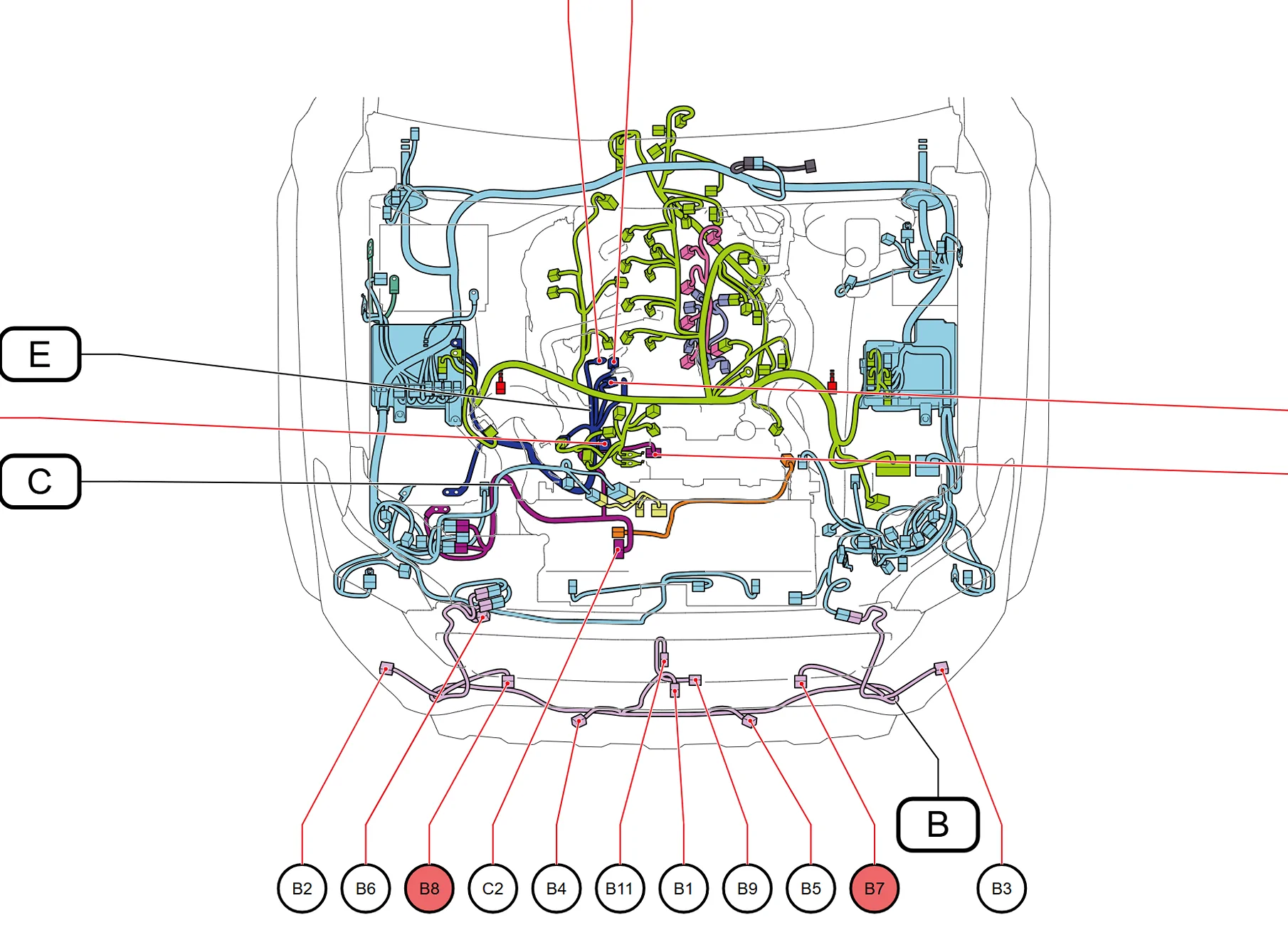

tacoma harness
2025 2026 4runner 6th gen Fog Light Operation 1781575096133-wr
4runner harness
2025 2026 4runner 6th gen Fog Light Operation 1781575211391-8f
what did you use for wiring diagrams ?

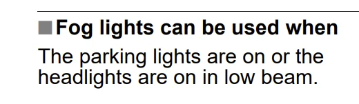

I’ve played around with one at the dealership. They do in fact operate with just the parking lights. It also states that in the Tacoma owner’s manual. (Ford, GM, and Dodge also operate this way.) I think the Tundra is also the same, as I’ve seen one on the road with the parking lights and fog light on. That’s why I think the contacts in the switch are different.

tacoma harness
4runner harness
I just saw the last question in your comment. I got the wiring diagrams from techinfo.toyota.com. The same place as your wire harness images.
