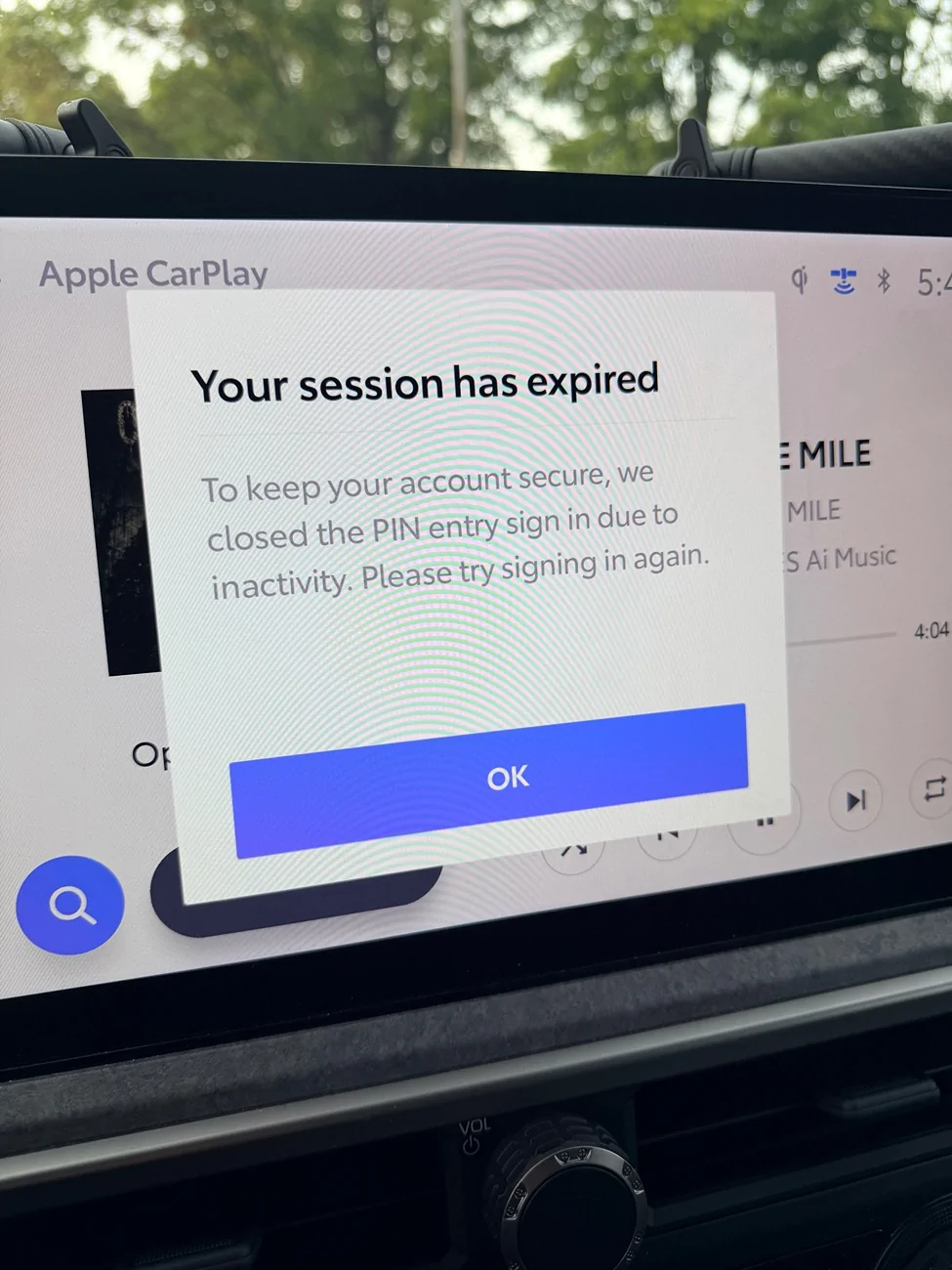

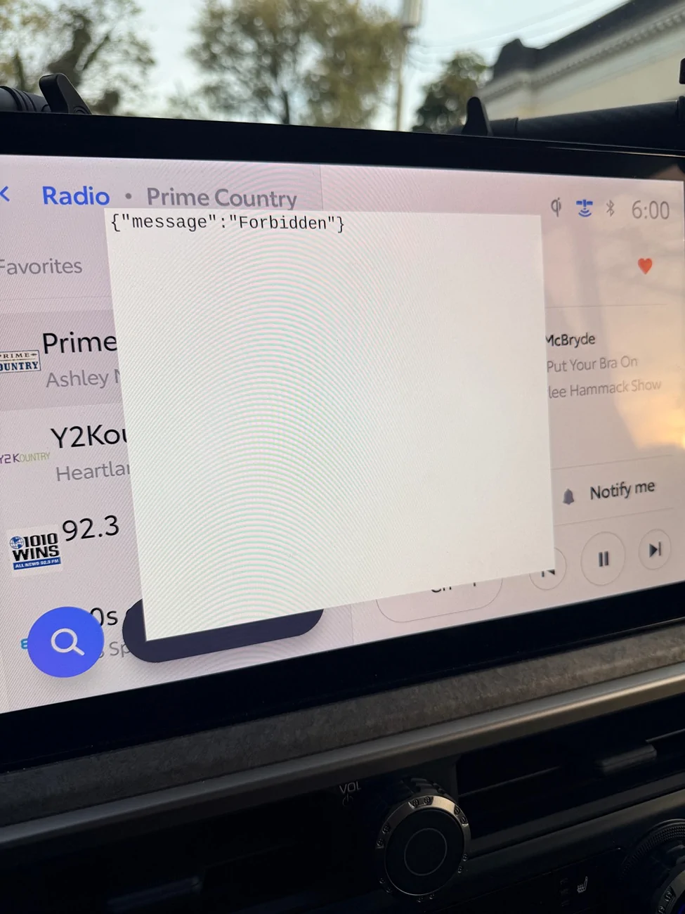

Well this just started today. Any ideas? Eventually I get forbidden error.
2025 2026 4runner 6th gen Enter Pin? IMG_2312

I just got that too, maybe a bug or accident.

And this.
2025 2026 4runner 6th gen Enter Pin? IMG_2313

Did you try and enter a new pin? Didn’t make a difference for me.

No, I just clicked out of the window and ignored it. My guess is an error on the backend Toyota system triggered the popup.

Did this just start today? I wonder if it’s just some thing on their side and not local.

Yup maybe 30 minutes before your post.

It happened to me a while back and it is a real notification that keeps coming back unless it is addressed. Somewhere along the line you did, or now need to, create a pin (6 digits I think it is) that lets you back into the Infotainment system. It communicates with you through your the screen & your phone and the whole episode takes a while. I forget the details but I do remember being on a trip about a year ago and getting locked out of much of the navigation (maps ect.) and entertainment and other stuff Toyota sends you through that screen. While I do not remember the specifics of it I do remember sitting in a parking lot for about 45 minutes, a long way away from home, trying to deal with it as prompts came through the phone & screen. It was painful and totally a drag. But I got through it and the only real advice I can give you is don't forget the pin that you create --- it will ask you again some time in the future & when you least expect it. Good Luck!

Tha night this first happened I went into the app and added a new pin. Yesterday I only drive for about 15 min and it seemed OK. I did get 1 quick message to say "updating settings' I have to drive it for about 4 hrs tomorrow so that will be a test to see if the issue is gone.

From Google:
To fix the PIN prompt on your 2025 Toyota 4Runner infotainment system, you need to enter your 6-digit User Profile PIN or reset it through the Toyota App. [1, 2]
How to Fix the PIN Prompt
  • Enter your existing PIN: Type in the 6-digit User Profile PIN that you or your dealership set up when you first configured the vehicle's multimedia profile. [1, 2]
  • Reset your PIN via the Toyota App: If you forgot or never set up the PIN, open the Toyota App on your smartphone:
    1. Tap the profile/person icon in the upper-right corner.
    2. Select Account.
    3. Go to Security Settings.
    4. Choose Reset PIN (or Set PIN) and follow the prompts to create a new 6-digit code. [1, 2, 3, 4]
  • Sync to your vehicle: Wait a few moments for the update to register, then enter your newly created 6-digit PIN into the 4Runner's infotainment screen. [1, 2]
  • Switch to Guest Mode (Temporary Bypass): If you are driving and cannot reset it immediately, go to the Profile section in your car's settings and select Sign out to guest mode to stop the popup. [1]

I just drove a 5 hour round trip and no error! Success.
