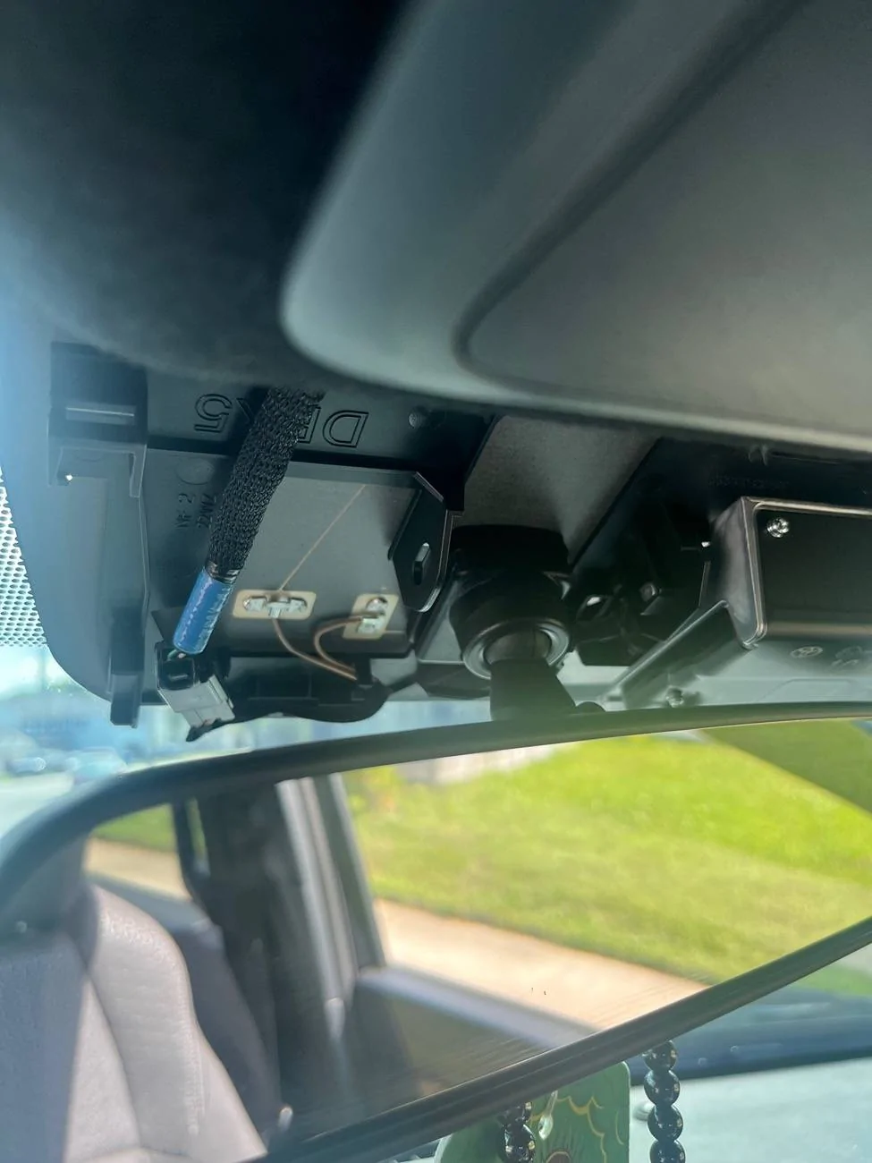

Installed a garmin mini 2 dash cam using the @Dongar pro adaptor. The SR5 does not have a 10pin connector. The 5-pin Dome light is the only one available to tap. Removing the rear view mirror shroud and dome light enclosure is necessary. This has been demonstrated and detailed in other threads.
First pull the smaller first piece towards you and then push down towards the front of the car and the rest of the shroud should slide off. No 10pin connector visualized. Which I have seen in installs involving the Tacoma.

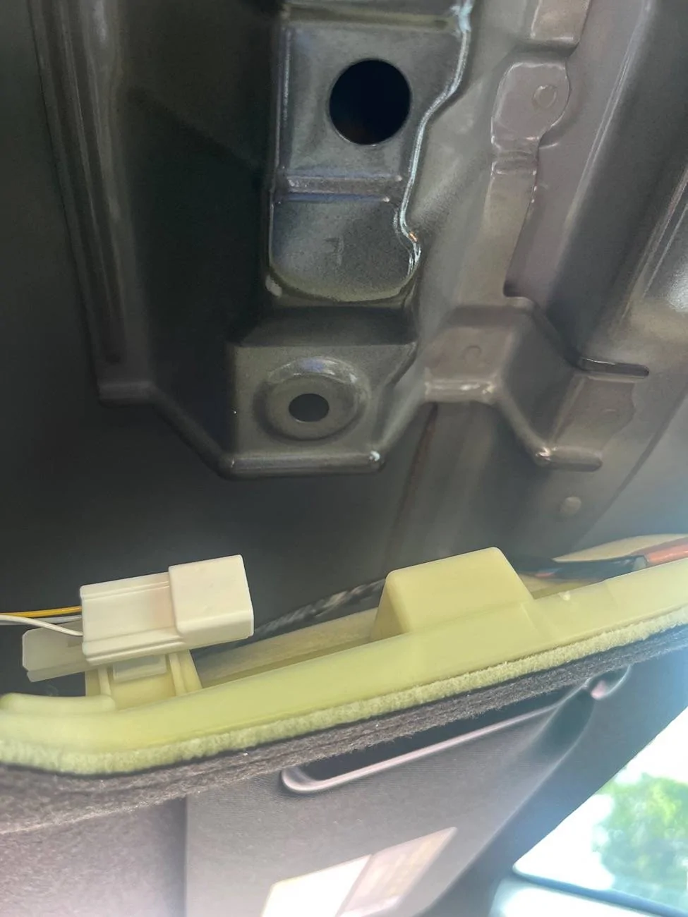

Next pull down the dome light enclosure. Use a plastic panel removal tool to get under the front two corners to release the fasteners then push down towards the front of the car to slide the enclosure out.
2025 2026 4runner 6th gen Used Dongar Pro for install of Garmin Dash Cam Mini 2 in SR5 IMG_1495
Then to the left is the 5pin connector.

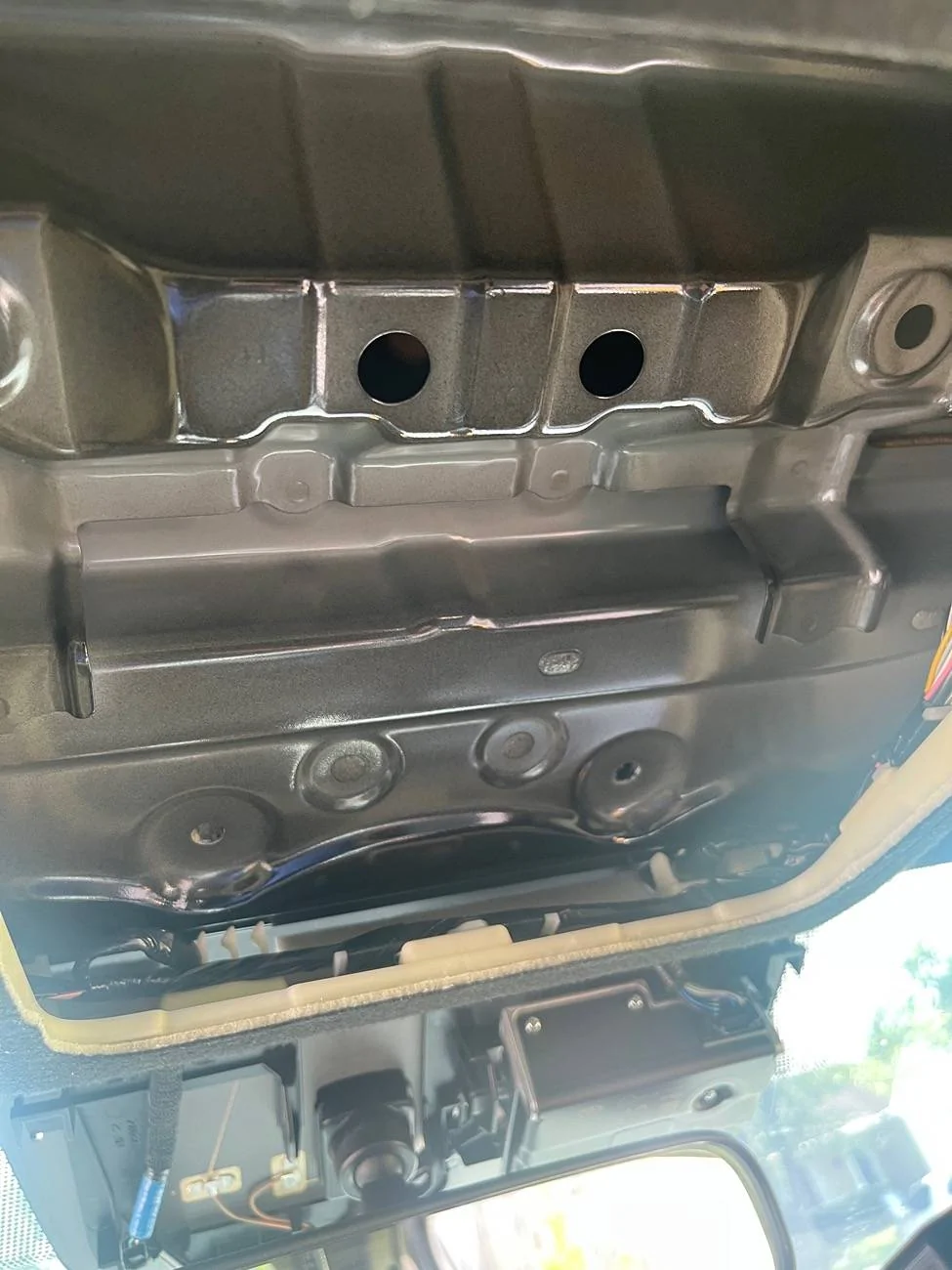

I attached there and then ran the power cable down through the shroud and out the side.
