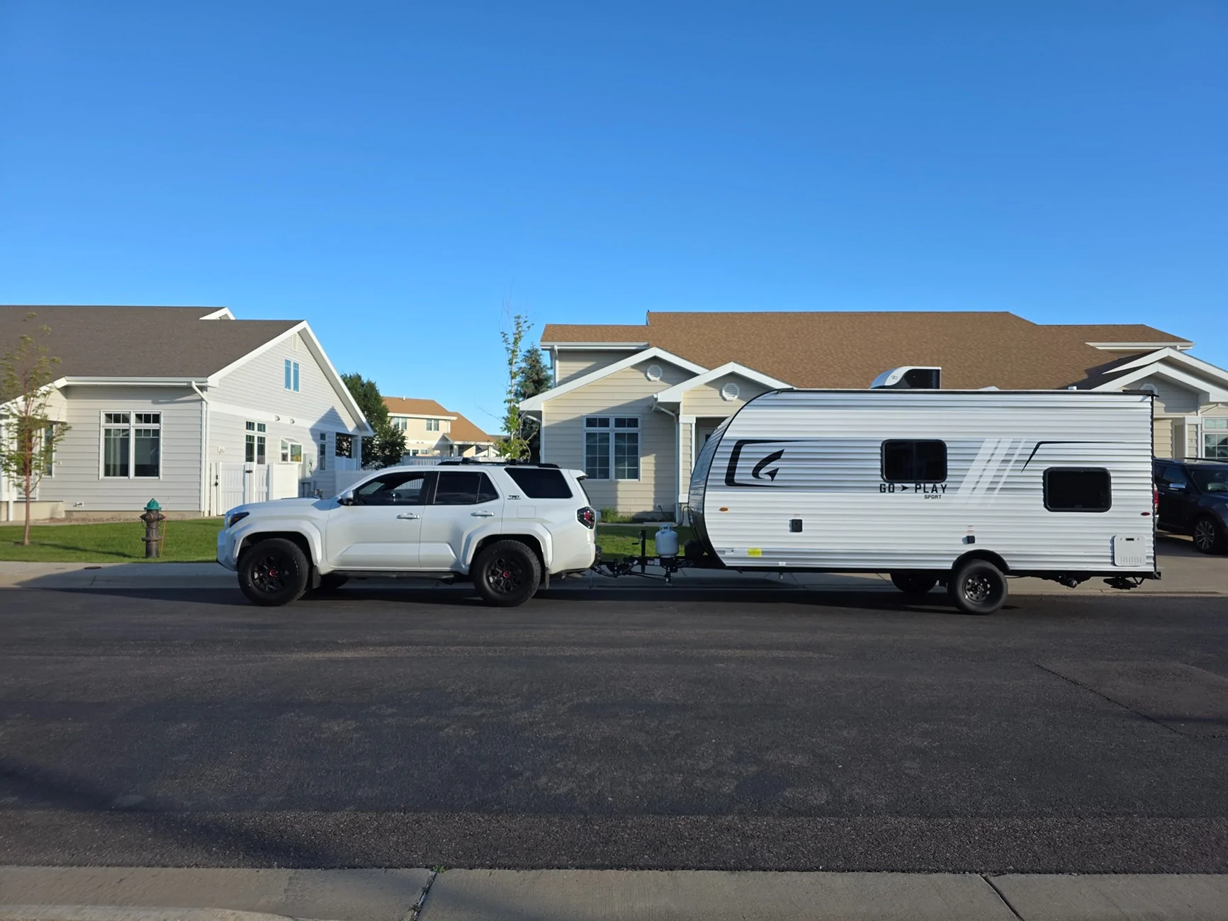

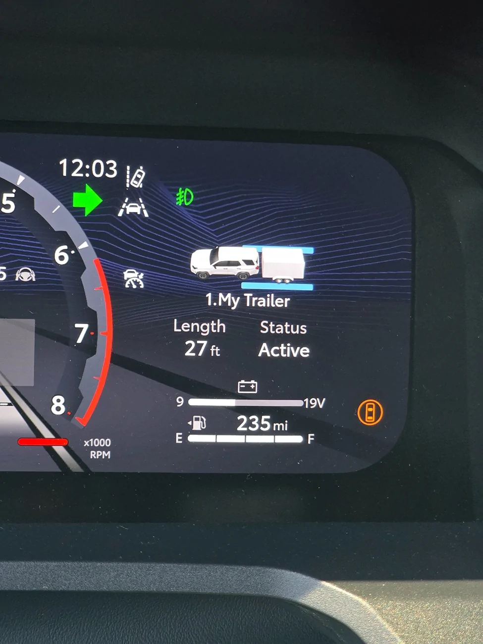

BonRunner
Dec 2, 2025
468
540
2026 TRD Sport Premium / WCP
Just towed 3k lbs this weekend. No issue. I have TRD Sport Premium with no tow package.
The vehicle has option for me to add a trailer but not sure what it does. Most noticeable change is some sensors are off. The back up camera does show the side views with trailer on.
I do have a weight distribution & anti-sway hitch. No sagging at all.
MPG when tow is 10-12 MPG lol. Although my travel has many hills.
