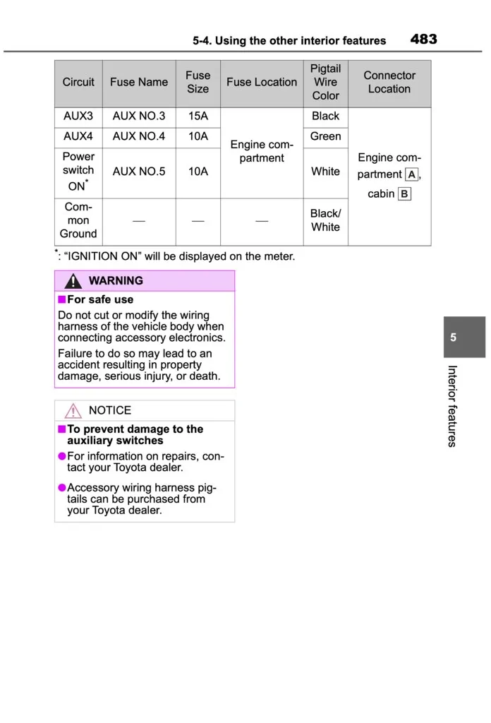

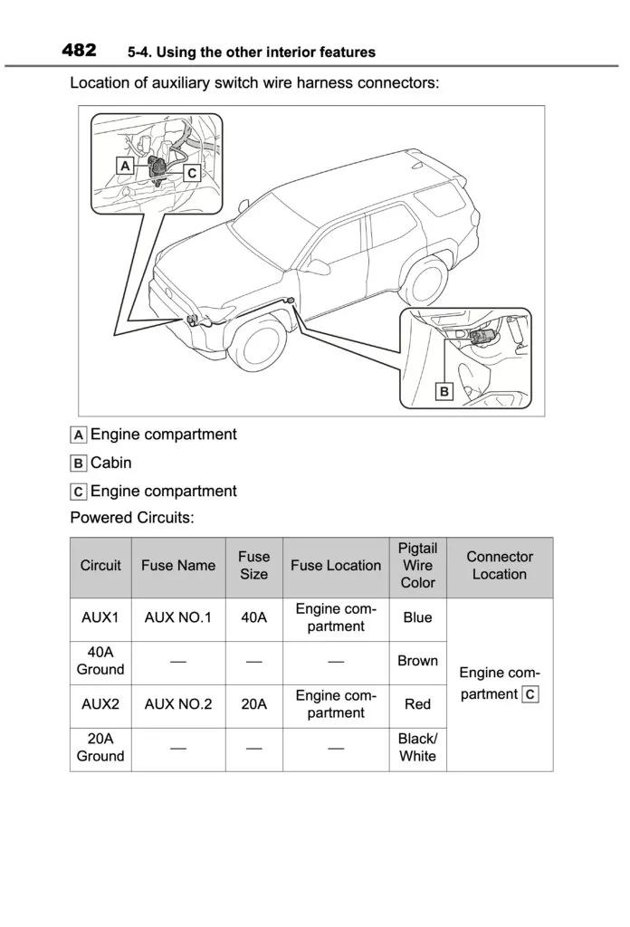

Your accessories might not work correctly because they lack the appropriate amperage. Auxiliary ports supply different levels of amperage depending on where you connect them.

For context, I am running a Midland MXT575 50-watt radio with a 6 dB and a 3 dB antenna. I switch between them depending on the trail conditions. The radio is wired into the AUX always-on-when-powered wires.
even at full draw the midland pulls less then 8 amps. The AUX buttons are if anything over engineered for its application at 10.
The starlink draws even less
