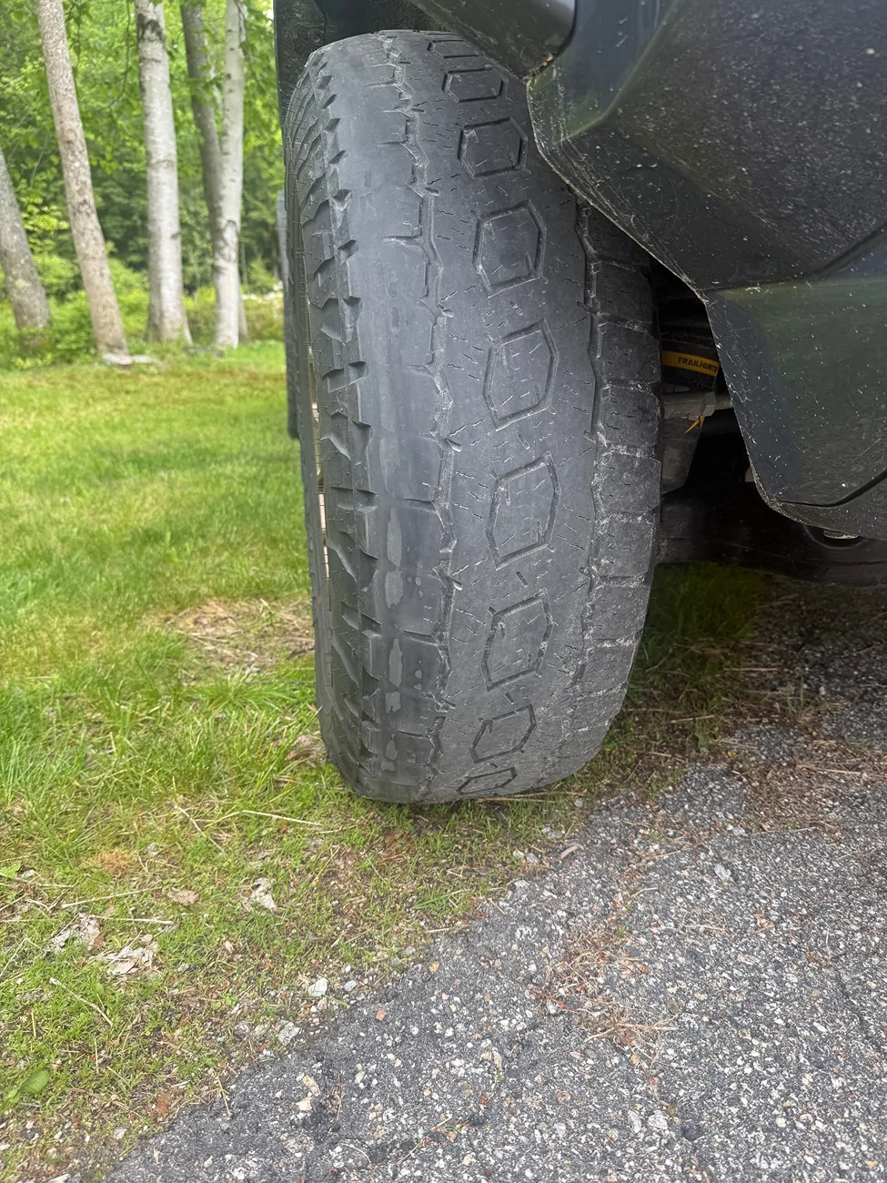

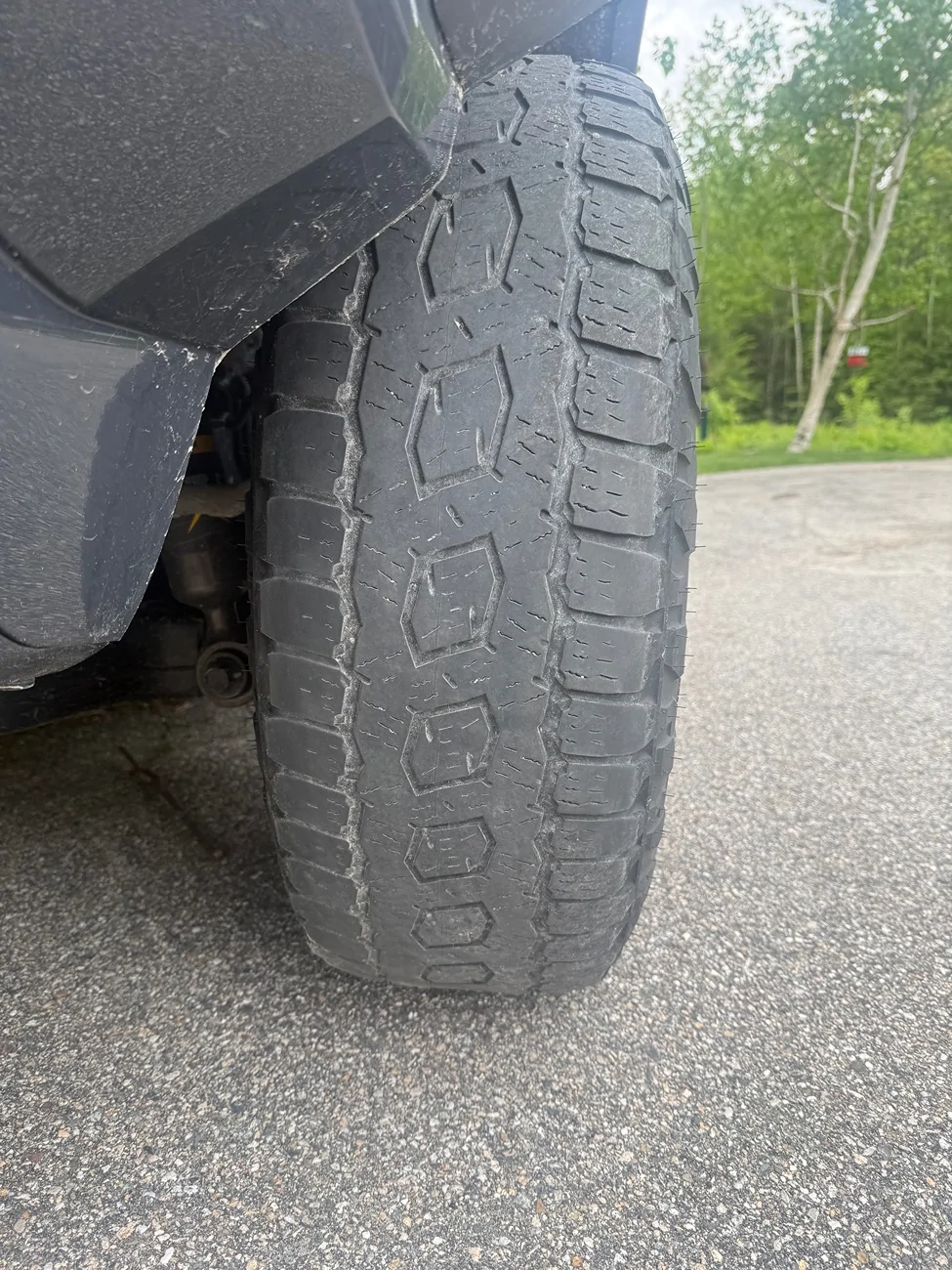

Hello all, I’ve had my 4Runner since June 2025 and now it sits at 21,000 miles. The tires that it came with are still on it but not for long. In April I went in for the 20k mile service and the front desk nerd told me I needed an alignment if I wanted the tires to last until the end of summer. I asked him why and he showed me my front tires were “cupping” on the outside. I’m no expert on tires (it seems this guy wasn’t either) and I decided to let it happen. Now after about 1,000 miles on this “fresh” alignment my front tires are wearing very heavily on the driver inside and passenger outside (see pictures). I’m going back next week to see what the hell happened because now I need new tires pronto.

Have you been rotating your tires? Are the rears just as bad after rotating or just the fronts and only since they aligned it for you? If the rears are still wearing evenly, you could make a case that they messed up the alignment. Perhaps ask them to print out the alignment results for you so you can see if anything was adjusted and where the numbers ended up.
Alignment issues aside, it's appalling to me that your tires could get that bad before you realized they were shot. You are literally through the entire outer tread rubber on the outside of that front passenger tire! :oops:

Yes! The tires have been rotated 3 times already at each service interval, the last one being right before they did the alignment. As far as me not realizing how bad they were, I had just driven 2 hours on the highway to my friend’s house when I got out and noticed there was nothing left on the outside of the passenger tire.
The rears are still in relatively road worthy condition, at least they’re wearing evenly. Before the alignment all 4 were in about the same condition but whatever happened with the alignment has destroyed those fronts
