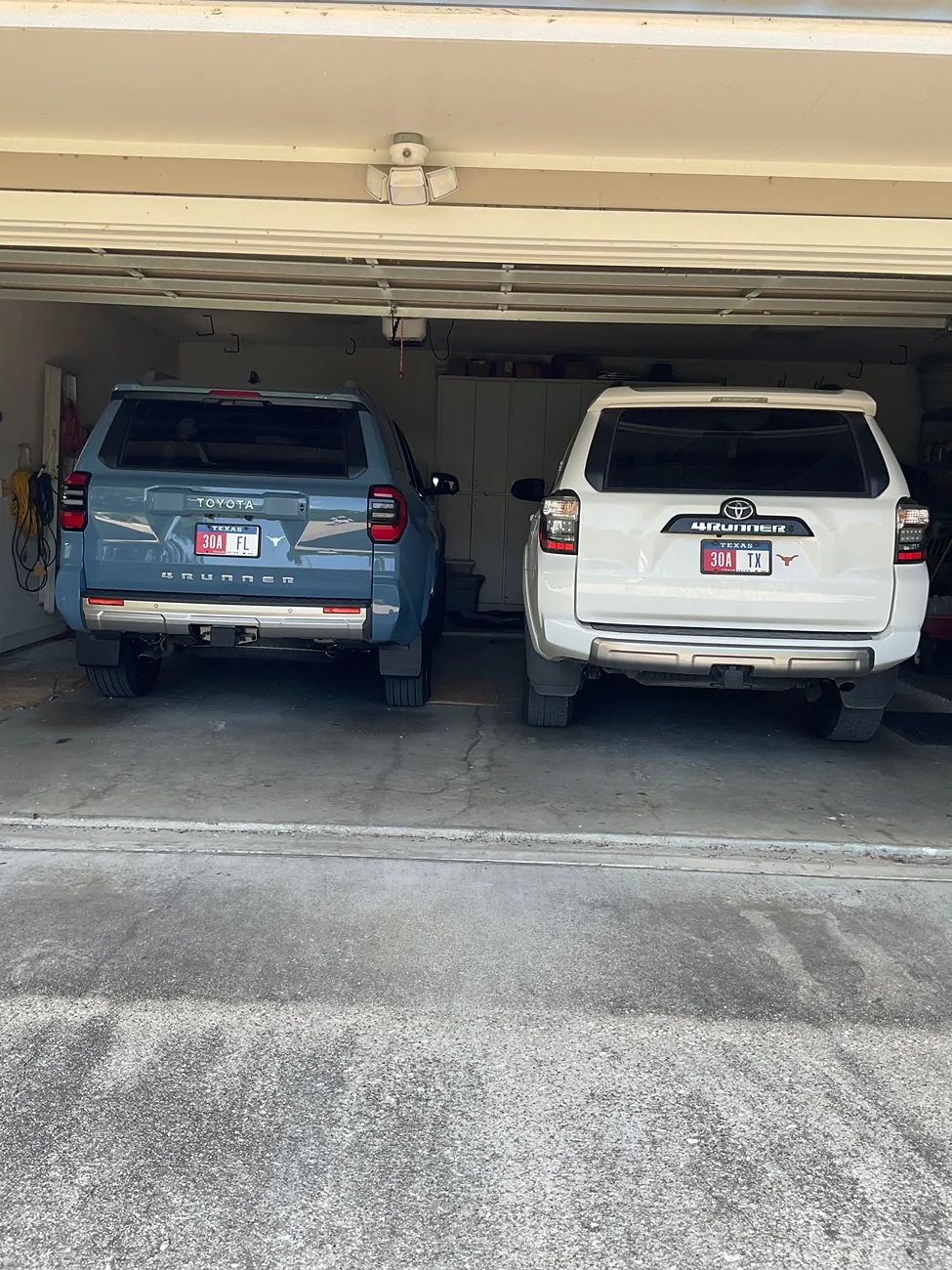

Day 1 parked beside the 2023 raised the tailgate and it touched the metal garage door upper frame. Put a very small cut in paint.
The appropriate 3 years the 2023 has been in both sides and pulled way in as well as just inside and never a problem.
This happened with the new one just pulled in. Found if pulled way in it had just a hair clearance.

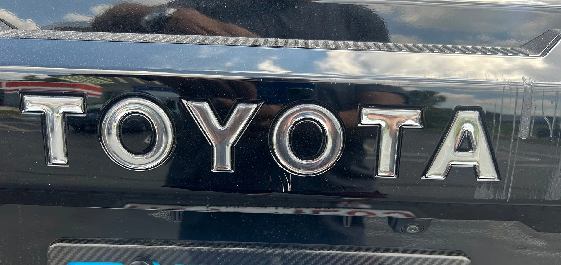

Yup. I found out the hard way. Now I’m hoping that Toyota gets these parts into the market so I can get it repaired. Thankfully it’s just a plastic Toyota nameplate and hopefully it doesn’t cost very much.

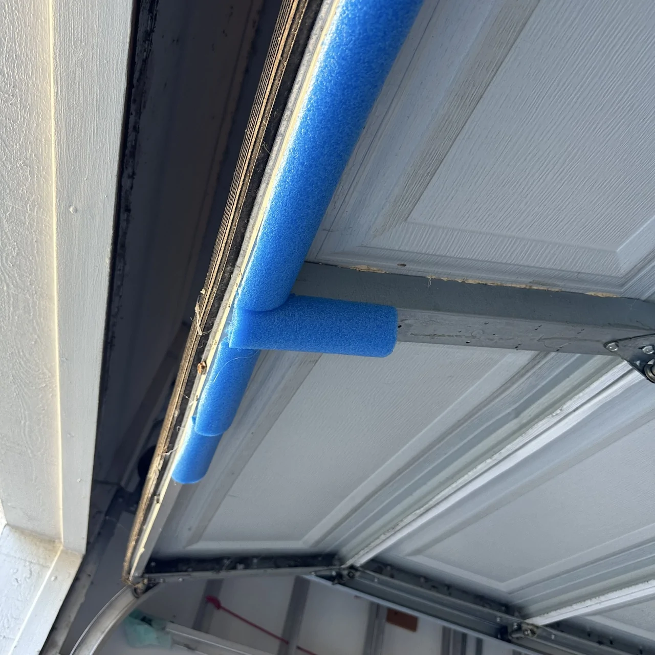

I adjusted the liftgate height using the manual switch method and added a pool noodle for extra protection. If your garage door gets damaged, searching for garage door repair near me led me to Kozmo’s same-day service—they fixed a broken spring in hours with no hidden fees.
