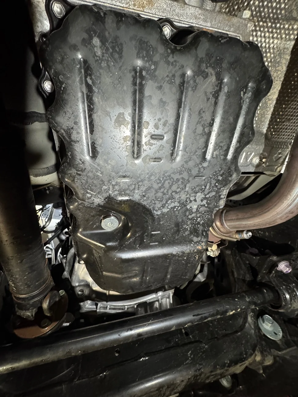

Can’t find the transmission drain plug

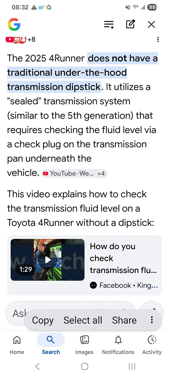

So HOW do you change the fluid? If there is no dipstick, where do you fill it?

I've explored this issue on another forum. I own a '26 Tacoma (ICE) too, and I'm pretty sure it is the same procedure for Tundra, Tacoma....and, of course, 6G 4Runner (ICE). Refer to the link below (especially post #16). Hope this helps.

it's easy if you follow specific procedures in TIS
essentially you add fluid until it comes out the drain/overflow hole

hybrid is same procedure as non-hybrid
add fluid until it drips out the overflow hole
