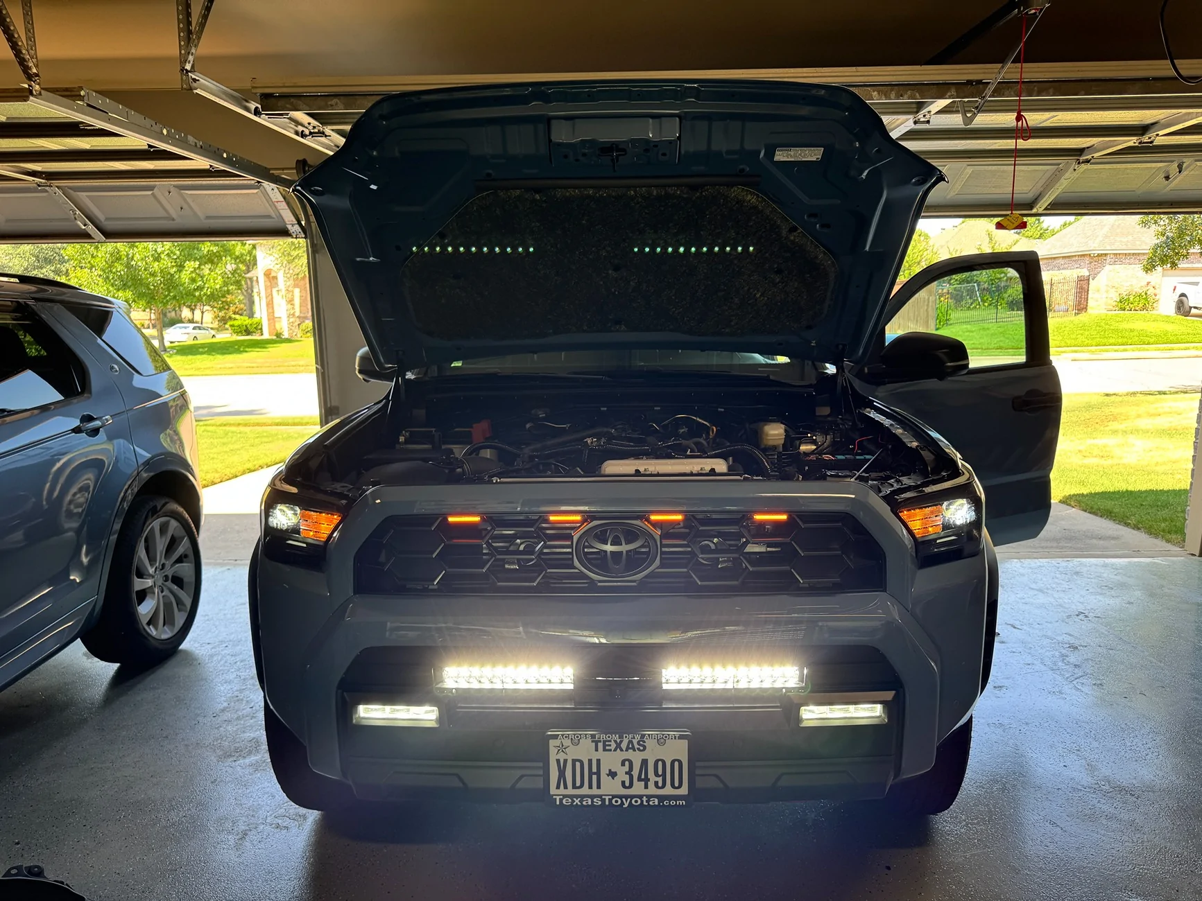

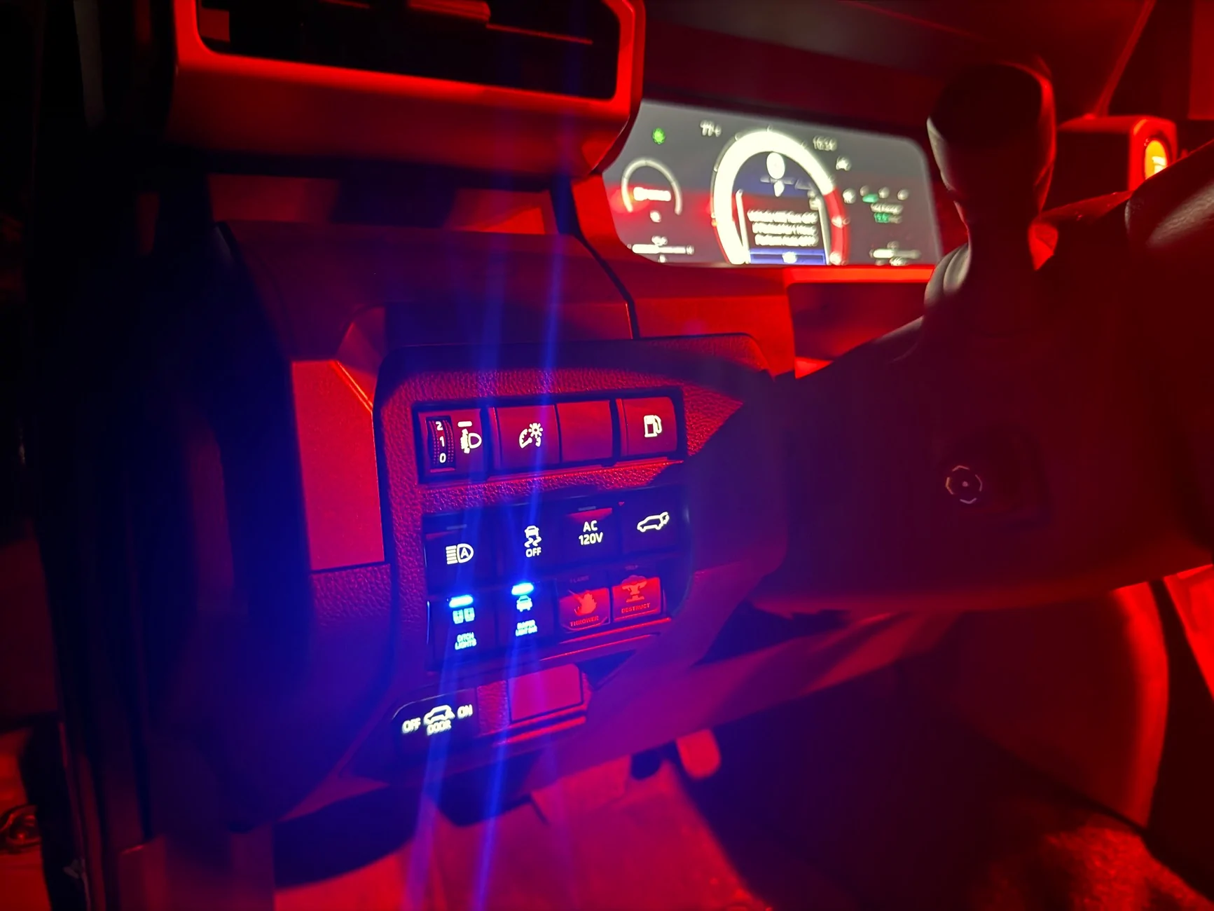

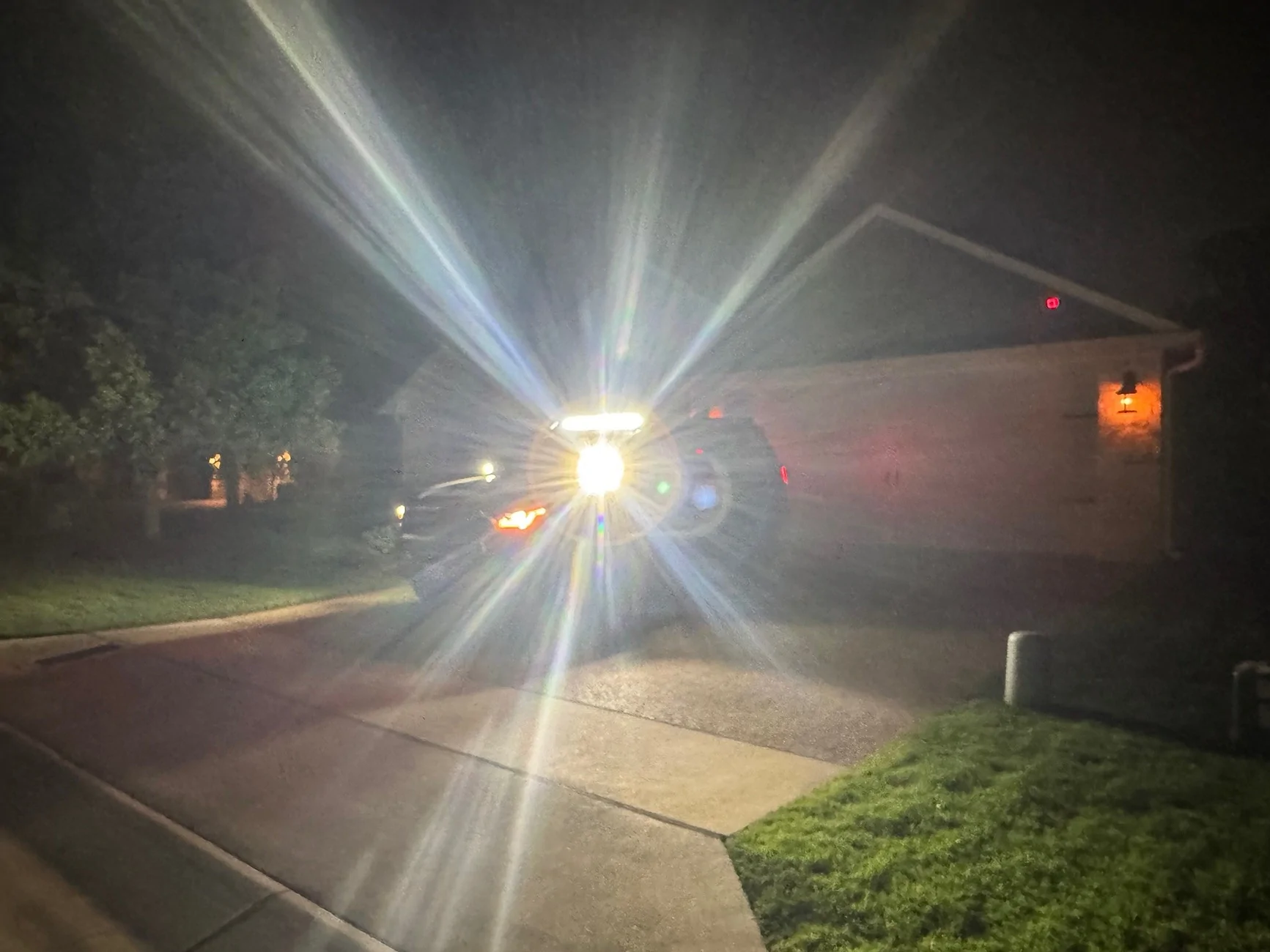

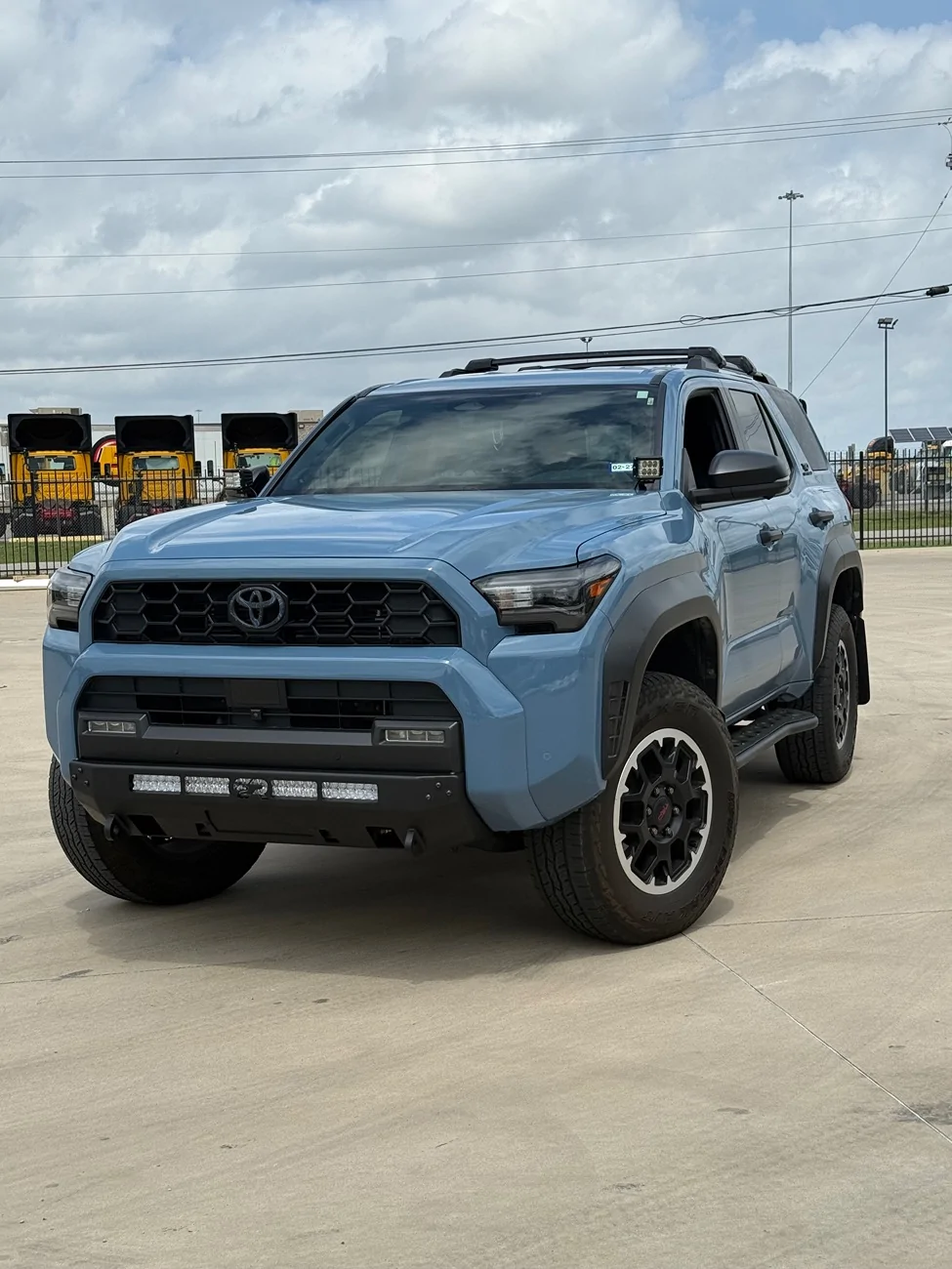

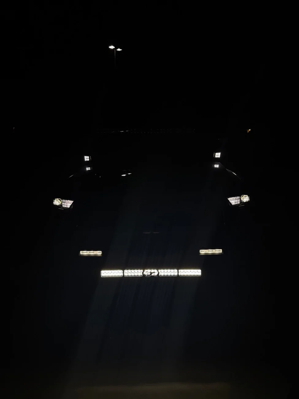

I'm in Texas so I drove over to Cali Raised (Fort Worth) and picked up their new Stealth Bumper and light bar. Quality really impressed me, welds, powder coat looks great. I'm not running a winch but do have the winch tray so it could be added. I went with the 32in combo light bar of flood and spot light. Wiring the light took less than an hour the hardest part was removing the blank on the dash. I feel the truck looks seriously tough now. We will be driving at night in Utah near Factory butte this summer and around Moab so the lights will come in handy for sure. I made a video showing all the different lights from inside and out to help others thinking about it.

Looks sweet! Just put their roof rack with light bar and 360 lighting on my Pro. The bumper winch combo is my next upgrade. Where do you put the license plate? Does it cover the winch lead slot? I see you are in Wylie, I am in Waco. We ought to go out to DOMO off road park in Gatesville and do some off roading sometime!

Great illumination and very clean set up. Something to consider with the stealth bumpers and winches is how you are going to access the winch when you need it. It looks like you have an open access to the left of the fairlead space - not sure what that will allow you to reach on the Cali Raised. Work around is wireless controller. Several options out there and I think you can get the Warn Zeon with wireless out of the box..but it’s kinda pricy. ADD makes a license plate holder that bolts to the clevis mount so you’re legal here in Texas and you can just pull it off-road or out of state. And give Hidden Falls a go down in Marble Falls. It has some fun climbs.

Bumper was just released they are making a license plate solution that will be out soon. It seems like half the cars in Texas don't bother with a front plate so thats what I've done the last year. They said it would be removable for when off roading I guess. I've only really off roaded in other states, for sure need to check out some the parks in Texas

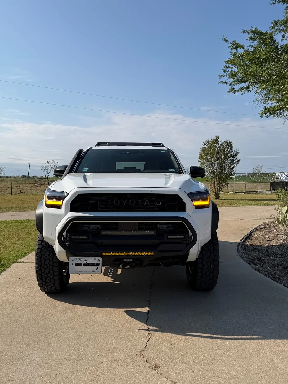

HEADS UP!!! Make sure the light bar is not touching the radar harness in anyway shape or form. I installed this light bar back Aug when it was first released. The brackets pushed the light bar onto the harness and caused a short which then thru every error and check engine light. I needed to bring it into a Caliraised installer they recommended in Haltom City who found the issue and drilled new mounting holes in the bracket to move the light up and back a few mm's. I did call Caliraised and told them of the design flaw in the bracket, so I hope they got it fixed.

I'm not going to put the grill light bar. I'm planning on just sticking with the bumper. I don't have a lot of experience wiring up lights on cars so I skipped the step of having the switches light up at night. I wired it up off the battery strait to the switch
