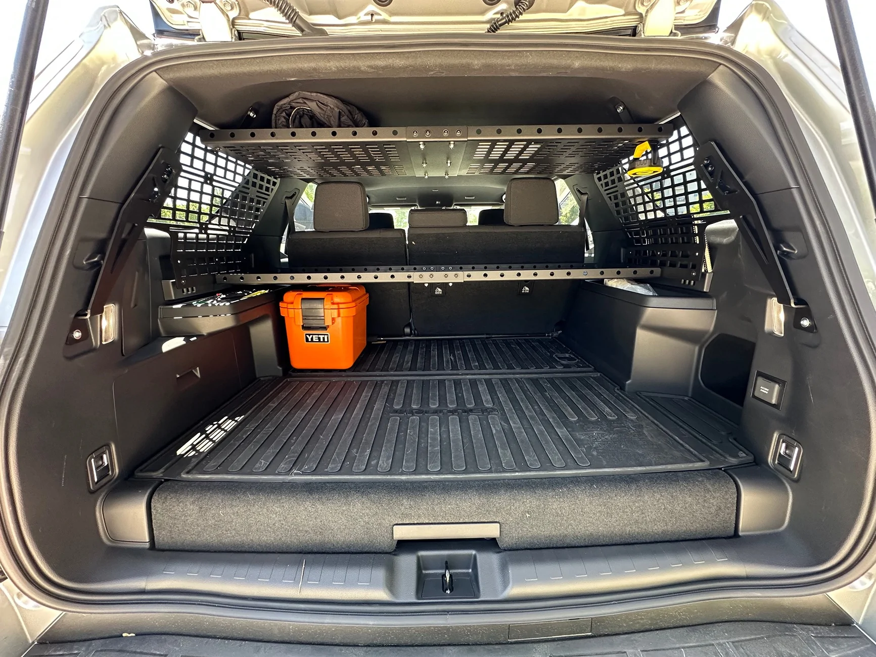

I got this installed and pretty pleased overall. The middle tray is fairly low, but there are two sets of mounting points and this is installed on the lowest one. I also only used two of the three points and shifted the whole tray forward.
I like the Cali Raised trays, but install video is somewhat spotty and be prepared to have some parts left over. Mine came with two options for the top bolt- a plastic insert and a large screw and a nutsert with a machine screw.... of course, the nutsert was in the middle tray box which I opened after the sides and top tray were installed. No way I was removing it to swap the hardware, but I've got it if I ever.

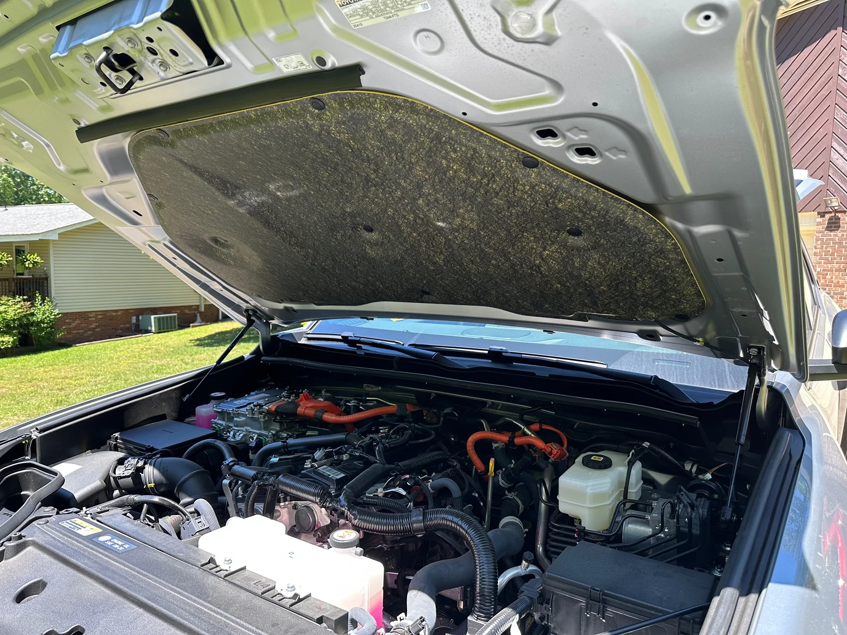

All in all, pretty clean install. Also, put on the Redline hood struts. They came with zero directions, but it's pretty easy to figure out from the photos on Cali Raised which puzzle piece goes where.
2025 2026 4runner 6th gen Cali Raised Interior Window Molle Panels and Overhead Tray installed in cargo area IMG_3825
2025 2026 4runner 6th gen Cali Raised Interior Window Molle Panels and Overhead Tray installed in cargo area IMG_3823
2025 2026 4runner 6th gen Cali Raised Interior Window Molle Panels and Overhead Tray installed in cargo area IMG_3824

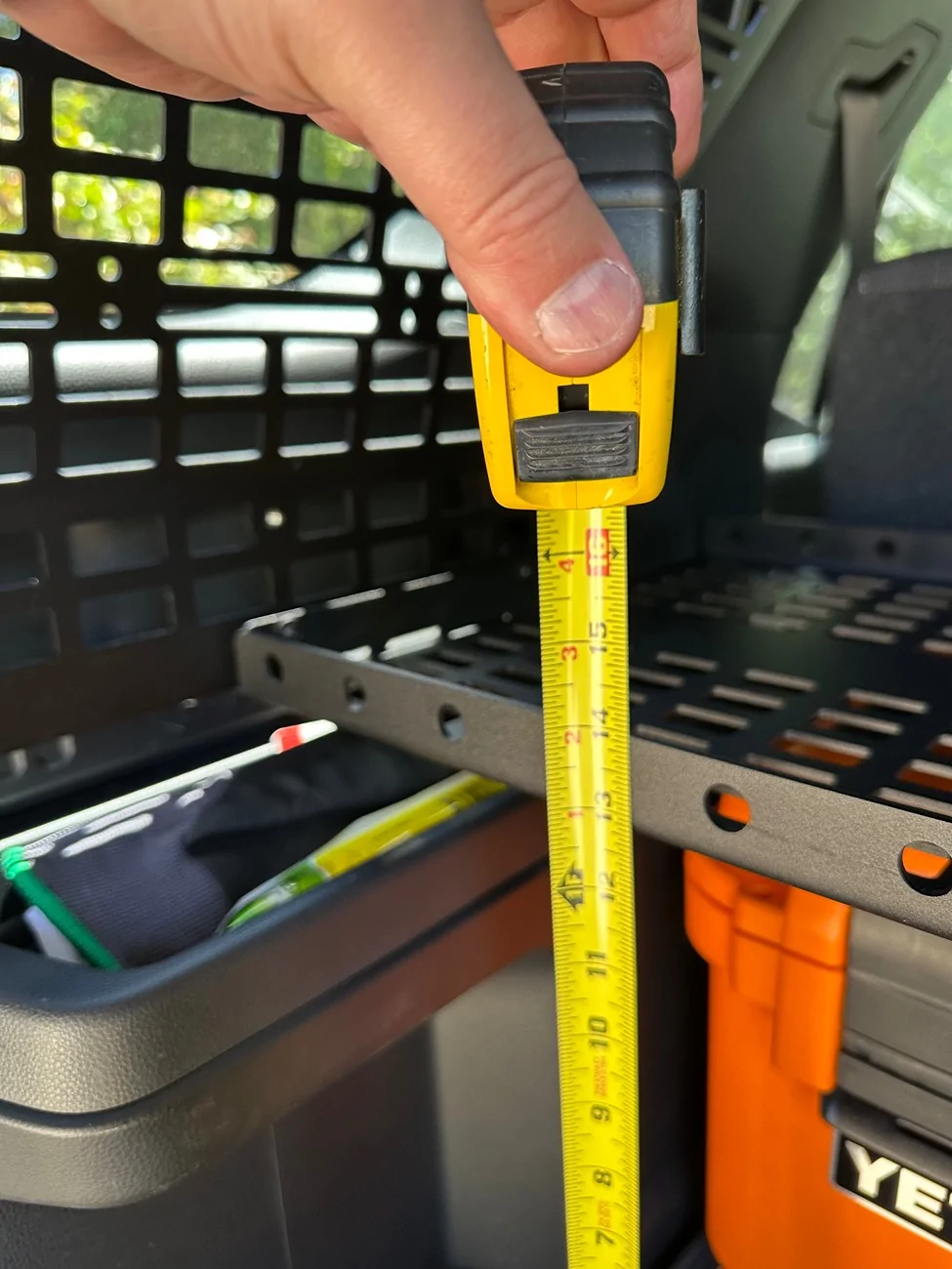

Can you tell me the distance between the mounting points you used and the upper ones? I know it’s not much, but every little bit counts.

The bottom holes are 13" from the floor, the top holes are 2" higher so the bottom of the lower tray will be 15" from the top of the load floor.
In a non-hybrid, you'd have about 4" more with either.
