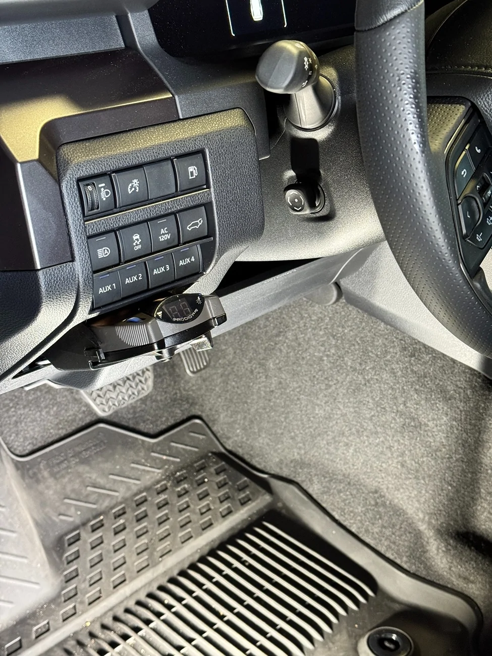

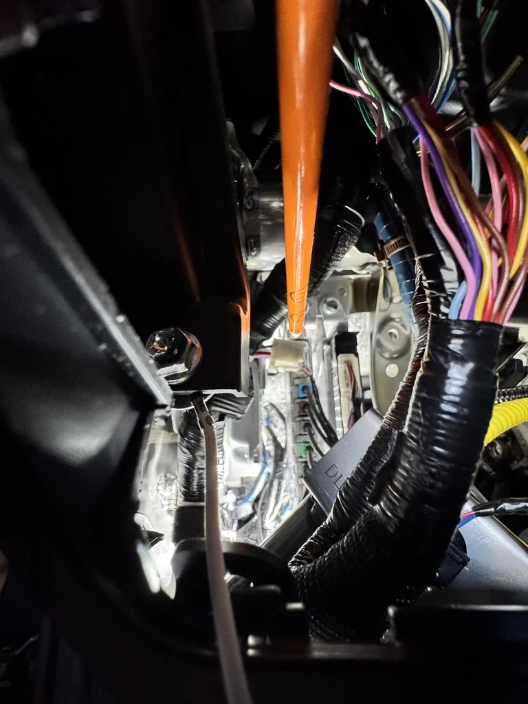

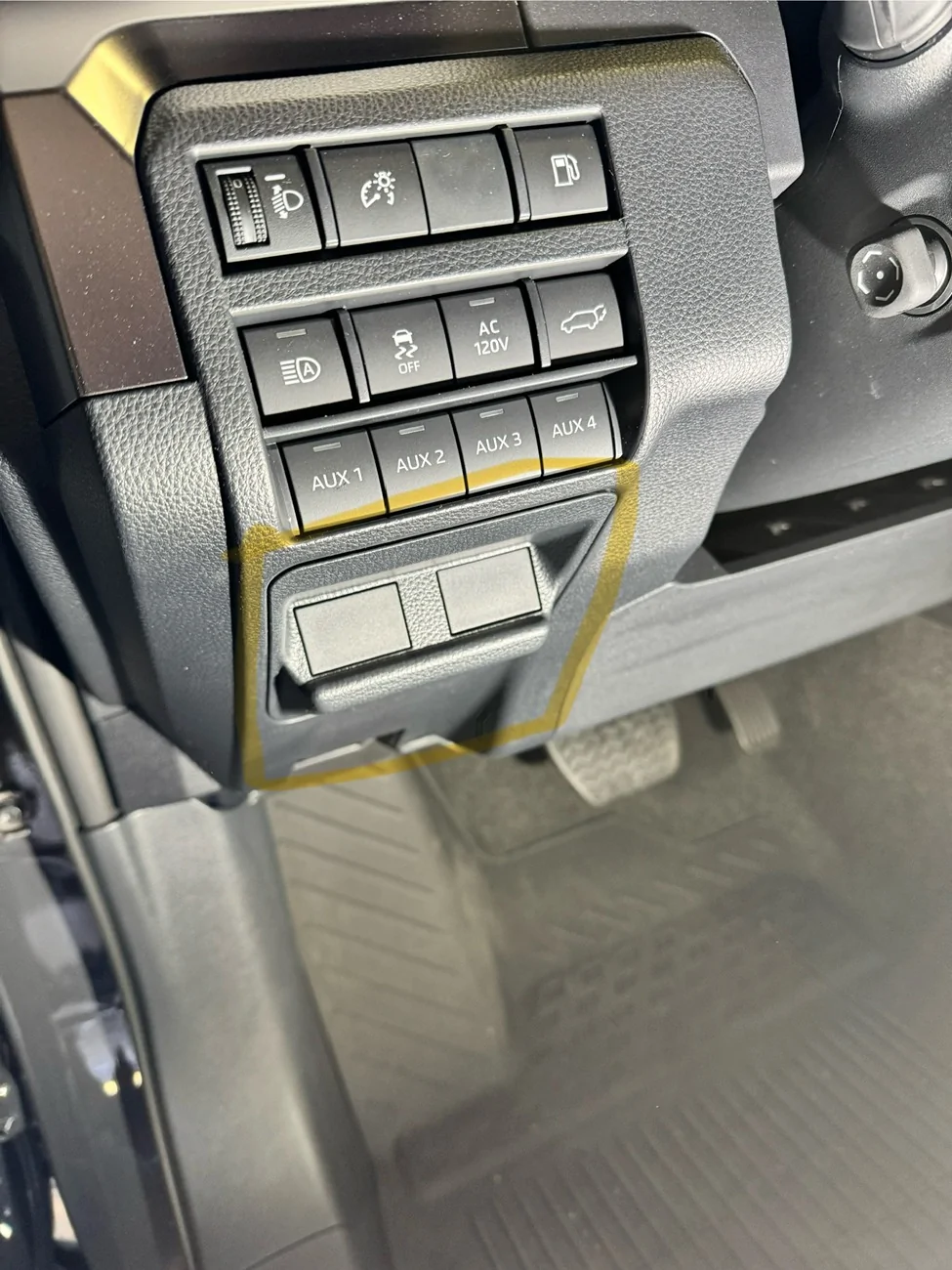

If your 2025 4Runner doesn't come with Tow Tech Package factory installed, then it won't have a wiring harness to connect the OEM Toyota controller to under the dash. Tacoma and 4Runner owners have found that there's no way to retrofit install the OEM brake controller. Even Toyota dealerships don't have a solution to add the OEM brake controller. That leaves aftermarket trailer brake controller as the only option.
AFTERMARKET (PHYSICAL BRAKE CONTROLLER)
I've seen Tacoma owners installing Redarc trailer brake controller though, so there's aftermarket solutions at least. I've attached a couple of great installation guides for Redarc Electric Brake Controller posted by Tacoma owners:
Aftermarket Trailer Brake Install Guide #1
https://www.4runner6g.com/forum/att...tallation-for-2025-4runner-6th-gen-docx.7117/
Aftermarket Trailer Brake Install Guide #2
https://www.4runner6g.com/forum/att...instructrions-2025-4runner-6th-gen-docx.7118/

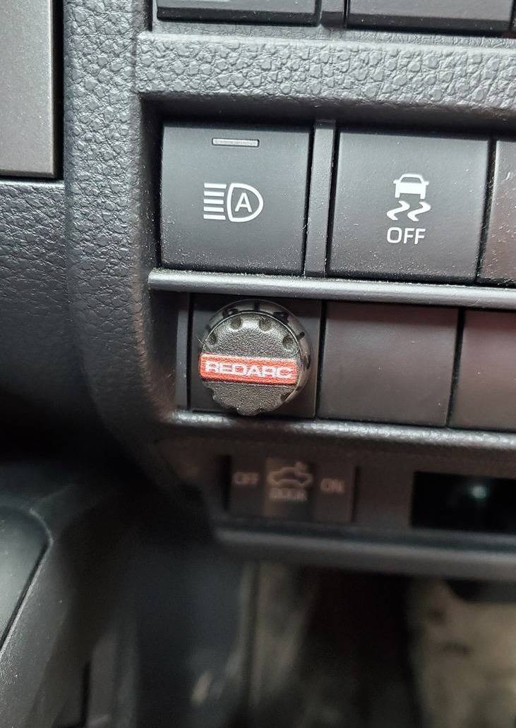

Here's what Redarc brake controller switch looks like installed in blank dash location.
