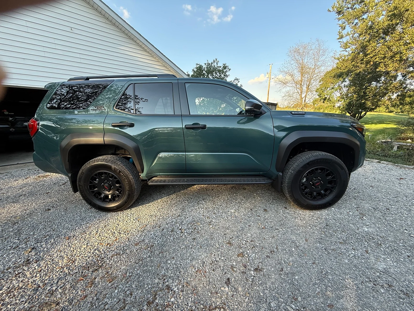

I feel you. Here's our ORP before and after. You can also take your fugly wheels and have them powder coated satin black and they'll look amazing. Check out the 4th Gen Tacoma Pre Runner that has the same wheel finished completely black. I also installed the Westcott Lift
2025 4runner 6th gen Bonus time:  Want new wheels and leveling kit IMG_1347
2025 4runner 6th gen Bonus time:  Want new wheels and leveling kit IMG_0522
