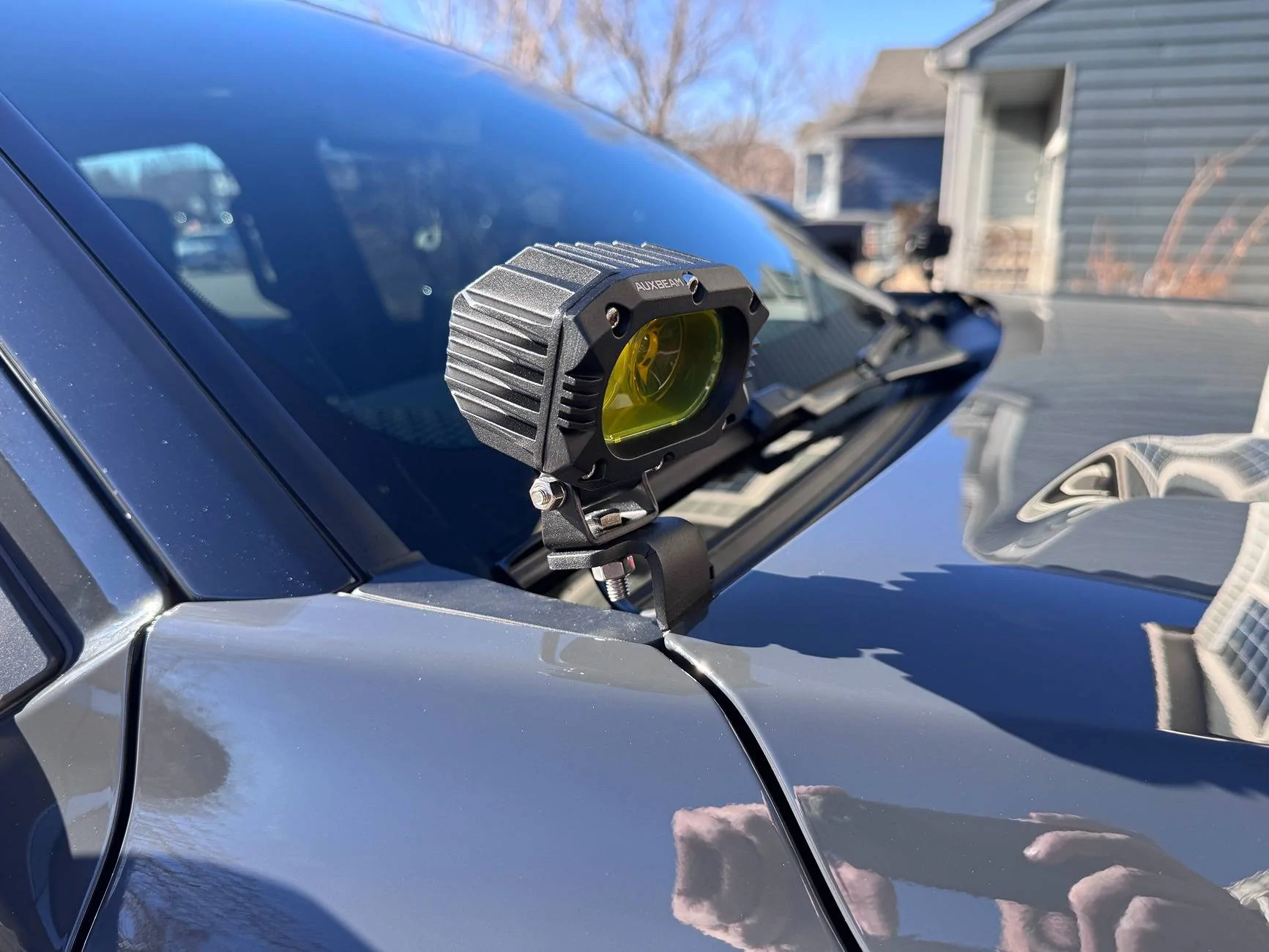

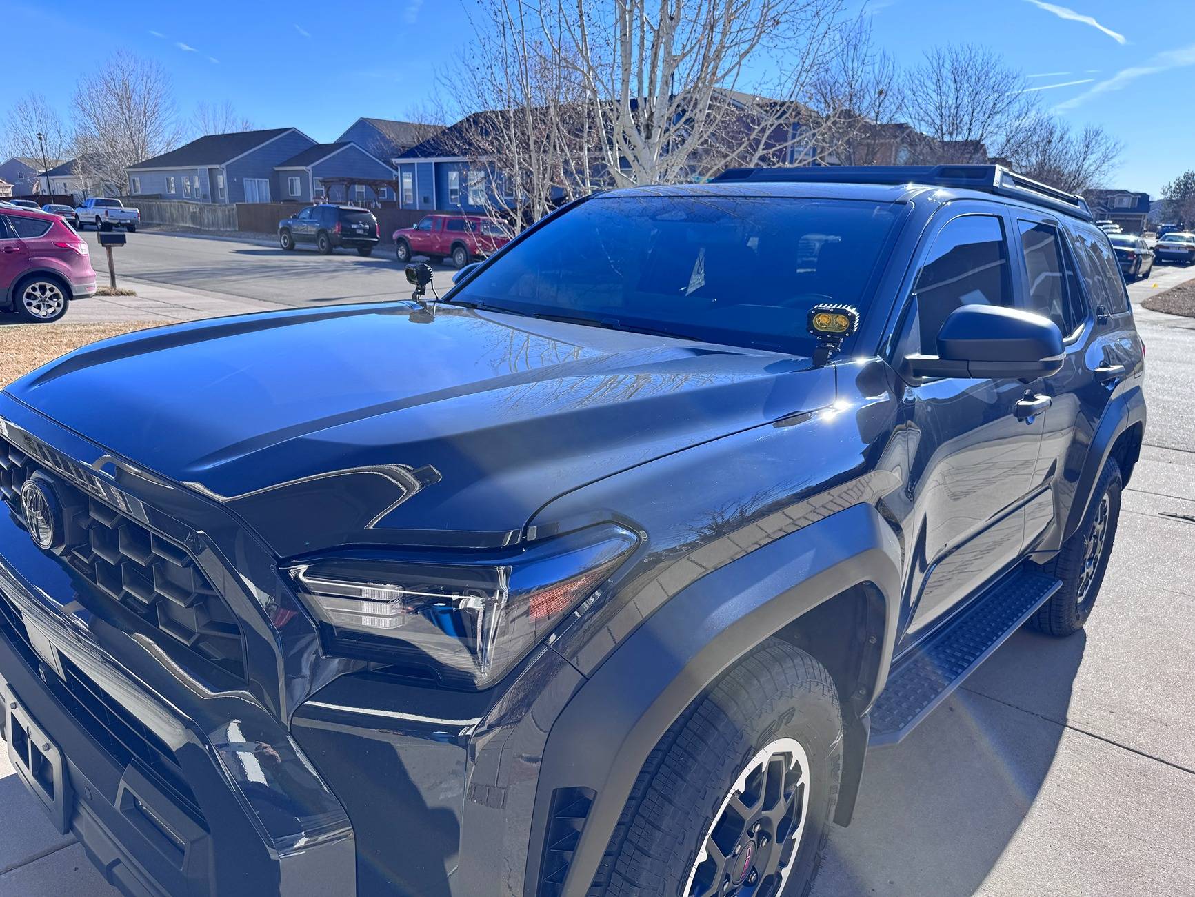

Mounted the Auxbeams yesterday and got them wired up today. I must say running wires from the engine bay to the cab was 100% easier than when doing the same thing on my 3rd gen Tacoma. Will post night pictures when it's dark.

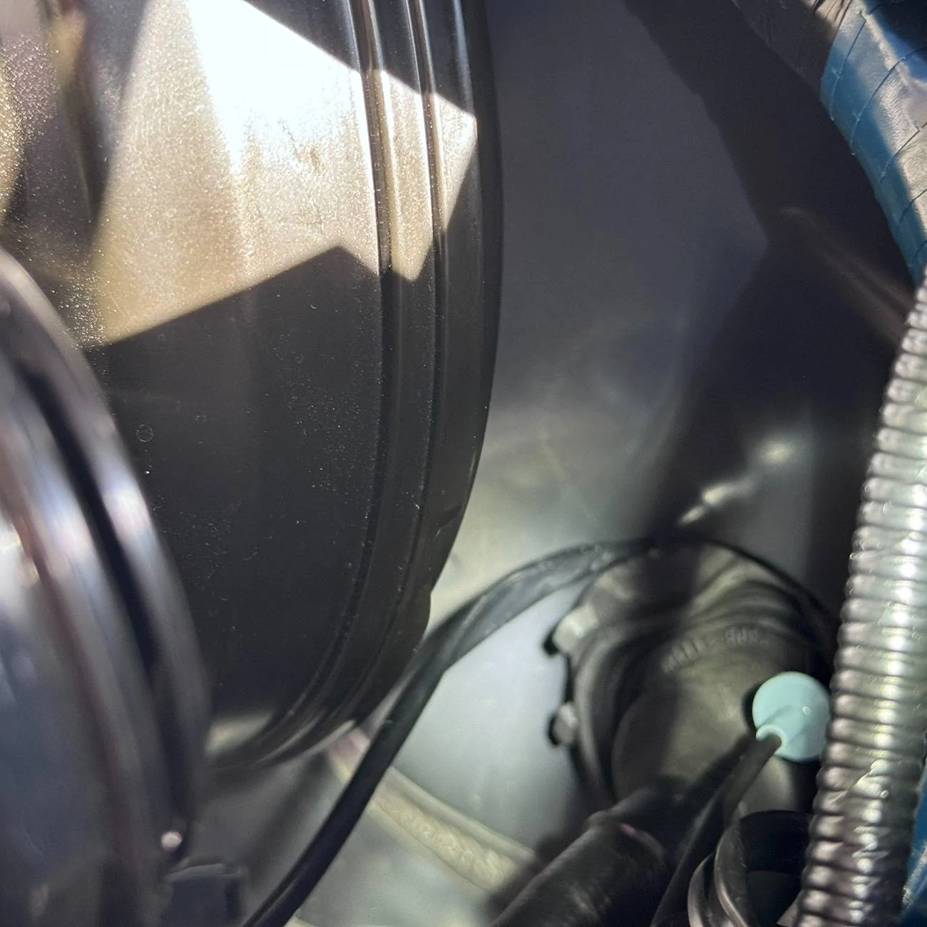

Here is the wire pass through the fife wall

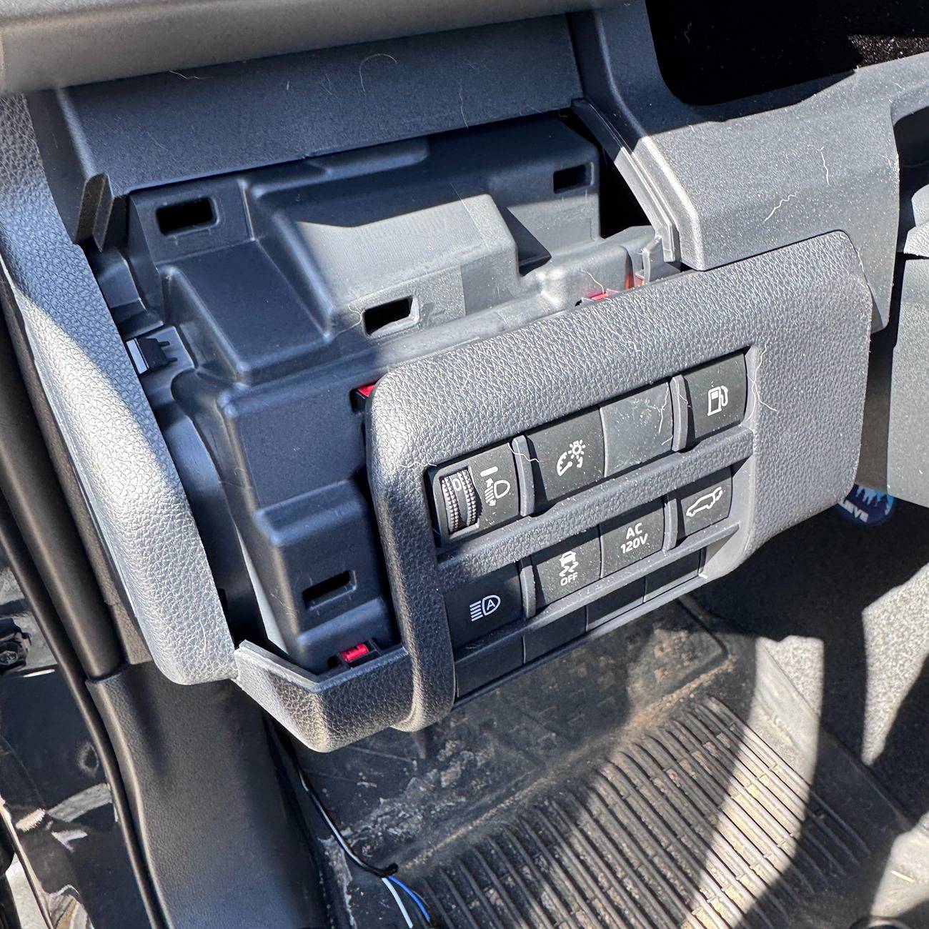

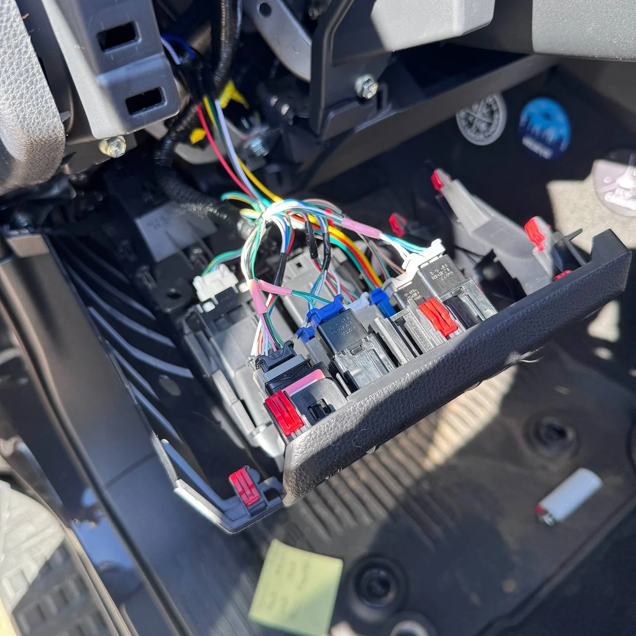

Taking apart the dash

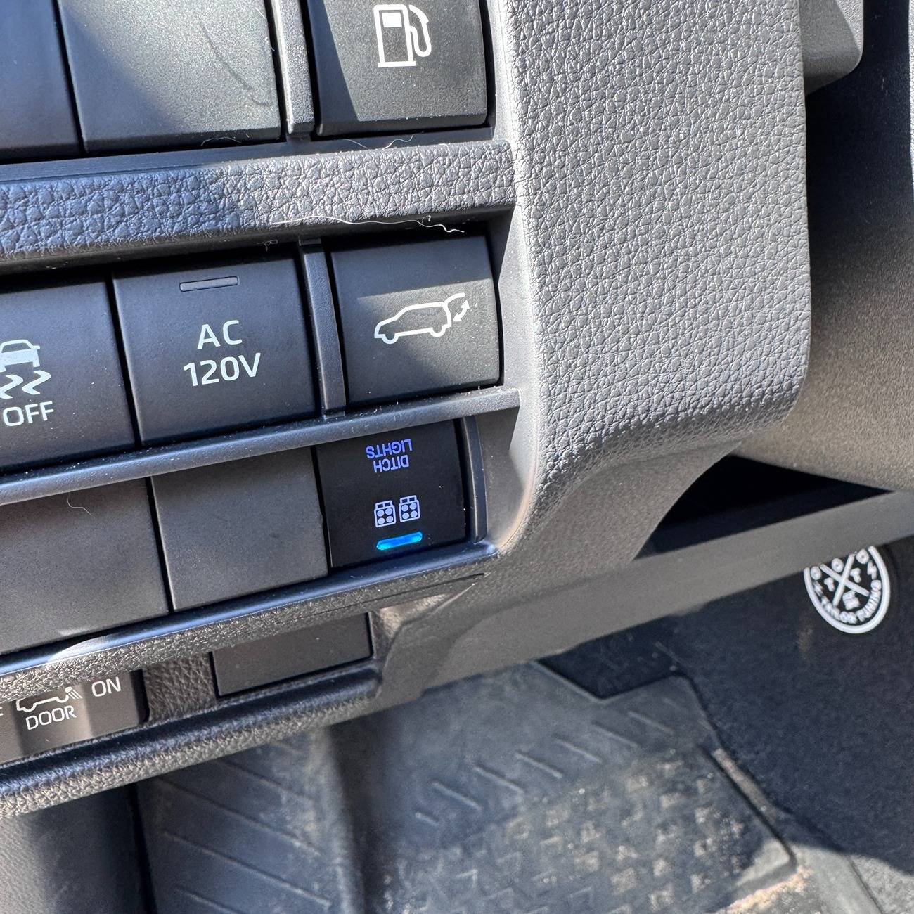

Switch lit up, yeah I didn't notice it was upside down until it was put together, next time I have it apart I'll flip it.
2025 2026 4runner 6th gen Auxbeam Ditch Lights installed (DIY how-to instructions) IMG_7324.JPG
Let there be light!

Wiring configuration.
Harness black to switch black + white
Harness white to switch red
Harness blue to switch green + yellow
There is a way to wire it so when the dash lights come on the button lights up, I just did ti so when it's on it lights.

Is there a reason for the upside down switch?
Other than me not paying attention ?‍♂and not wanting to take the dash apart again at that moment, no. I'll probably fit it this weekend.

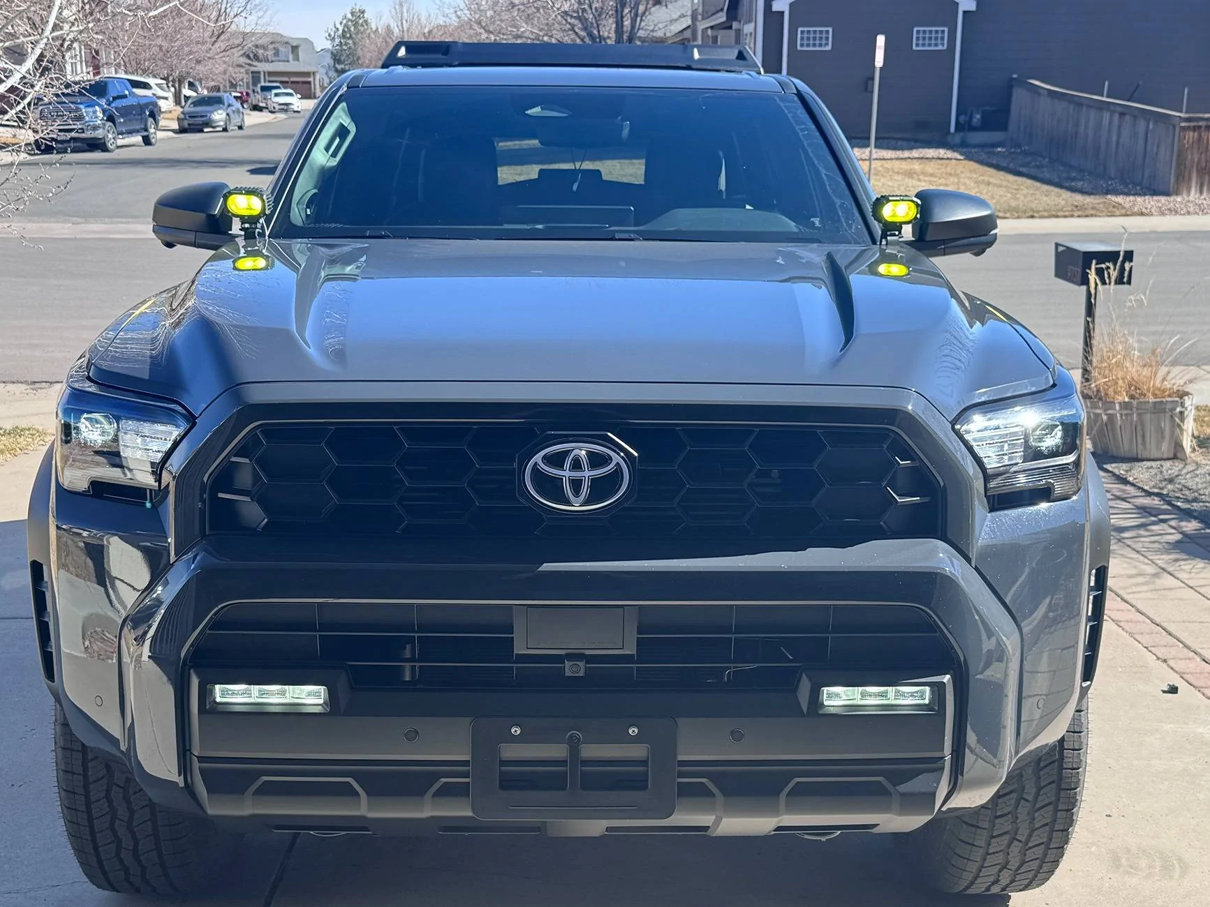

Any pics at night?
Where did you pick up the lights?
Which bracket did you use?
