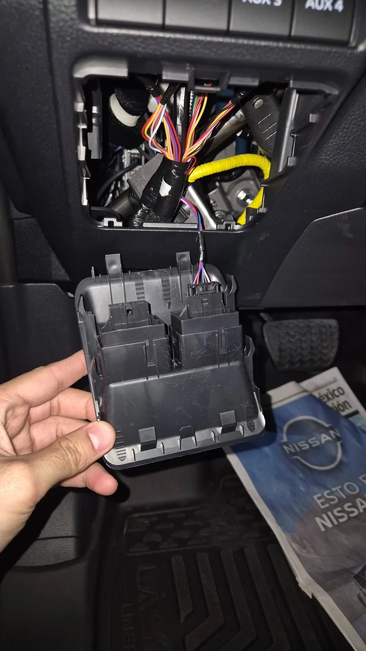

Anyone know what this connector is prepped for?

Installed cargo area lights and noticed some trims have a switch to control them — mine (Limited) didn't come with one (it's blank... No switch there).
Opened the trim panel and found a connector already there. Not sure if the switch is for the cargo lights or not. Has anyone done this retrofit before?
2025 2026 4runner 6th gen Anyone know what this connector is prepped for? 20260531_194206

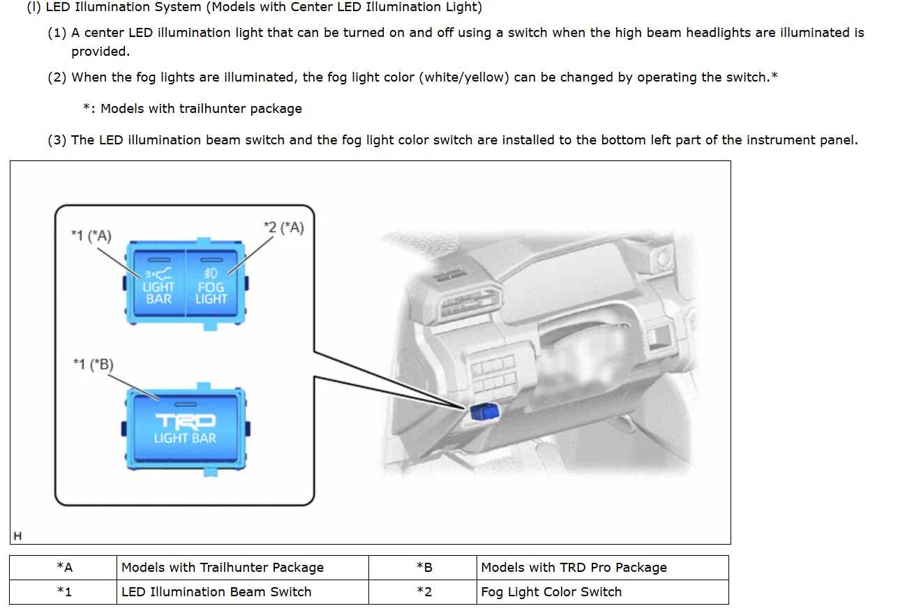

that is led illumination beam switch K79
it's for accessory lights like ditch lights
Instead of powering a component from the assembly line, this switch routes power to the vehicle’s factory pre-wired auxiliary pigtails. Depending on your exact trim level, these dead-end wires are typically located:
  • Behind the front grille/bumper area (for forward-facing light bars or fog kits).
  • Near the cowl/A-pillars (for ditch lights)

wait so you can a switch to that and power something or is it missing the other end?

So in theory if we had got those switches we could use factory wiring to run use that switch for a light bar? I don't remember seeing any wiring behind the bumper though.

if you find unused pigtails you may be able to use them
and it is hard to tell when and where they leave extras behind.
(unused copper costs a lot)
D pillar lights for example. pigtails exist on model w/o
D pillar lights, so just get the lights and fish out the pigtails.
I haven't checked my poor-mans SR5 for other unused wiring
so it may vary who gets unused pigtails for other trims
if you find an unused connector best bet is chase down the connector
type and color code in the TIS EWD before assuming you can use it, lest
you blow up the ECU or canbus system

the switch hardware might be in the location but if you didnt order the corresponding PIO, they sometimes dont install the associated wiring to enable that switch.
good example is the aux switches or the cargo area lights.
