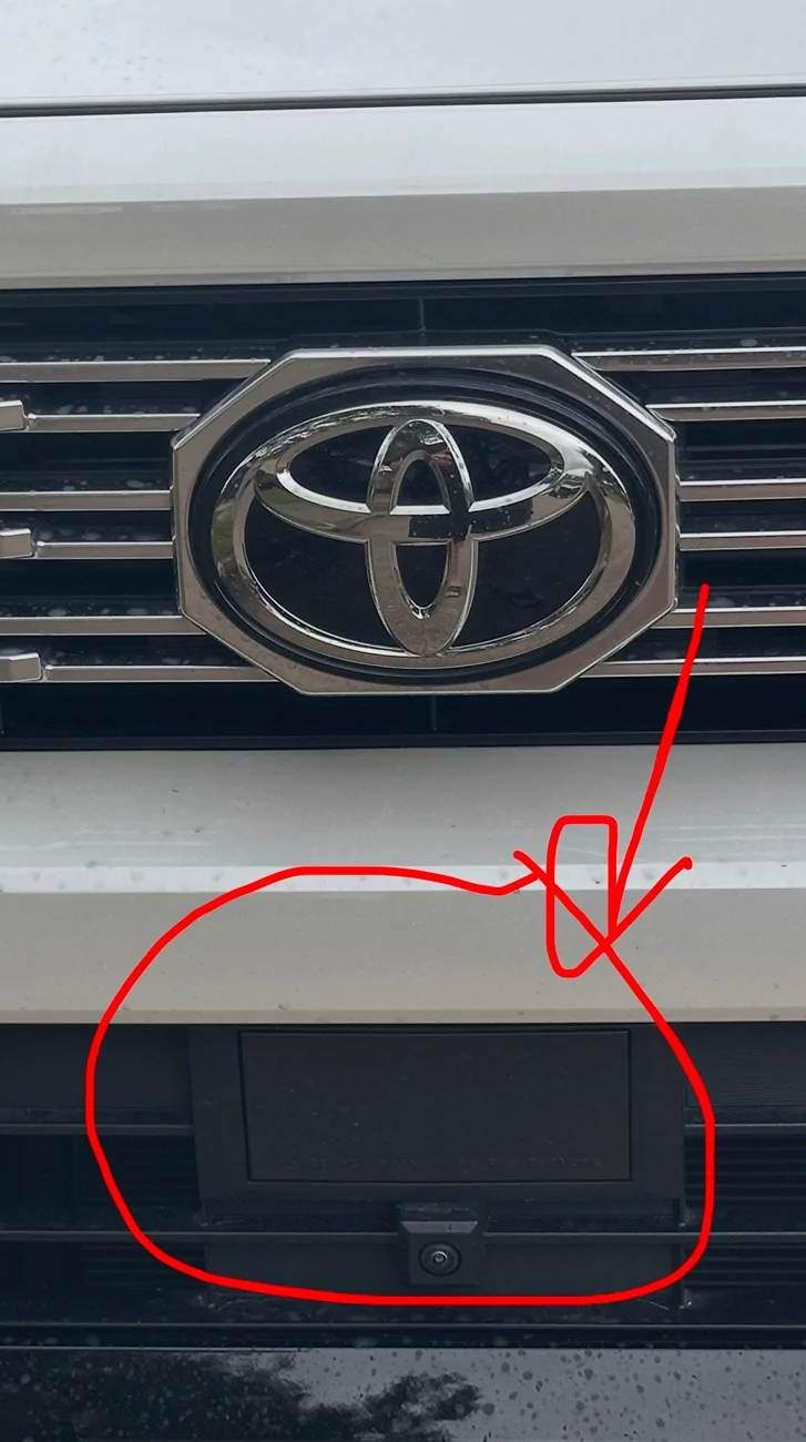

anybody know what goes in this space? front of 2025 limited

that is not a space, it is a radar assembly

They made StickerFab covers for them. I’ve seen some with the “4Runner” name across it.
It is a sensor though.

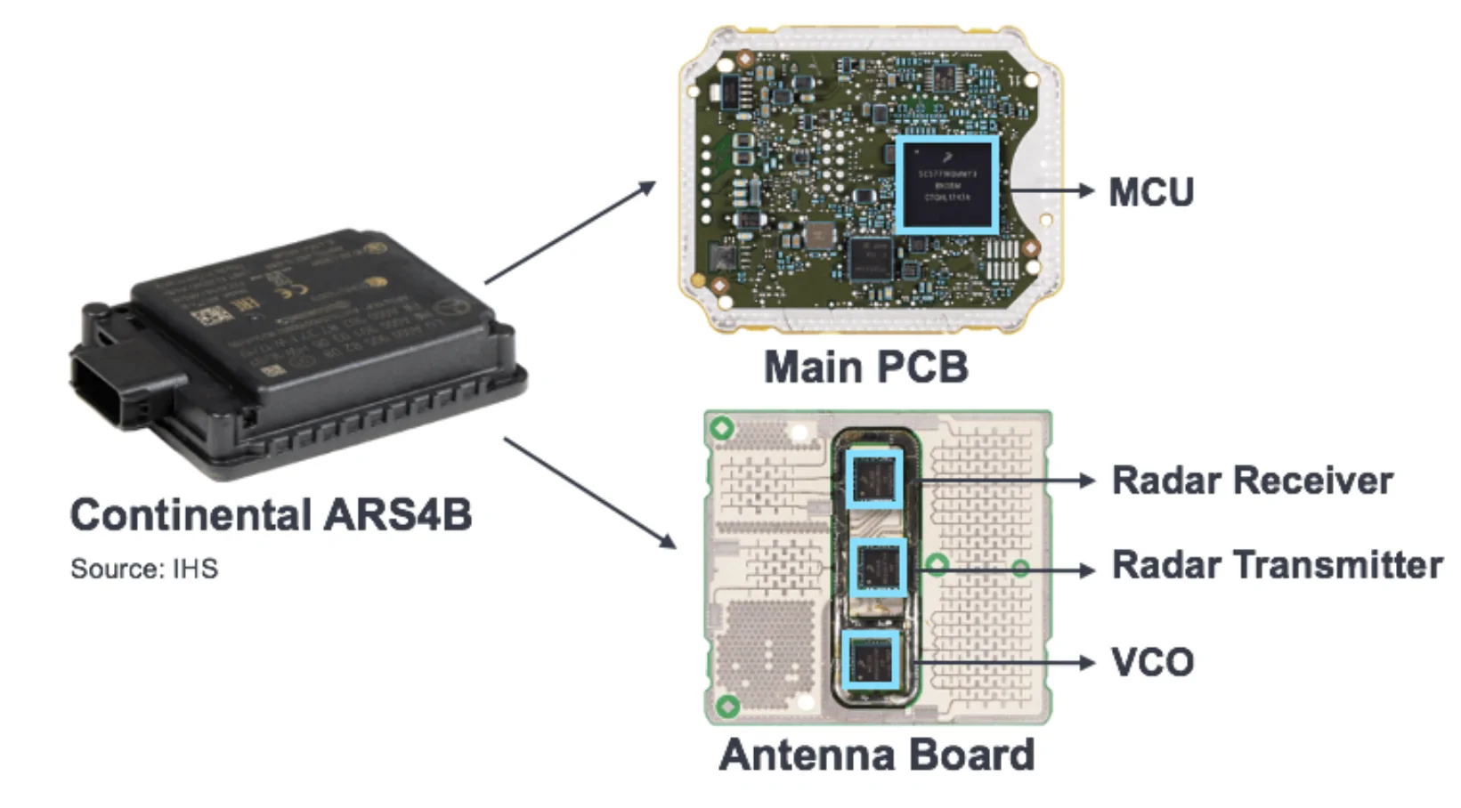

"Front Radar Sensor"...is that marketing-speak for antenna?
LOL
Long Range Radar
up to 530 meters
signal processing unit
modulator
phase locked solid state radar
transceiver
frequency converter
amplifier
control unit
...oh yeah... and an antenna
