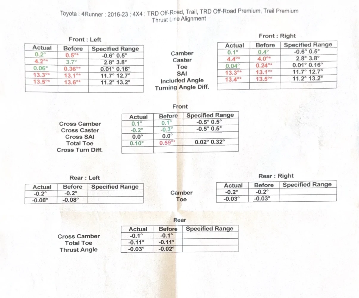

Remember, the old Gen 4runner and Tacoma have diff susp set up. The 2024 Tacoma and 2025 4runner have same set up, maybe just different shocks depending on trim level. The attachment posted is calibrations from the 5 Gen (Atari 2600 days, sorry couldn’t help it). I would just double check it.

Weird, Seems TOYOTA Dealership's don't have the correct alignment numbers for the 6th Gen either, looks like their using the 5th Gen 4R, not the new Tacoma's.
Here's my numbers before and after alignment with a 1" PEAK front top collar and 34"x11.5" (E) tires.
2025 4runner 6th gen Alignment numbers after lift on Pro with 1" PEAK top collar Alignment 09-19-25
