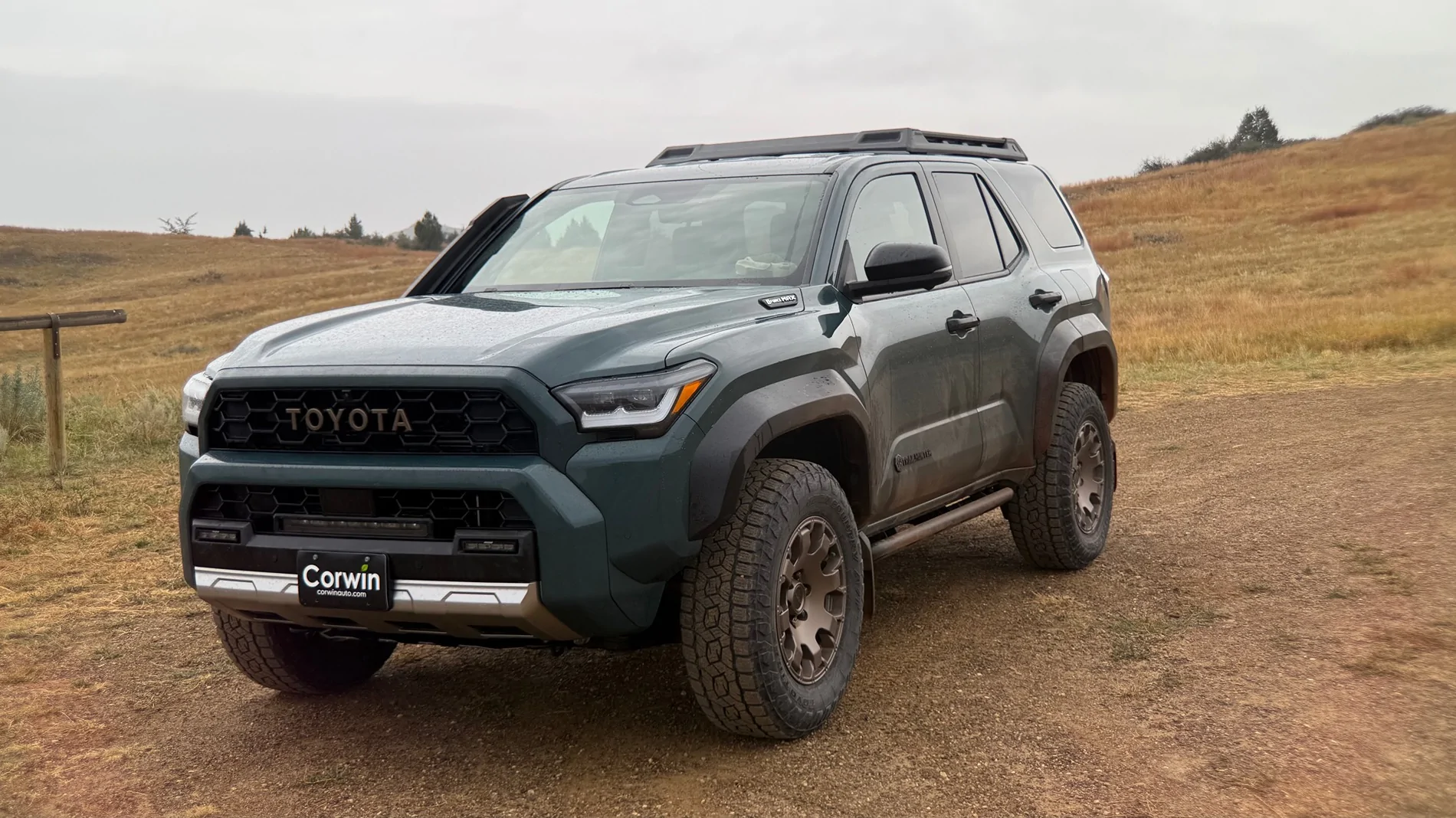

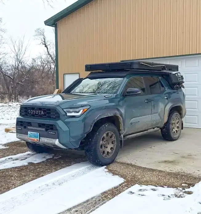

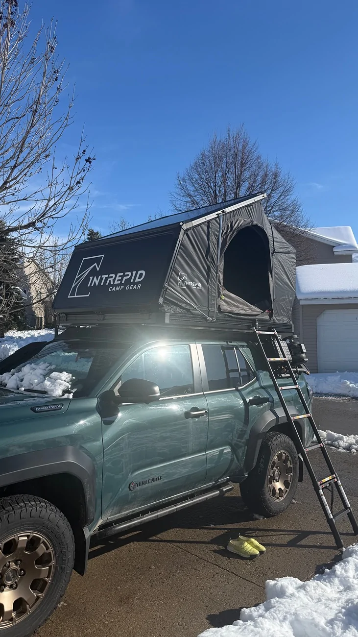

Hope everyone is doing well!

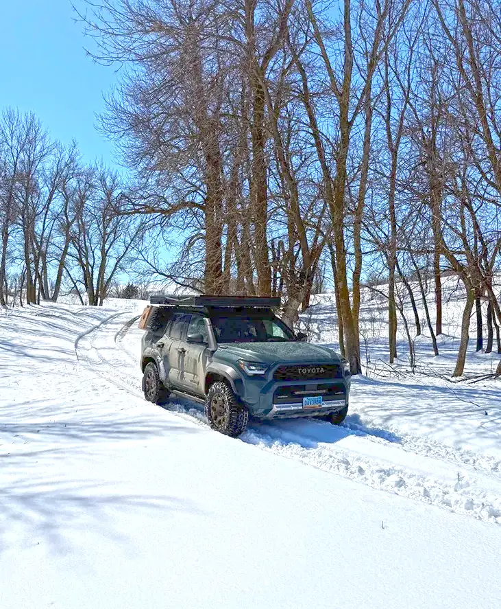

Just joined and figured I’d post the progress our 2025 Trailhunter has made since we got it. Purchased new in August 2025 with 3 miles it currently sits at just under 12,000 in April 2026. Our goal has been to use this vehicle to transport our family of 3 from ND to new places starting with our 4000+ mile “Push to the Pacific” road trip in June
Build includes:

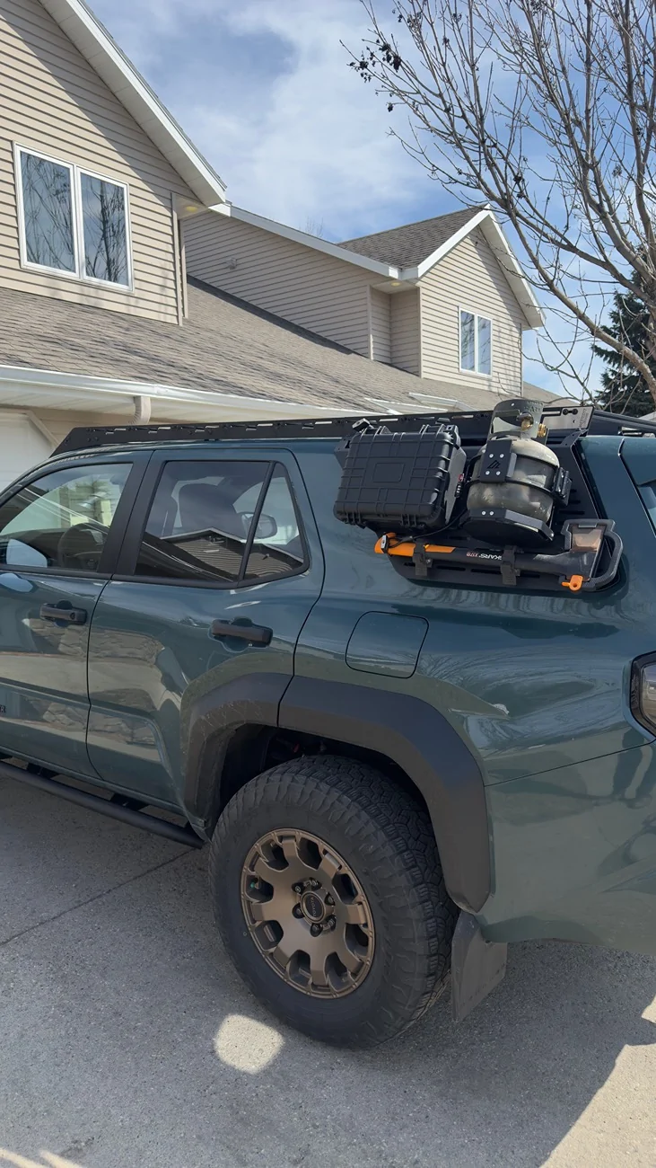

Westcott Designs Lo-Pro roof rack & molle panels

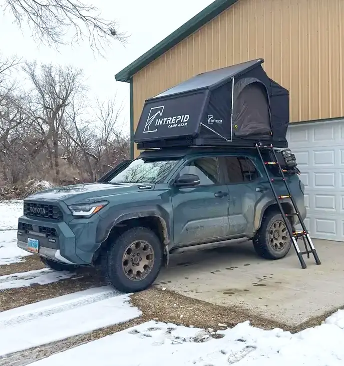

Intrepid Camp Gear Geo 3.0

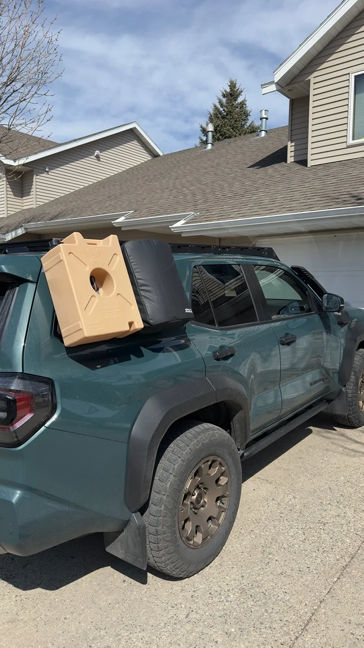

Joolca Hottap & Rotopax 5 Gal water tank for doing dishes or showers around camp
American Adventure Lab propane tank mount so we can carry a 5lb tank for our cooking essentials, waterheater, and fire can.
The Apache case for assorted tools that I like having quick access to and an axe for firewood or clearing trees on trails.
Mods I plan on doing in the future:
Westcott Designs Preload Collar lift kit. I already have the parts I’m just waiting on the Dobinson C59-821V rear springs I ordered to arrive so all the suspension upgrades can be done at the same time.
Expedition One Dual Swing Out rear bumper. This will be crucial to move the spare tire out from under the rear of the vehicle and add back some ground clearance, along with some real estate to add fuel cans.
CBI Covert front bumper so we can mount a winch.
What mods would you guys add?
My favorite feature on this vehicle has to be the ARB air compressor. Simple to use and can be paired with a Morrflate 4 tire inflation/deflation system. It makes airing up or down a breeze when out on the trail.

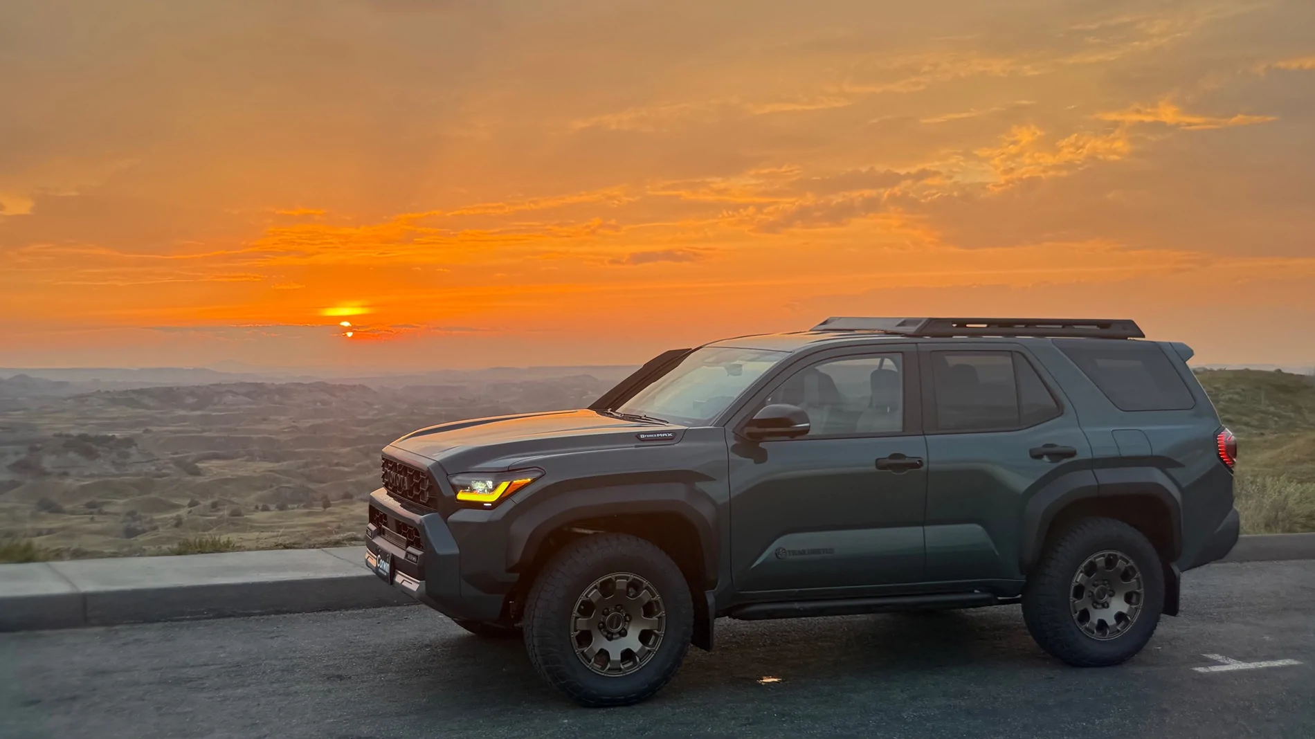

This vehicle has been great for us so far and I’m looking forward to getting it on some trails out west in the future. Where’s the coolest place you guys have taken your 6th Gen?
