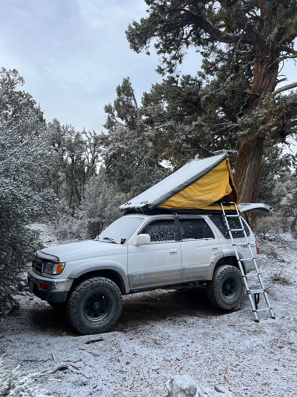

Build is trail ready! Now all that’s left is accessories like compressor, lights, dual battery, fridge.
It was hard to sell my 3rd gen but knowing pieces of it will live on this (and pay for it lol) makes me feel good.
