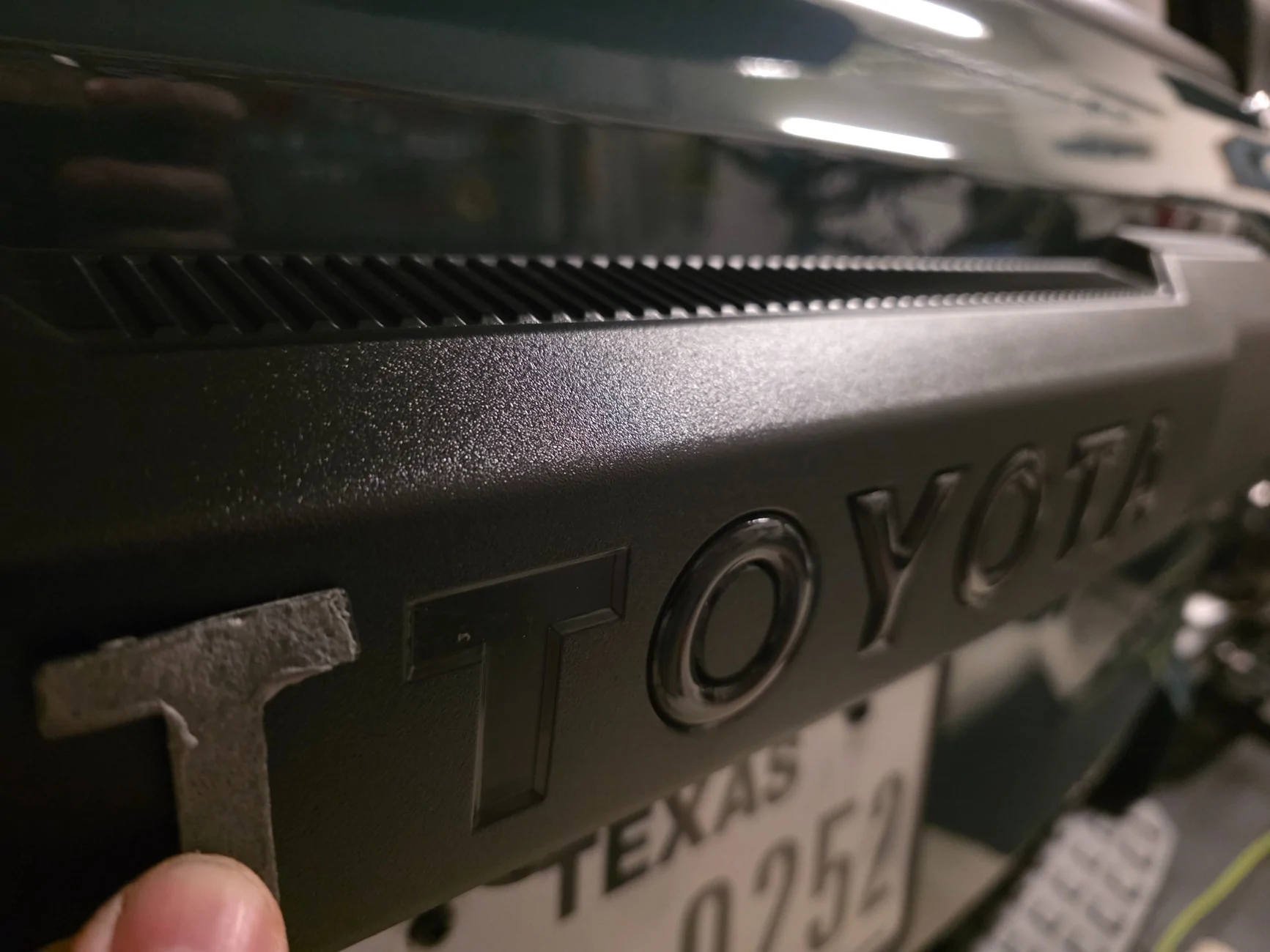

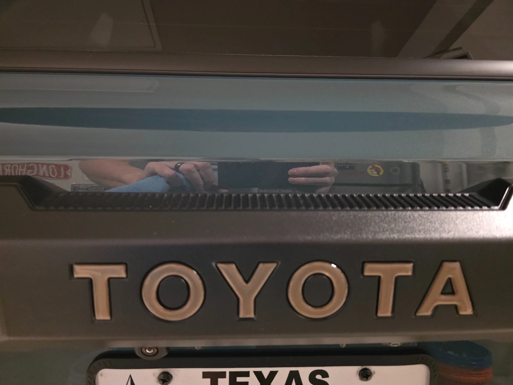

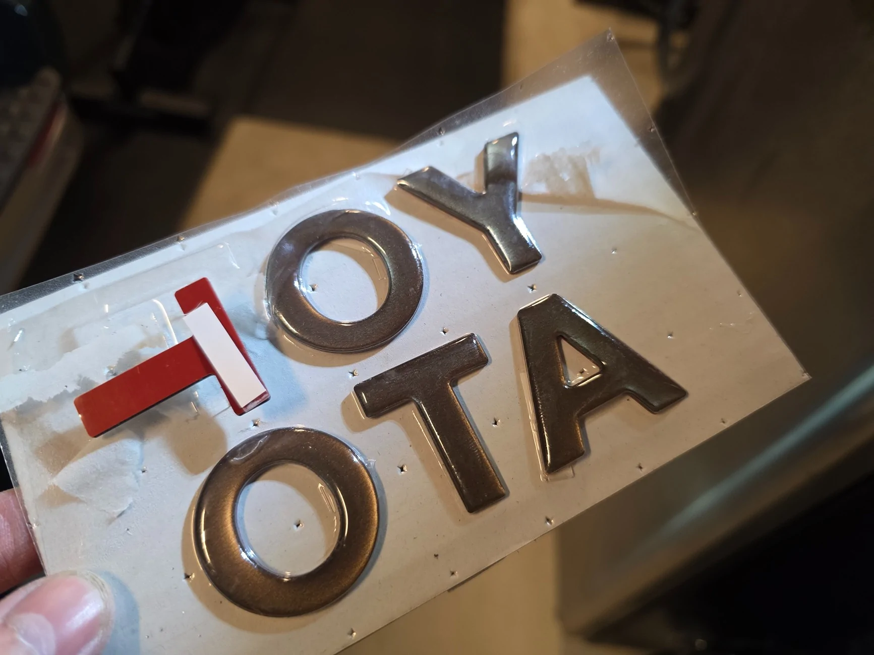

Used a hair dryer this time since I was worried my heat gun would get too hot for the plastic around the letters. As soon as I was able to lift with the plastic pry tool, I could grab with my hand and just pull it off. Worked the rest of the leftover goo with my finger. When I got all the letters off I hit the area inside each letter with some Goo Gone, and then finished with Isopropyl alcohol to dry it all out. Did one letter at a time and pulled the tabs partially off and set the top of the letter to get it straight and then laid it down pulling the rest of the backing off. If you are used to LEGO stickers, you'll be a pro. I think, just like the front, the bronze looks so much better.
