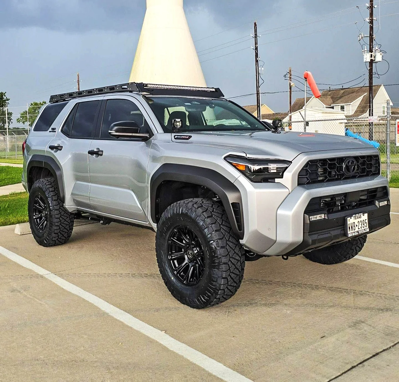

Good looking 2025 TRD Off-Road 6th Gen Build with:
Lift: 2.5" Ready lift
Roof rack: Victory 4x4
Ditch light: Hella Xtreme XT 3"
Wheel: Black Rhino Diamondbac 17x9 (+12 mm offset)
Tire: 285/75/17 Nitto Ridge Grappler
This build belongs to Dalton J. (not mine)
2025 2026 4runner 6th gen 2025 TRD ORP 6th gen with 2.5" Ready Lift, Victory 4x4 Roof Rack, Black Rhino Diamondbac +12 offset, 285/75/17 Nitto Ridge Grappler 2025 TRD ORP 6th gen with 2.5%22 Ready Lift, Victory 4x4 Roof Rack, Black Rhino Diamondbac +1

Nice! Does the spare fit underneath? If not, what are you doing for it?

2025 4Runner TRD Off-Road
Looks awesome!!! I am convinced that the +12 offset is perfect for this vehicle with a lift and stock fenders. I just switched from a +25 to the Black Rhino Rapids 17x9 +12
