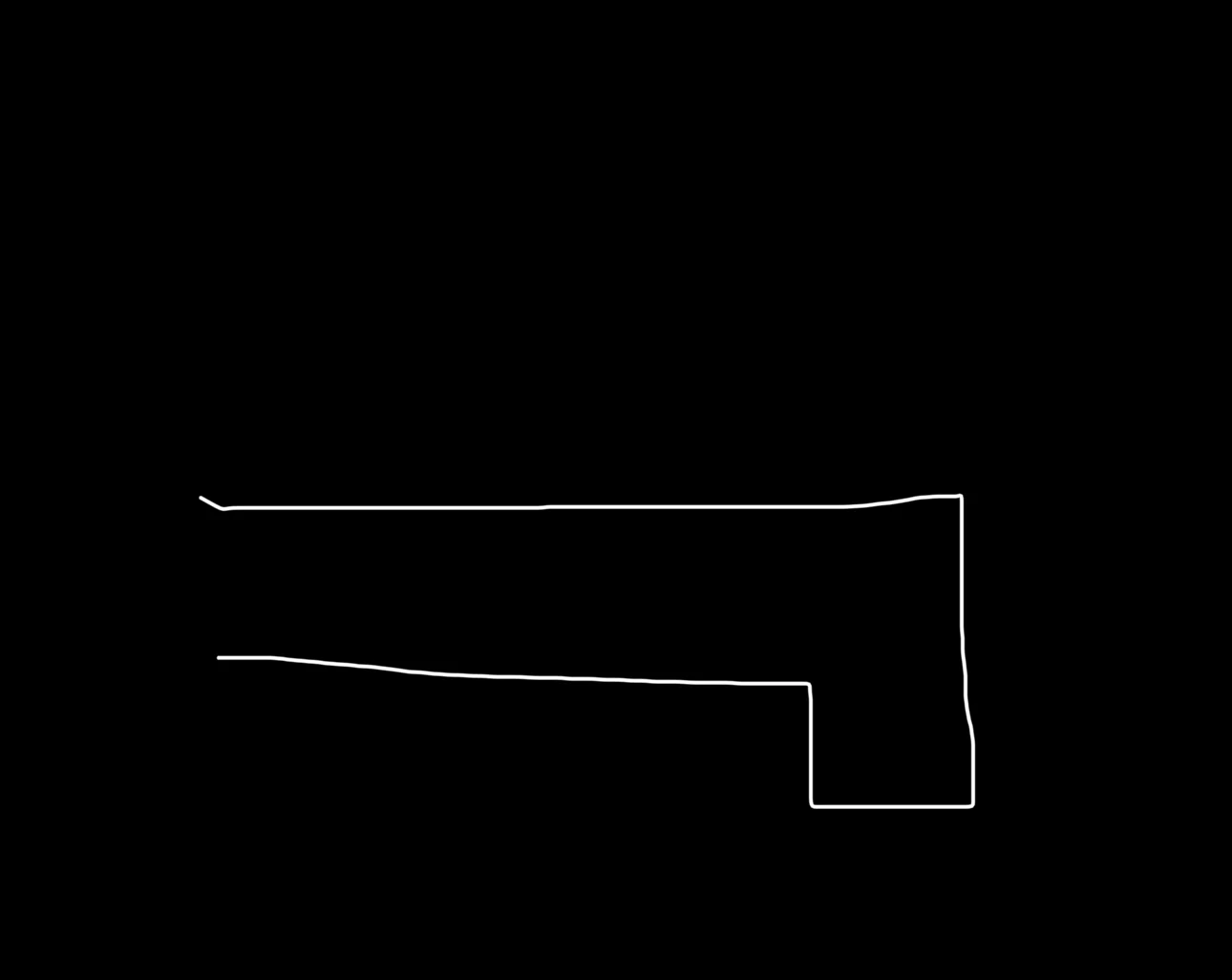

I'm waiting for a drawer company to utilize the small cargo space under the load floor on the hybrids. Make the front of the drawers deeper.
how would you expect that to work? I have been trying to brainstorm something that would utilize that space and nothing I can think of would work except a hatch style panel.
From the photos I have seen the area looks like its not evenly sloped, so a deeper section at the front of the drawer would lead to a drawer that does not open as far.

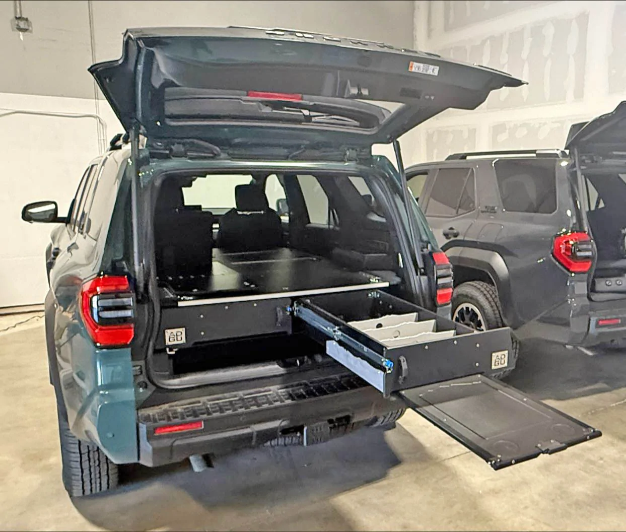

side view of a drawer
2025 2026 4runner 6th gen Bed Platform & Storage Drawer System by Air Down Gear Up - Preview IMG_0374
Sure, but if you look at the thread with photos I do not think that is really going to net much space. What I think will work is more of a raised platform that lifts on either side. If I ever get my truck I may go down that path and build something. Not raised too much, but just enough for a tool roll, jumper cables and maybe some back up first aid stuff.
It'll net 4 to 5'' of usable space I'd bet. That's quite a bit as far as i'm concerned. If the drawer box is aluminum and not wood, you'll only need 1/4'' to 1/2'' for materials.
I'd second wanting that extra bit of space, can't open that compartment lid with a drawer on top of it anyway and I'd rather not just leave it open.
I could also just see putting a hinged door under the drawers to close in the compartment keeping it full width, would be nice to access camp lights or recovery gear quickly.
