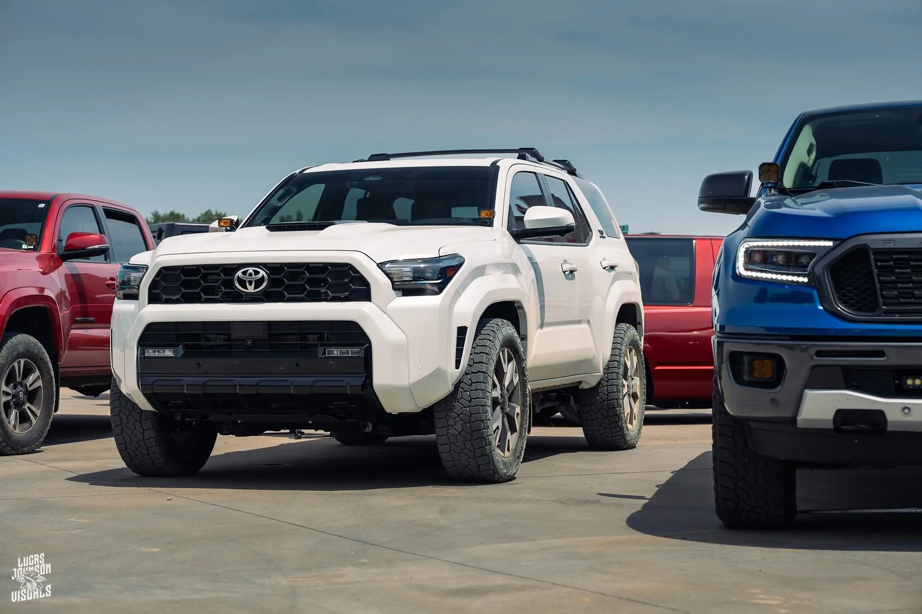

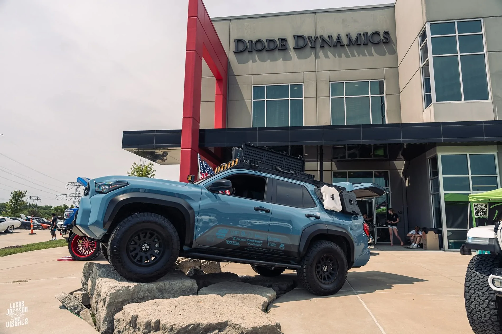

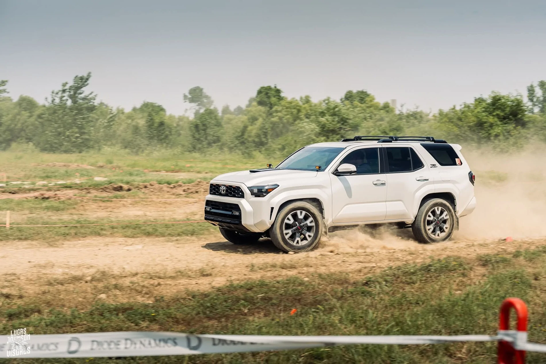

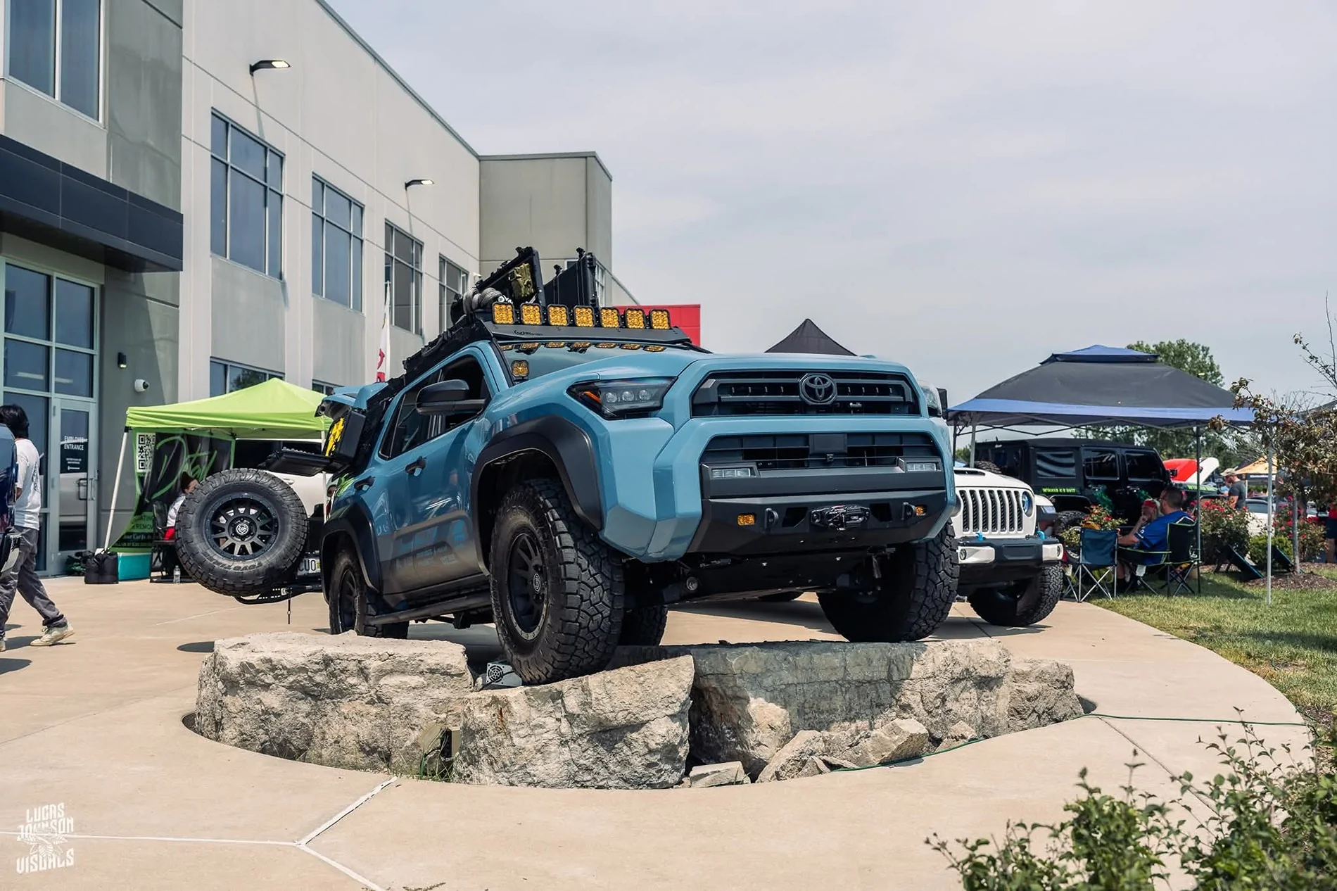

Had the pleasure to be a featured vehicle in the annual @Diode Dynamics car show and open house this past weekend. Took my 6th gen around the rally course a few times and had a blast!
@ryno was posted up front and center at the show entrance to show off his build as well. If you're near the STL MO area, definitely worth checking out next year. They've got a great scratch and dent garage sale.

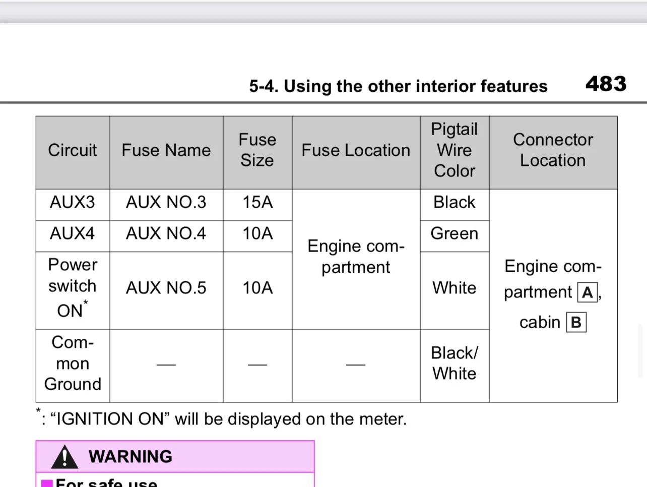

Do you happen to have the Pre-wired Aux Switches? I was wanting to do the same with my backlights. I haven't fully explored it yet but this caught my eye in the manual - there is a 5th "Aux slot" that is part of the "Power Switch ON Circuit", so my hope is that the white wire on the "A" aux pigtail will do the trick. Was going to give it a try when I get my lights and see if that is how it actually works:
