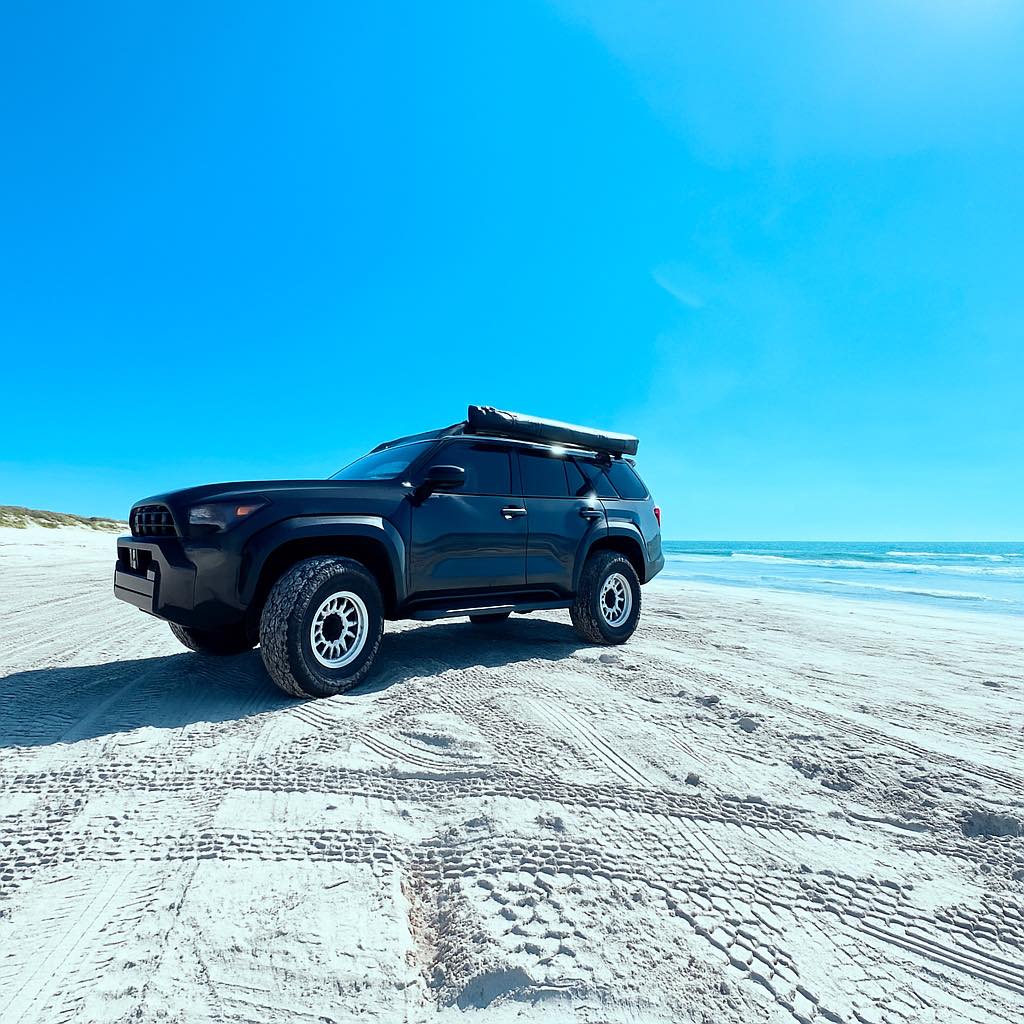

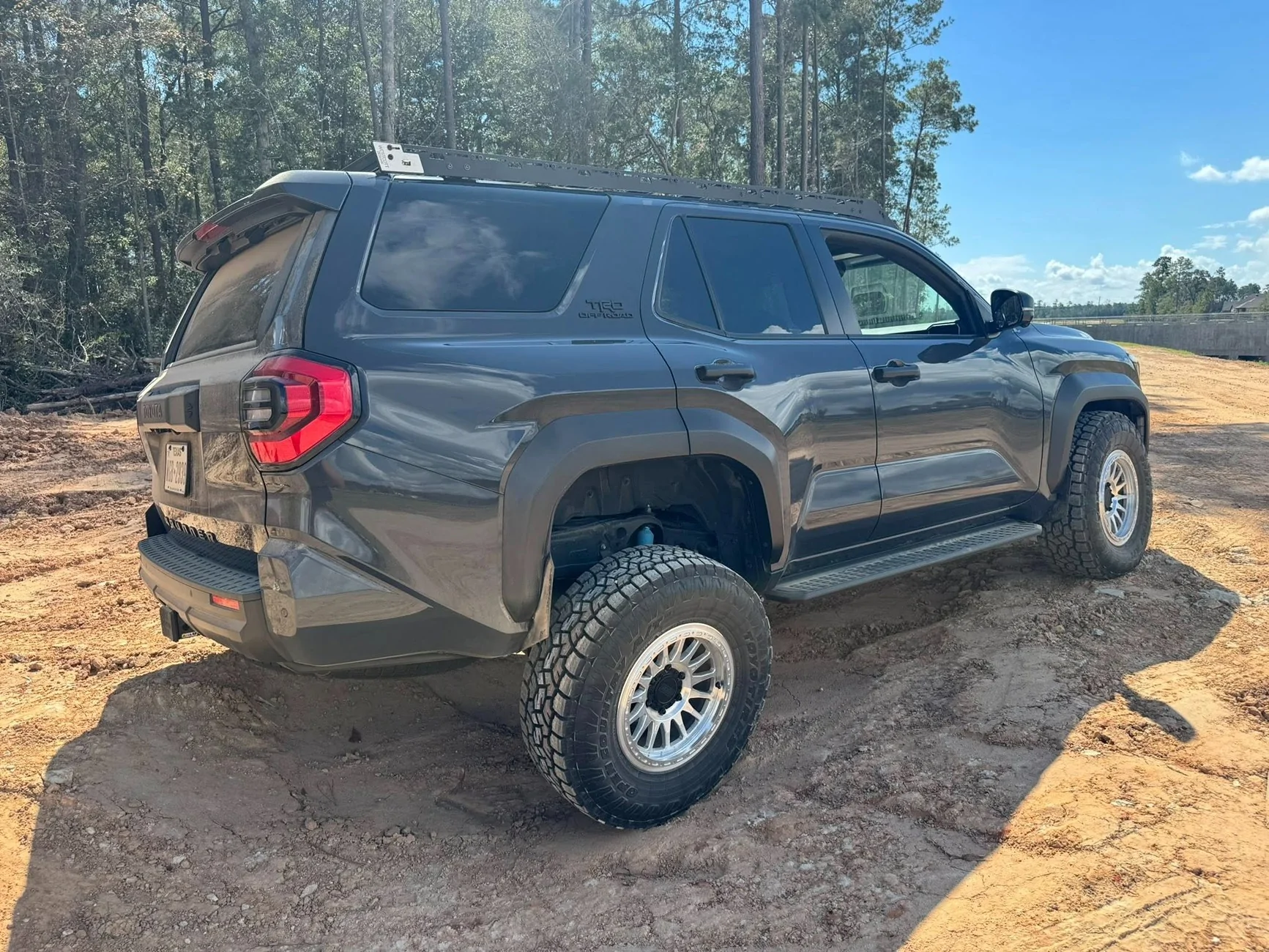

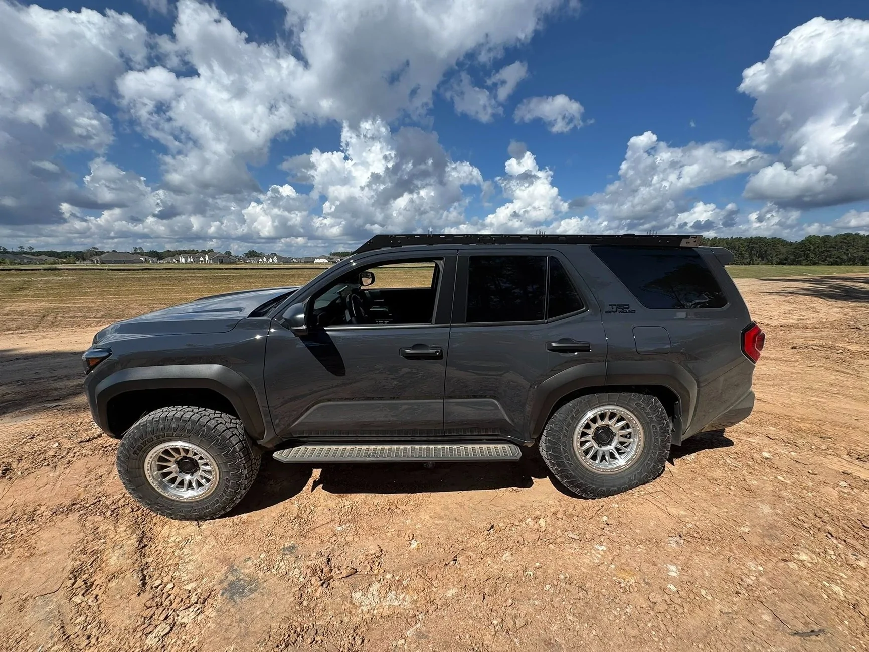

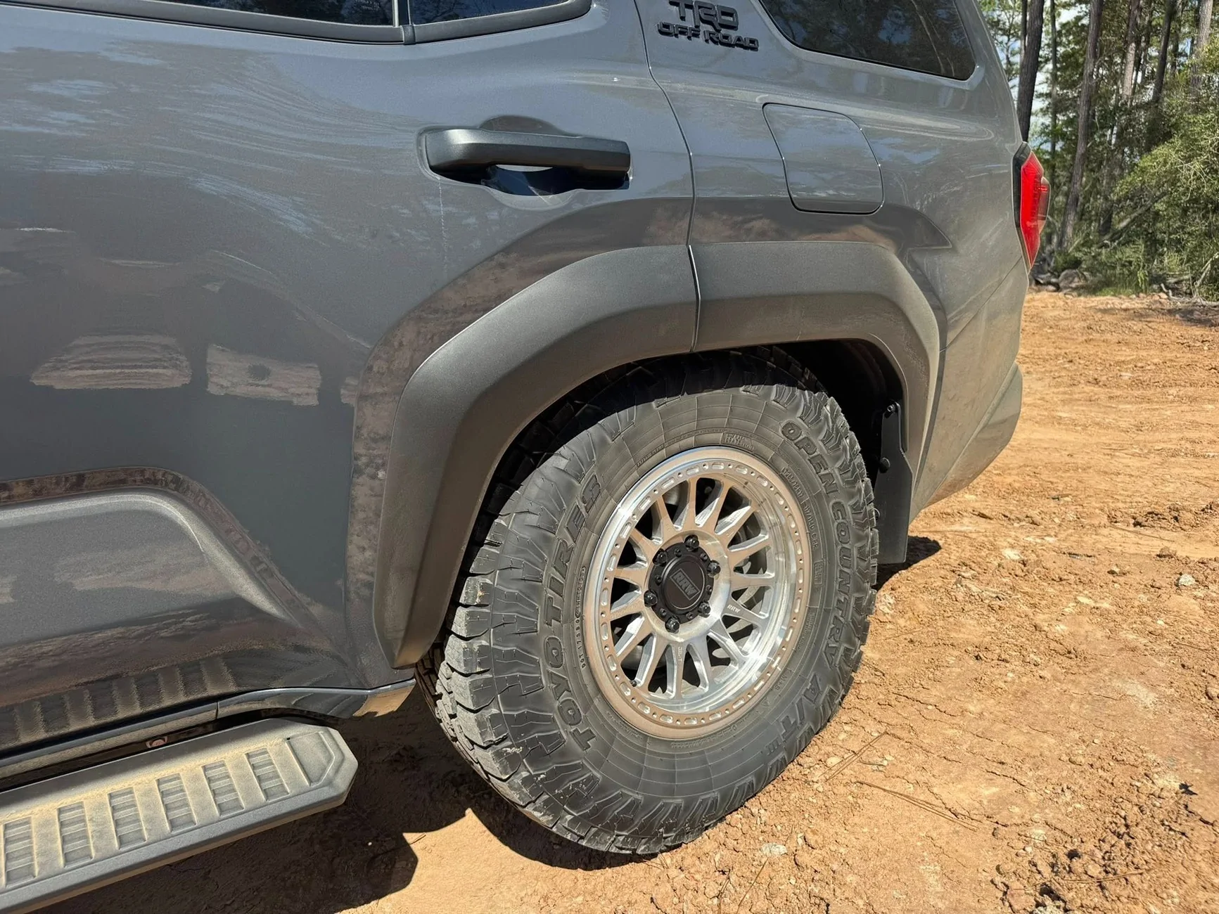

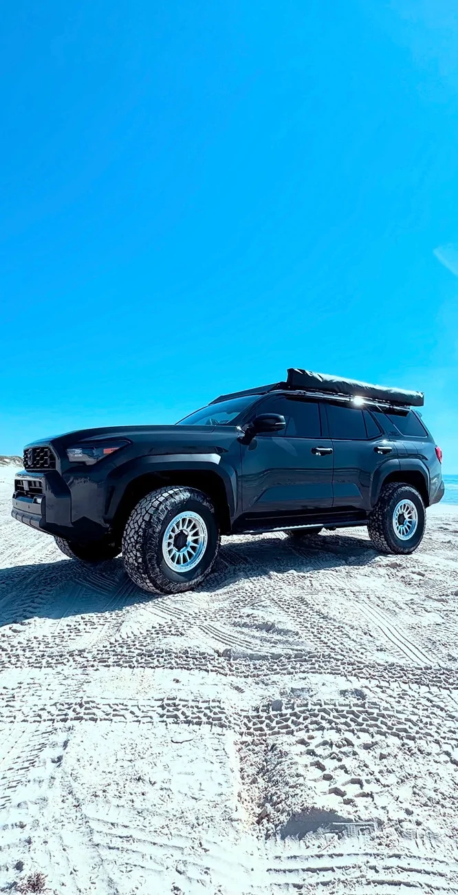

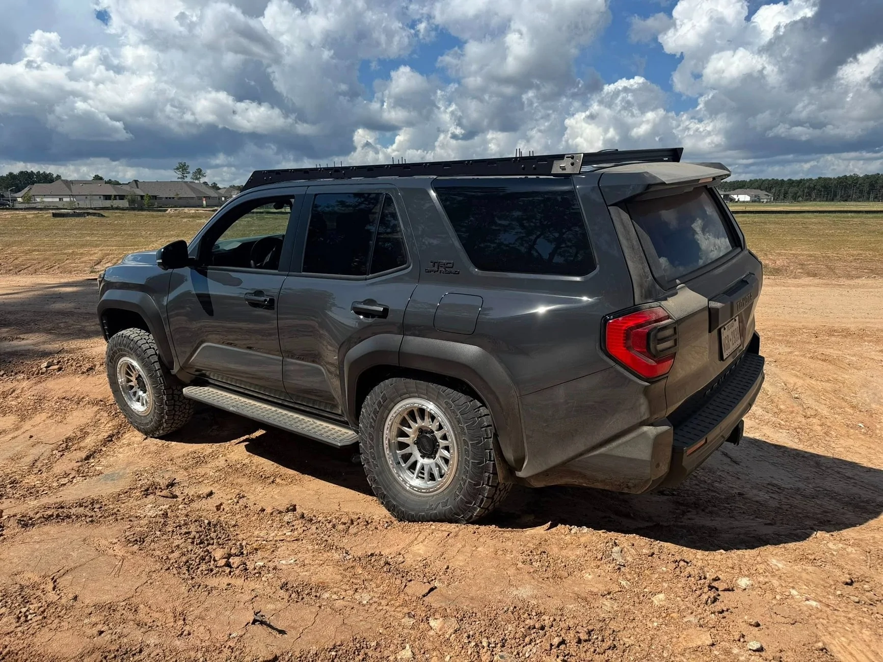

2025 2026 4runner 6th gen 2025 4runner ORP Build (before & after lift) -- Open Country 285/75/17 + RRW Wheels +25mm Offset IMG_2307
2025 2026 4runner 6th gen 2025 4runner ORP Build (before & after lift) -- Open Country 285/75/17 + RRW Wheels +25mm Offset IMG_2310
2025 2026 4runner 6th gen 2025 4runner ORP Build (before & after lift) -- Open Country 285/75/17 + RRW Wheels +25mm Offset IMG_2306
2025 2026 4runner 6th gen 2025 4runner ORP Build (before & after lift) -- Open Country 285/75/17 + RRW Wheels +25mm Offset IMG_2309
2025 2026 4runner 6th gen 2025 4runner ORP Build (before & after lift) -- Open Country 285/75/17 + RRW Wheels +25mm Offset IMG_2308
After Westcott lift kit installed:

It looks amazing. Did u have to remove anything to fit the wheels.
Claw832
Jul 9, 2025
Houston
2025 4runner
Only removed mud flaps. The brackets behind the front tires are still on. Doesn’t rub but is very close. Plan to take them off soon

Looking great ! ?
Did you NEED TO because you ran these on stock suspension, or these mods are required even with the Westcott kit ?
Got same tires on similarly speced rims coming in for my incoming TRD ORP, and was under the impression I wouldn’t need to.

I just took them off because I ordered the ARK micro flaps and plan to put them on today

Are you telling us that these tires and wheels fit, and the mudflaps can stay on?
