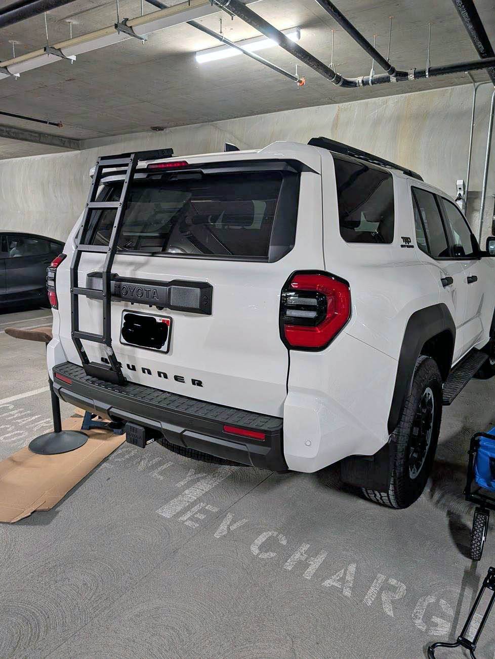

Finally got around to adding the first mods for the 4runner.

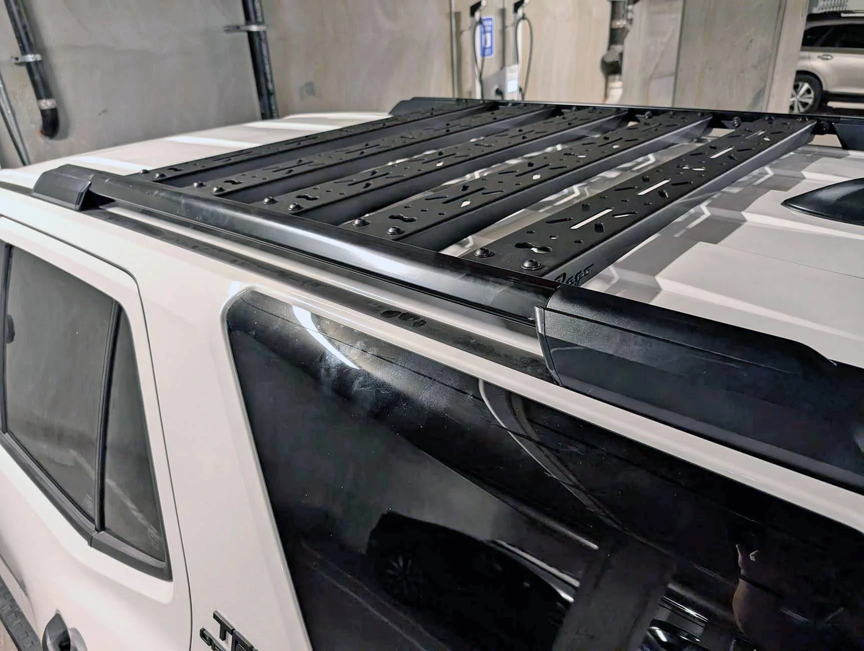

Went with the Rago Fabrication Crossbars since I liked their low profile look and the Prinsu ladder. Both feel really sturdy and there's no rattling or whistling from the crossbars. Haven't had a chance to load gear onto the roof yet!
The ladder does show up in the rear view camera and blocks a part of the image when the backup cam stitches the images together but doesn't affect the safety sensors. It'll just take some getting used to
Drilling into the crossbars was the biggest challenge, the metal was tougher than I anticipated and it probably took longer than it should have w/ a cordless drill

How was the ladder install? Did you have to drill holes?
The ladder install was relatively easy, this was the no drill version. They say it takes 30mins, took me closer to an hour

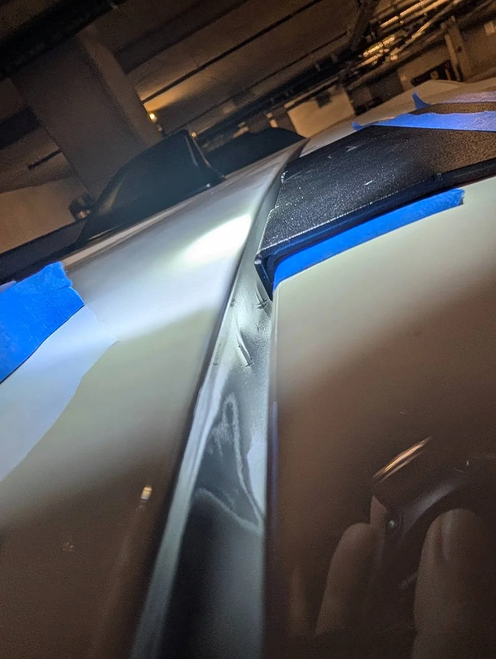

I did accidentally scrape some paint off when I tried to place the hook plate as far left as I could. But I moved it a few more inches to the right and it cleared it fine. Since it's in a spot no one will see, I plan on just putting some touch up paint to protect the metal
I was initially worried about the stress on the spoiler since it is plastic but so far it seems pretty sturdy. I tried pulling on it in different directions and everything held.

Does the sharkfin stick higher than the rack? How much fun was the install?
The sharkfin does stick up higher up by about 2 inches.
Install was not very fun lol but I would do it again. For me, the worst part was the drilling but the rest is fairly straightforward
If you have a another set of hands and some blankets you'll be able to maneuver the crossbars in place safely

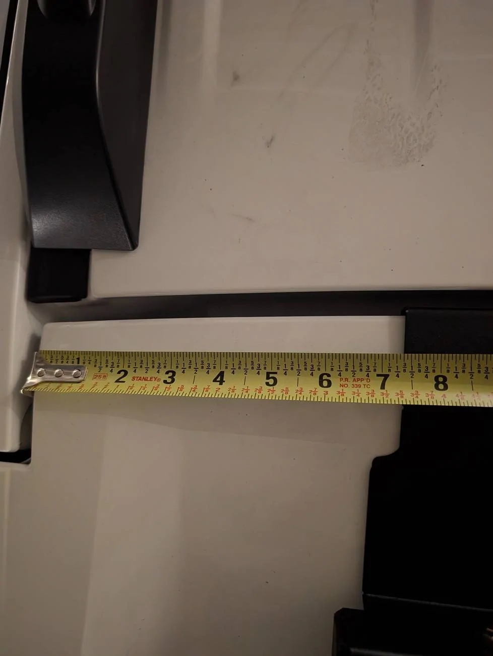

Here's a reference pic w/ a measurement for ladder placement

I will add to this. The install of the Rago Fabrication crossbar is NOT easy. I initially thought they would utilize the fact that the oem rails had guided holes and it would help align easier, but they just make you rivet into their own 1/4 thread holes that you also have to drill. And like the previous person stated, drilling through the front and back ends of the rail are not ideal. We broke a bit inside which made matters worse, but after overcoming that, those points are just aluminum bricks through and through. I even considered welding these points as I don’t think it is a great way to mount.
The pro is that they are sick! I will not lie. I think it makes the 4runner look better, and functionally it allows me to still park in my garage. I also have the side panels which follow the riveted holes, unsure if I want to constantly keep them on as it does seem like a lot of weight on the glass if I start mounting things to it (first time utilizing side panels so unsure of how much these windows can take)
