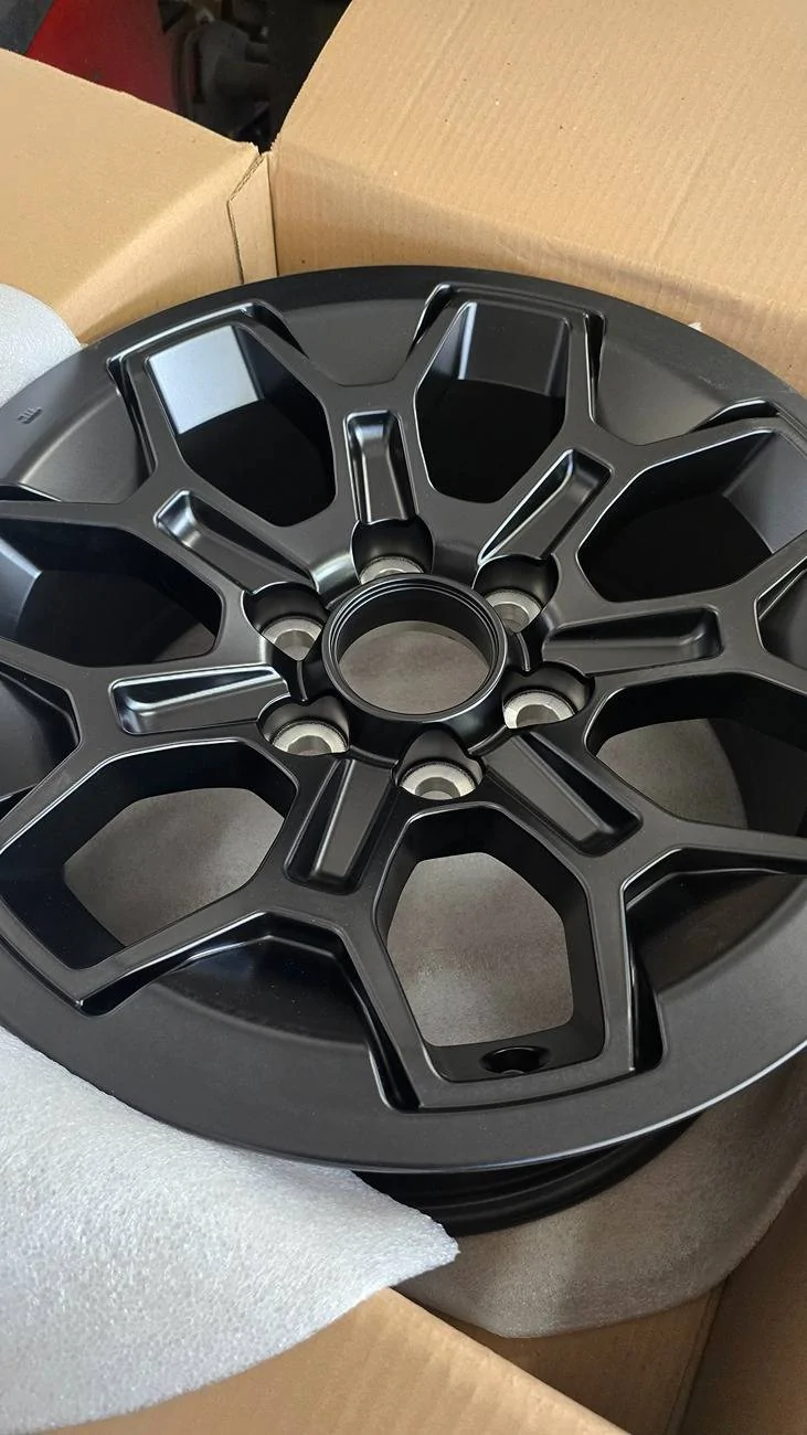

Just posting here the TRD Pro wheels part numbers and what you need to install. You would need valve stem kits and center caps since wheels do not come with them.
The Tacoma valve stems are different part numbers but are same when visually looking at them. They work and are way cheaper than the 4runner part numbers.
Center caps from various wheels can fit depending on the look that you want. Most are also cheaper than the TRD Pro ones.

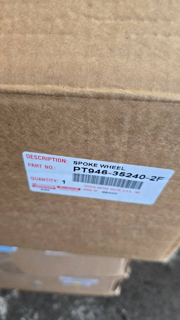

PT946-35240-2F are the TRD Pro Wheels part number

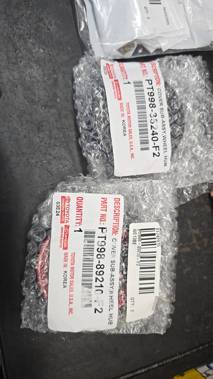

PT998-89210-F2 is TRD Pro Caps

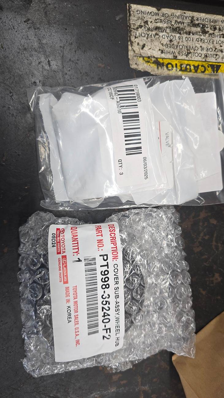

PT998-35240-F2 is caps from TRD off road
90942-A5010 is valve stem kits. NO SENSORS.

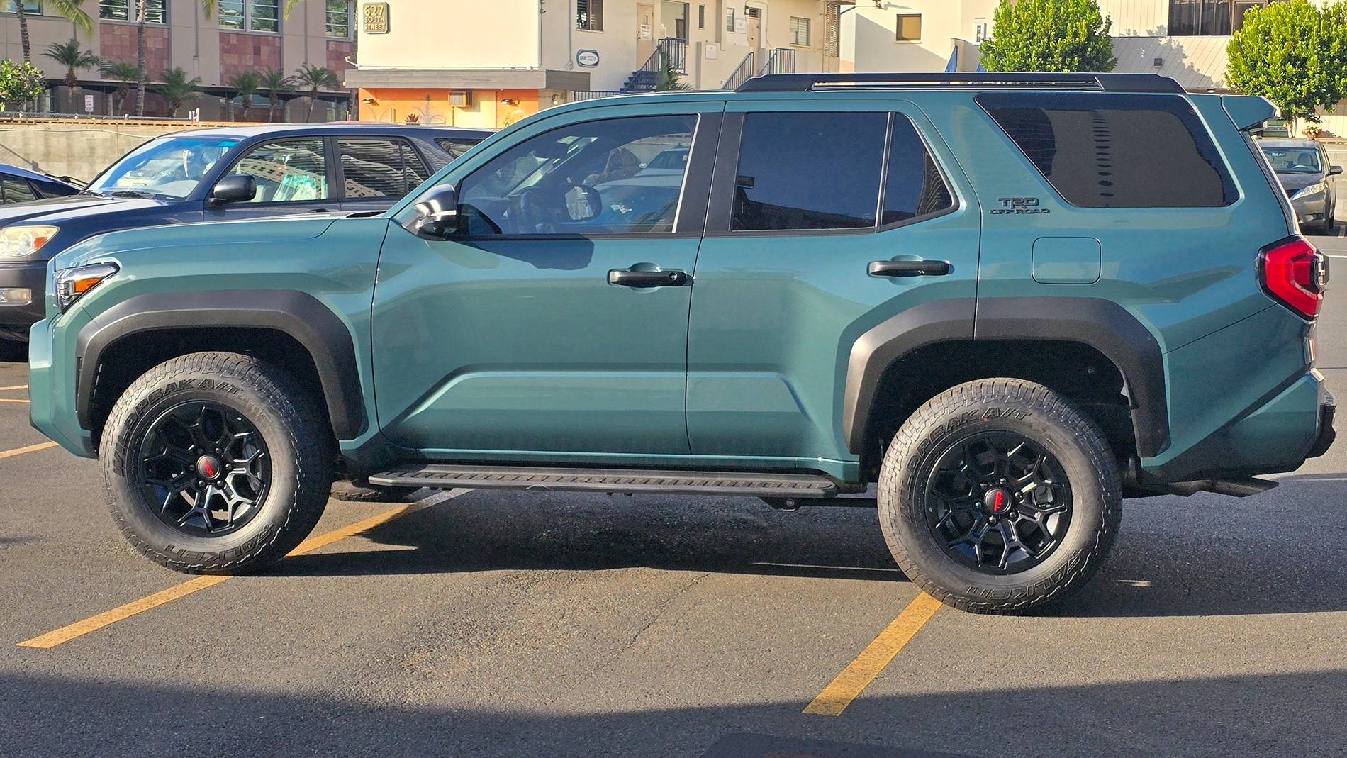

With Non TRD Pro caps.

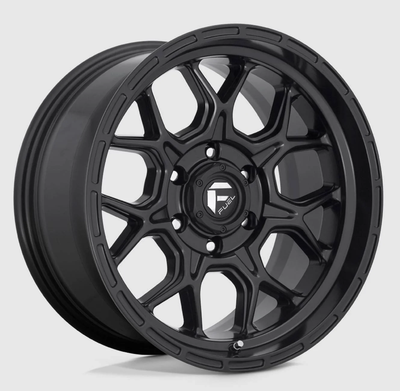

FWIW, I did come across this wheel from Fuel (called the "Tech") that looks very similar to the TRD Pro wheel:
2025 2026 4runner 6th gen Part numbers for TRD PRO wheels, valve stem kit, center caps. Various center caps fit depending on the look you want. Fuel Tech wheel D67018908457 (D670 Tech) 2025 4runner
(The part number for the 4runner is I think D67018908457)
The wheel costs more at $353 (it's 18x9, 20mm offset), but maybe the all-in price to have the wheel swap done at Discount Tire is similar or even lower if there's no shipping charge.

Please do not buy junk wheels like Fuel. Sure, they look good, but they're trash. Please don't Fuels on a Toyota.
