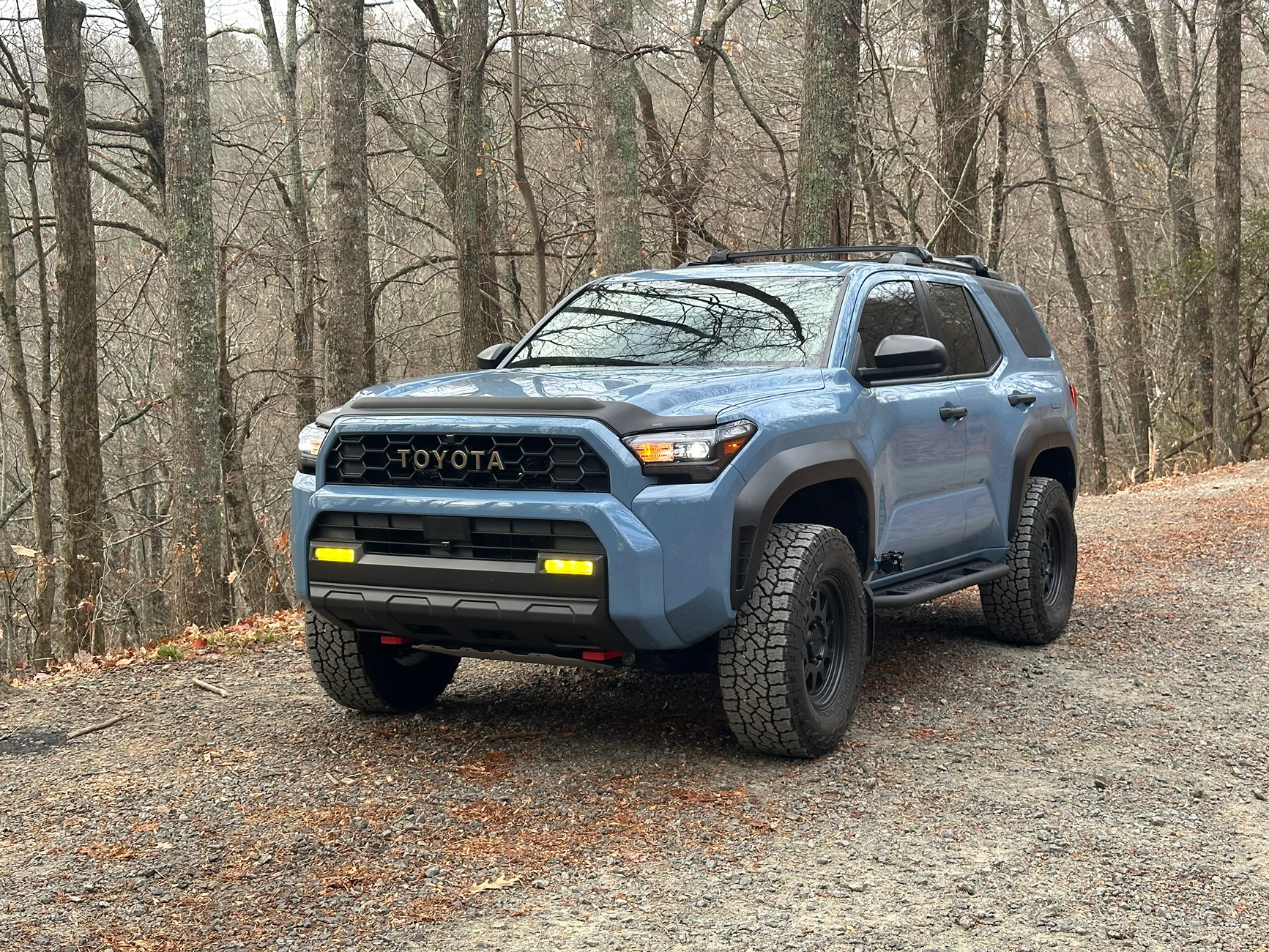

828findadventure
Apr 30, 2025
317
262
North Carolina
Tacoma & Tundra
Westcott 2.5"/.75" +25 offset 17" Methods with 275/70/17 Falkens.

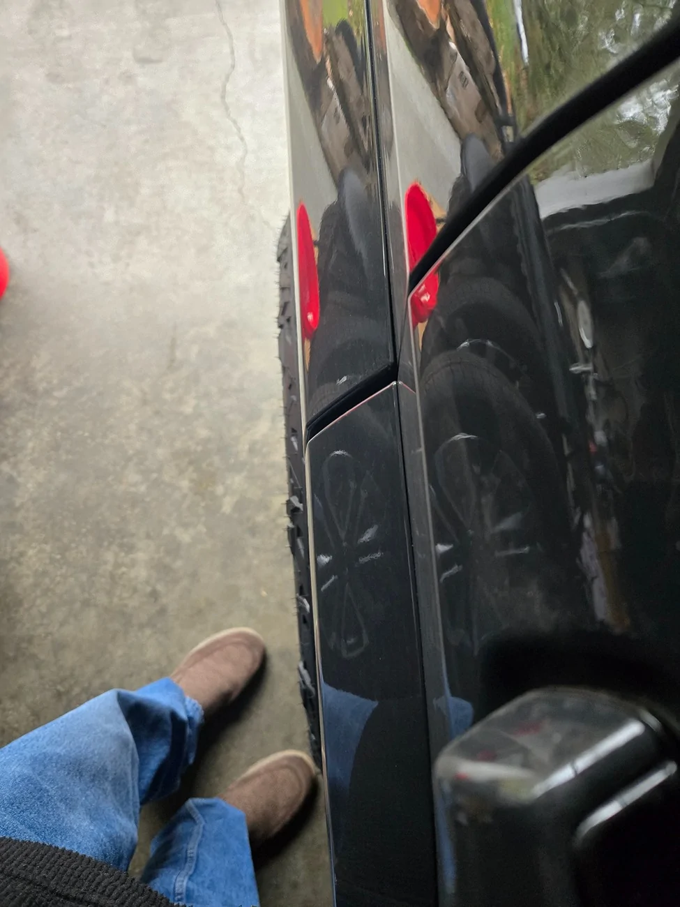

808runner
Tom
Aug 1, 2025
Washington
2025 4runner Limited, 2025 Tundra Limited
Running 285/70r17 with Icon +25. Rear pokes about 1/2" and front a little more (yes front pokes more). I only put a 1" level and wife wanted to keep mudflaps, so had to cut some of the fat portion up front to clear. You are putting a 75, but with more lift, so it "might" clear? I previously had 285/60r20 KO2'S on Raceline +15 and that poked 1" on rear and 1-1/2" up front and had to remove front mudflaps. I changed it because that setup was 30# heavier per corner. My current setup with Mickey Thompson Baja Boss AT weighs same as stock 265/55r20.
