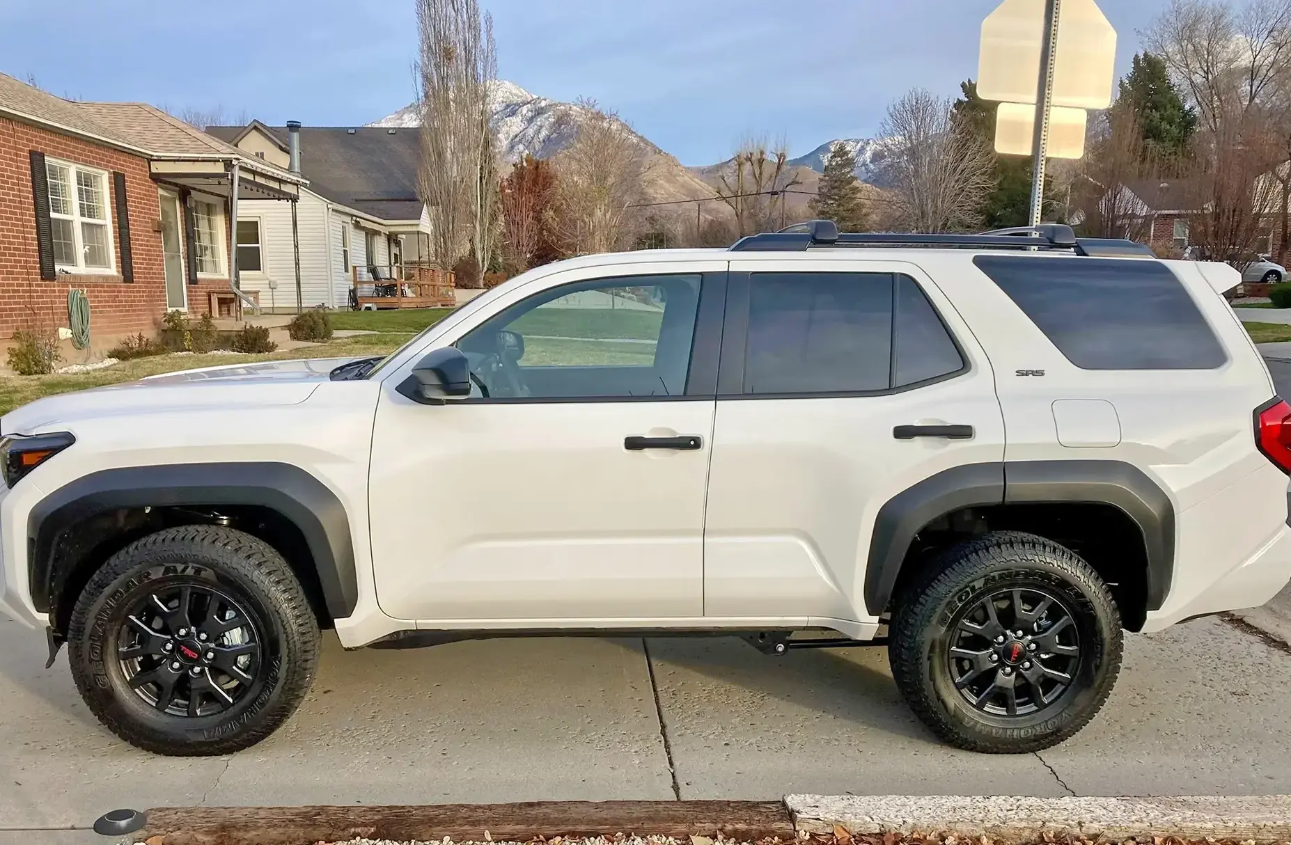

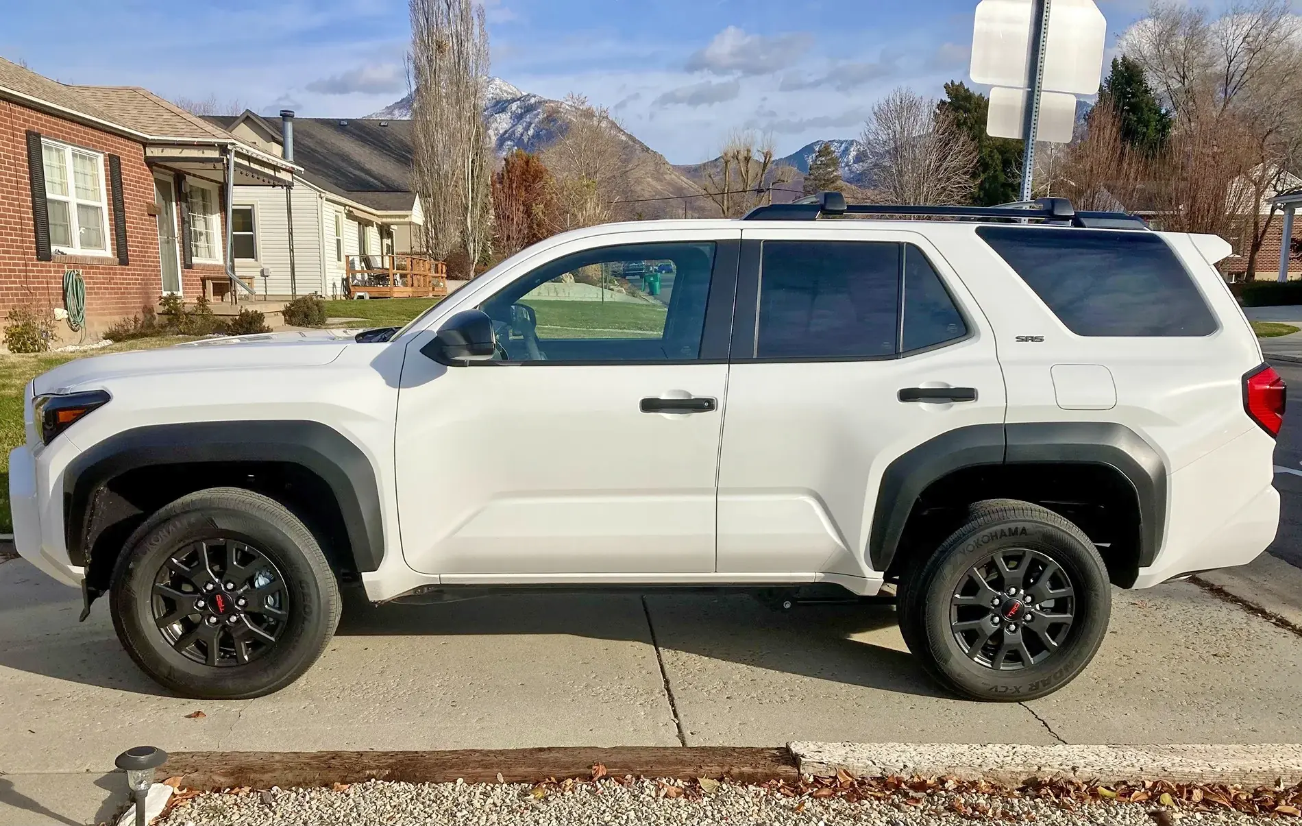

Posting these as I couldn't find much about the look upgrading from stock SR5 tires to 255/75r17 and really wanted the pizza cutters versus the equivalent 275/70r17 or the bigger 285/70r17. I like how it fits the wheel well better rather than the car tires that came on it.
Ended up with a steal on at discount tire on SL rated Yokohama Geolandar AT G015. Serves my purposes well for road driving, gravel, and most important snow/ice.
Also upgraded the donut spare with an OEM steel rim 17x7 (part number: 42611-35720 ) Which is the correct hub, bore, and nut size for the SR5.
MPG difference is TBD
