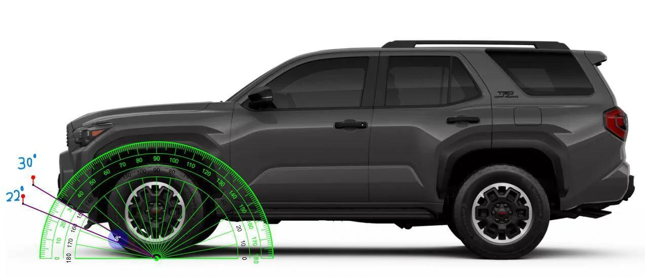

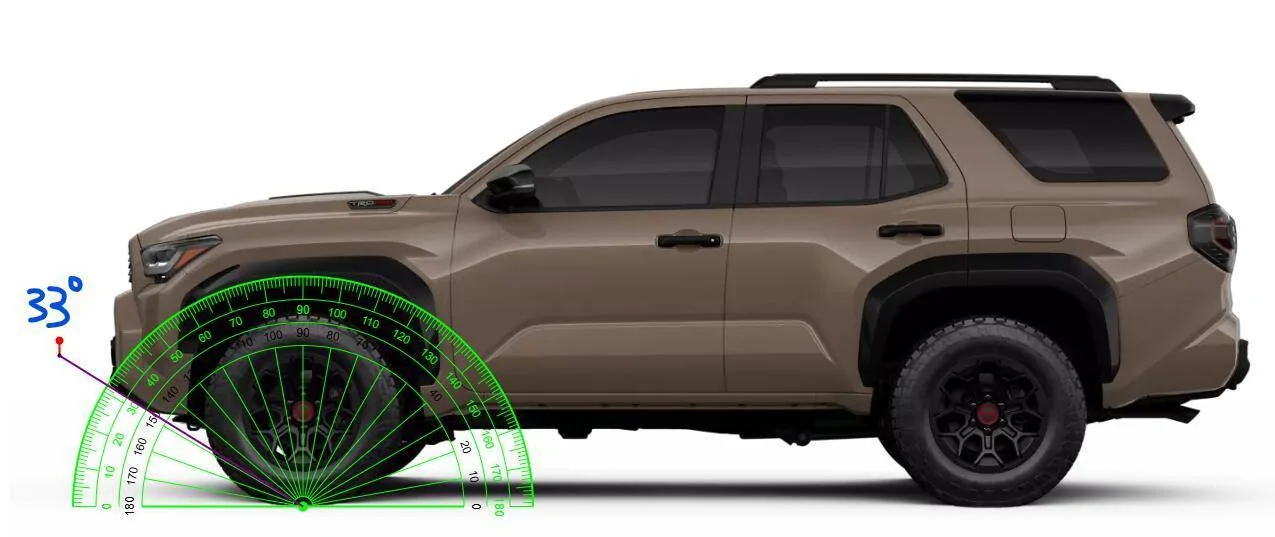

Removing air dam from the TRD Off-Road should improve ground clearance about 1" which basically matches the TRD Pro (which has 10.1" inch ground clearance).
That comes from this helpful discussions about ground clearance and approach/departure angles:
Thread: Ground Clearance, Approach Angle, Departure Angle, Breakover Angle
@andim: Looks like ripping off the air dam brings the TRD off-road to almost the same ground clearance and approach angle. Not perfect but certainly good enough.
@samyota: I measured it as in the picture.
- With air dam, it gets ~22°, which is slightly greater than official 19°. Given that we'll air down when "offroading" where the approach angle really matters, it will possibly drop from 22 to 19° in reality.
- W/O air dam, it gets ~30°, which is 3° smaller than TRD PRO. I presume it's because of the higher ground clearance on the PRO.
Edited:
Make it an apple to apple virtual visual comparison, I also did it on the PRO.
2025 2026 4runner 6th gen Removing Air Dam Chin Spoiler effect: lowers MPG by only ~0.7mpg fuel economy screenshot-2024-12-16-202607-jpg
2025 2026 4runner 6th gen Removing Air Dam Chin Spoiler effect: lowers MPG by only ~0.7mpg fuel economy screenshot-2024-12-16-204416-jpg
