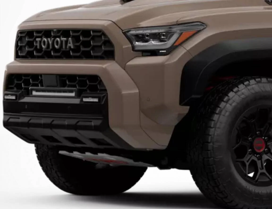

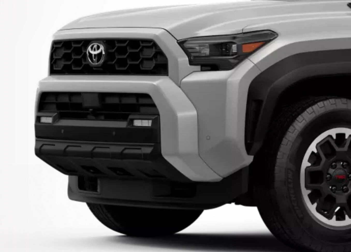

Is the increased ground clearance and approach angle of the TRD Pro / Trailhunter because of the plastic air dam at the front of the TRD Off Road? If that's the only difference then that should be an easy fix.

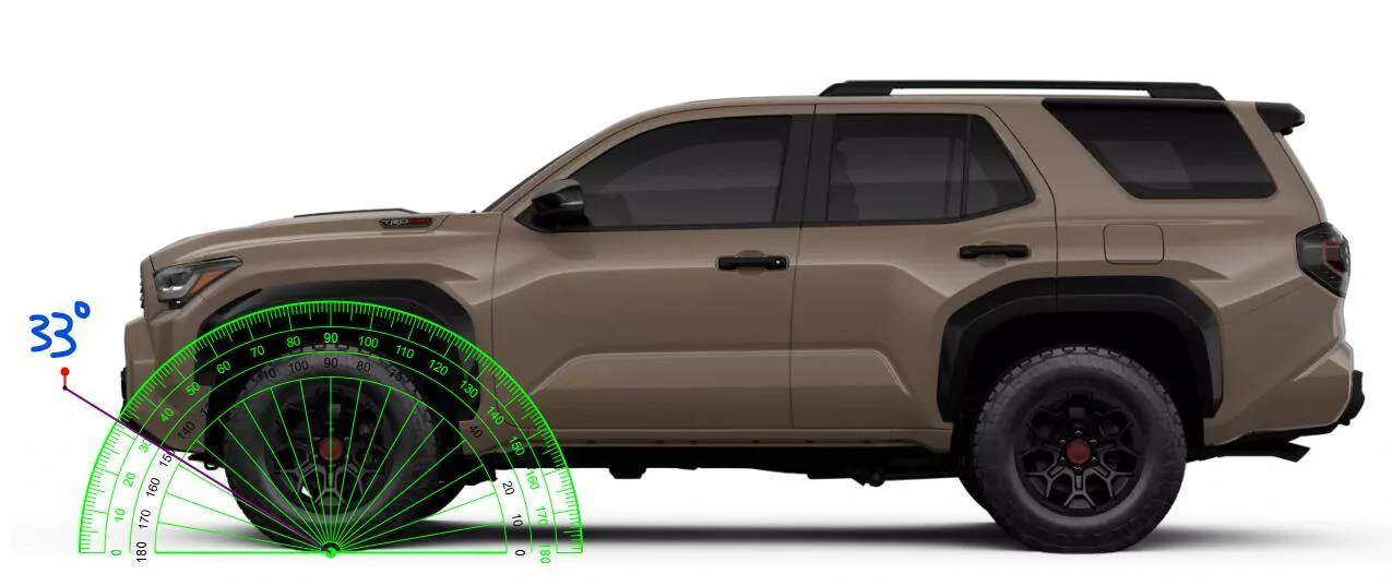

I measured it as in the picture.
- With air dam, it gets ~22°, which is slightly greater than official 19°. Given that we'll air down when "offroading" where the approach angle really matters, it will possibly drop from 22 to 19° in reality.
- W/O air dam, it gets ~30°, which is 3° smaller than TRD PRO. I presume it's because of the higher ground clearance on the PRO.

Make it an apple to apple virtual visual comparison, I also did it on the PRO.

Thank you for the technical / visual analysis! Helpful to know that the better approach angle on the TRD Pro and Trailhunter is not just due to the lack of the front air dam.

Great pics! looks like ripping off the air dam brings the TRD off-road to almost the same ground clearance and approach angle. Not perfect but certainly good enough.
