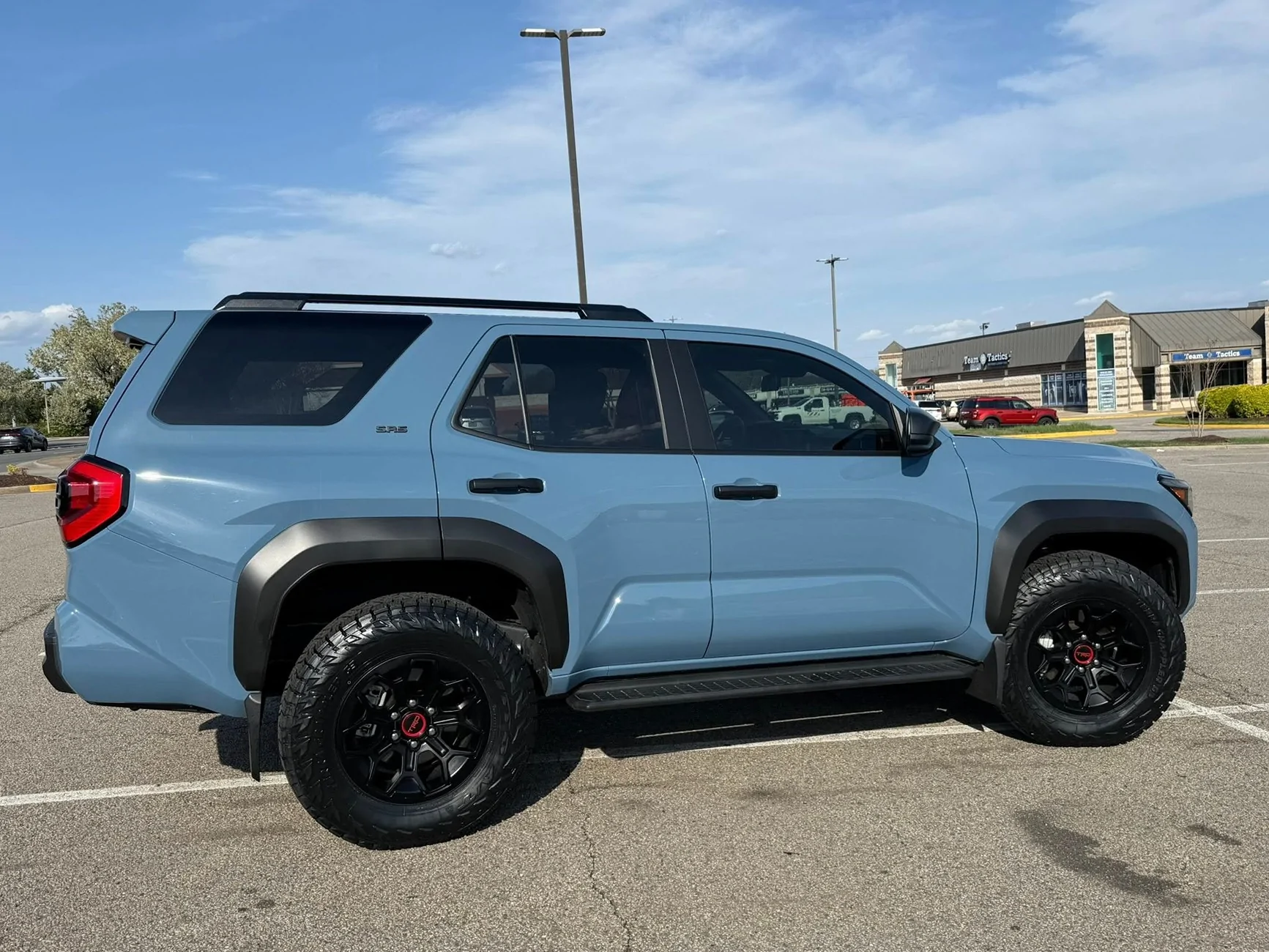

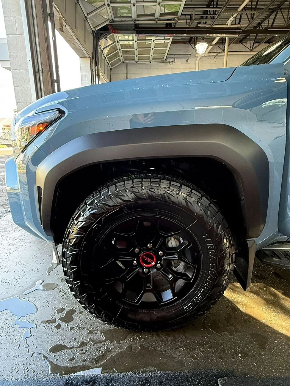

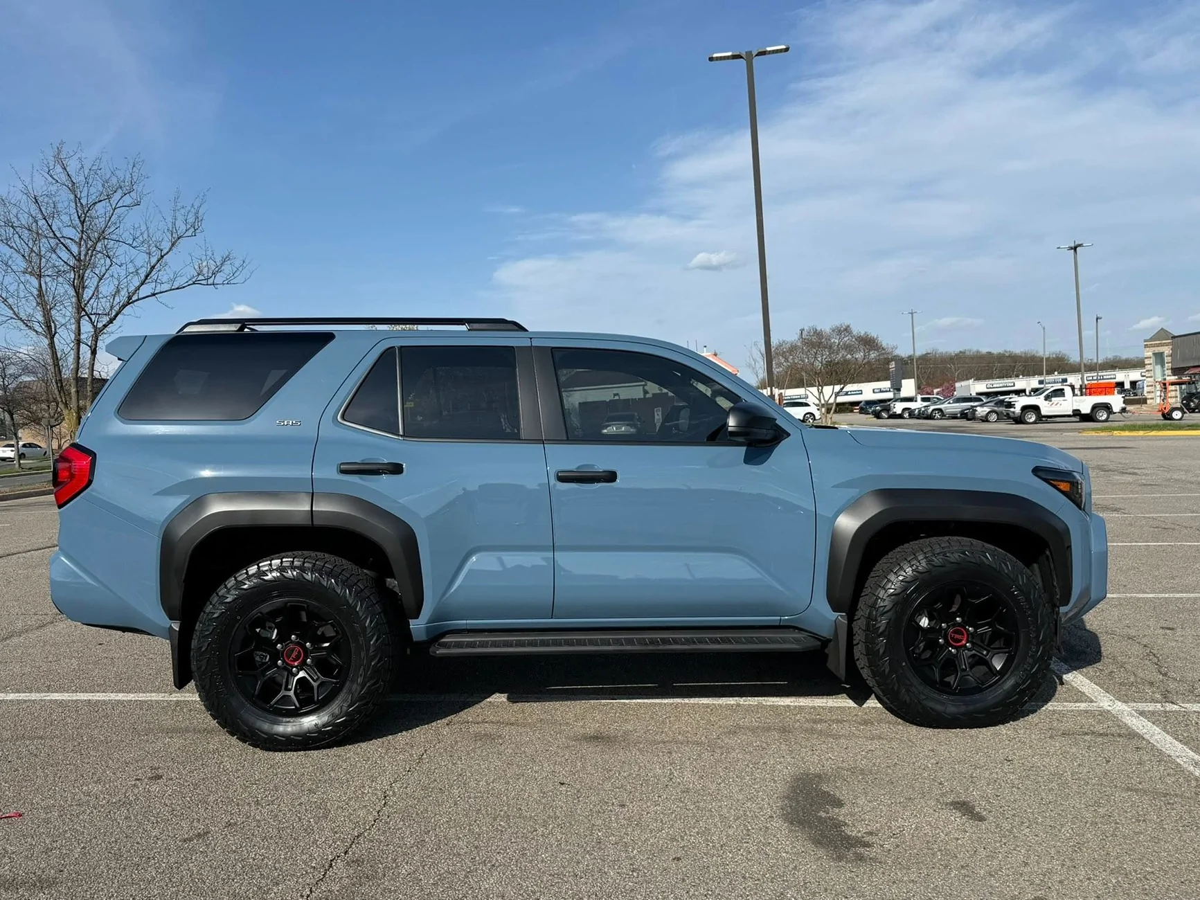

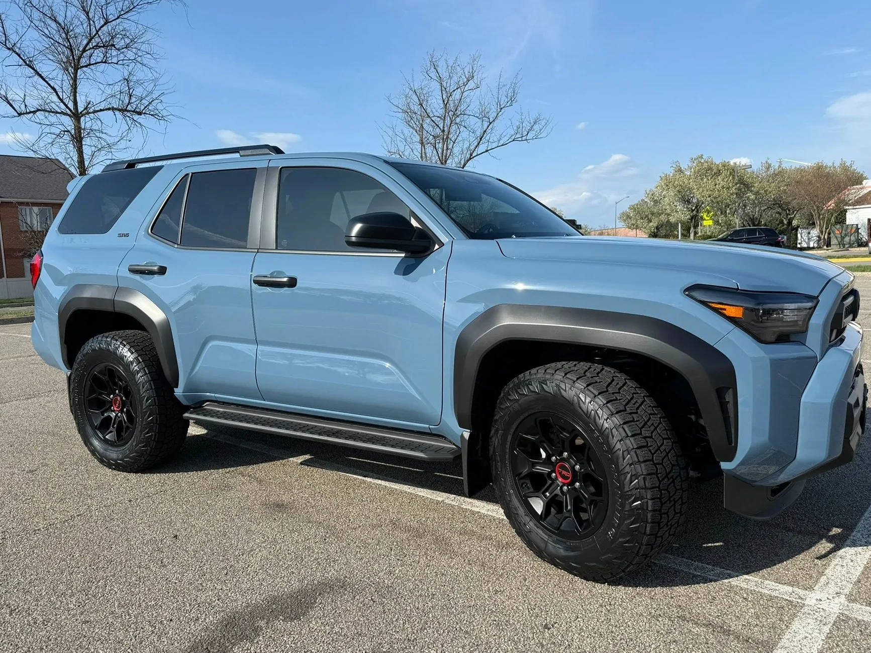

Easy. Many have done it. No mods or rub.
Example i found on Nitto Grappler G3 & 18" Pro wheels. Not mine!

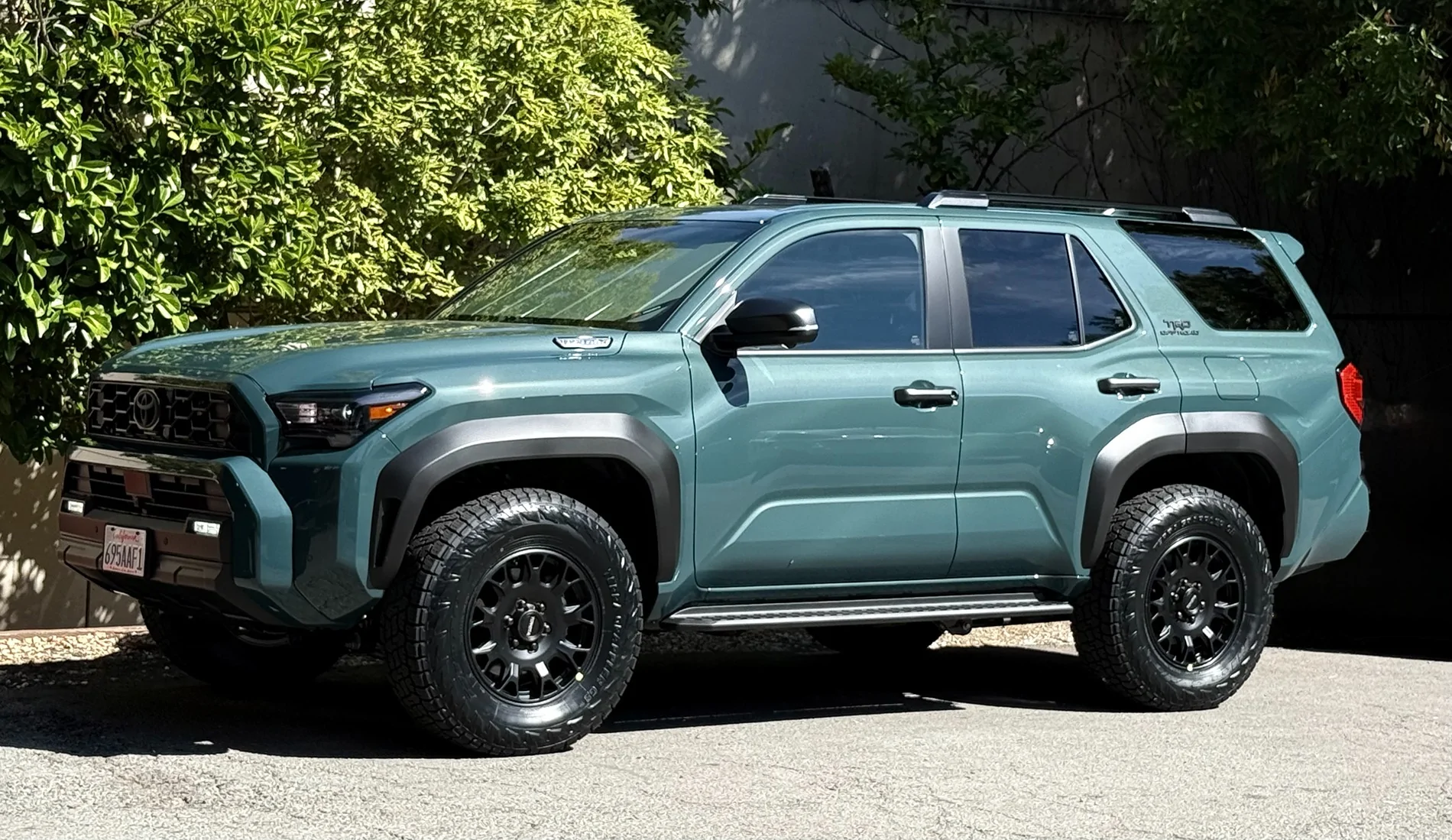

275/70/R18 Nitto Terra Grappler G3 on OEM TRD flat black wheels and stock suspension ORP Hybrid.
