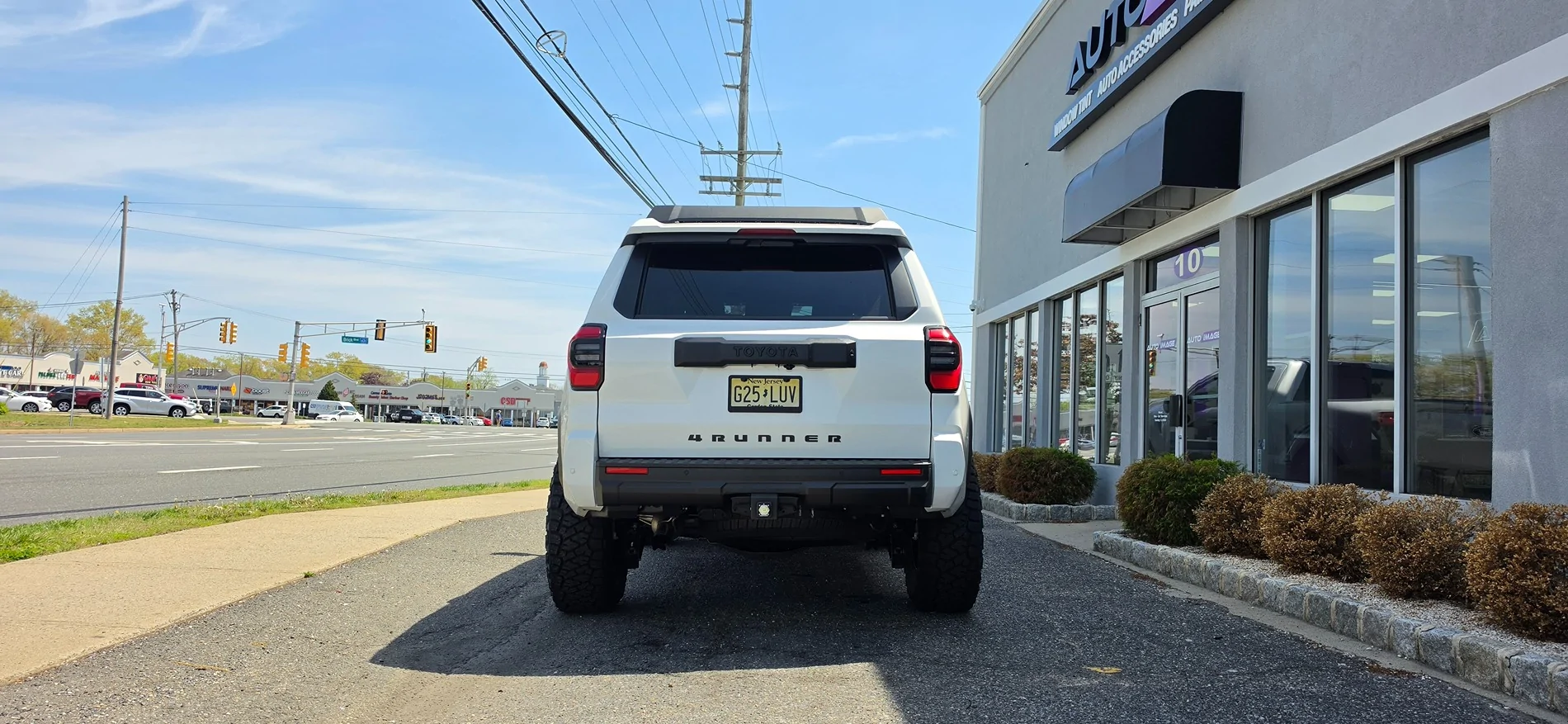

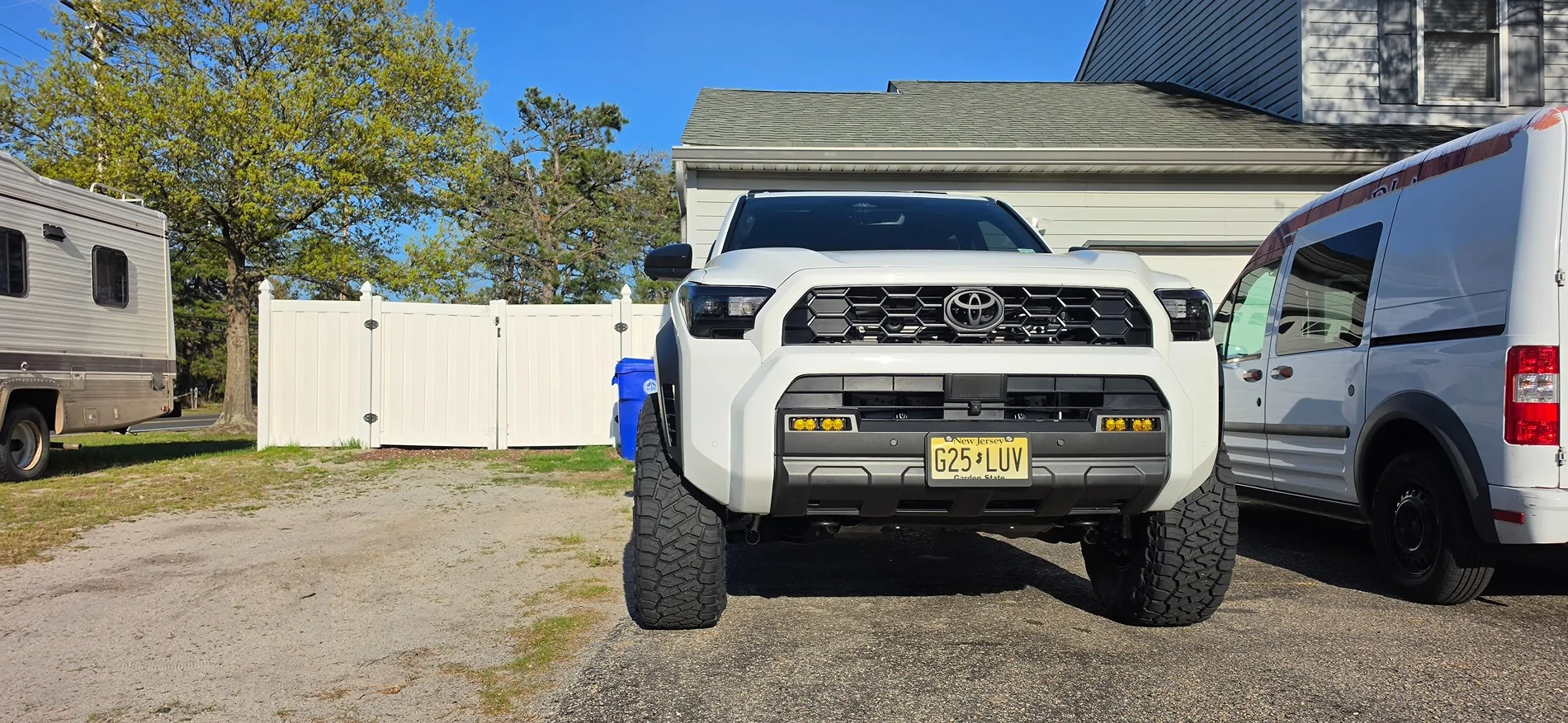

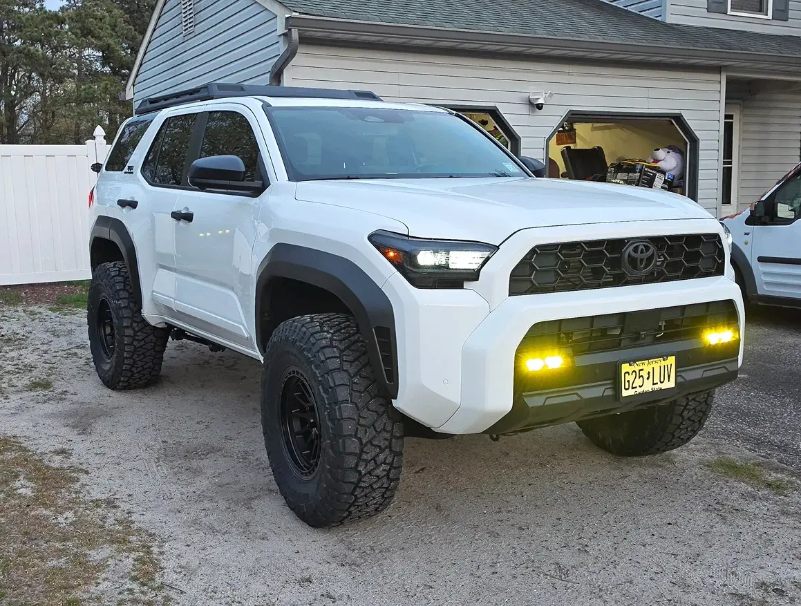

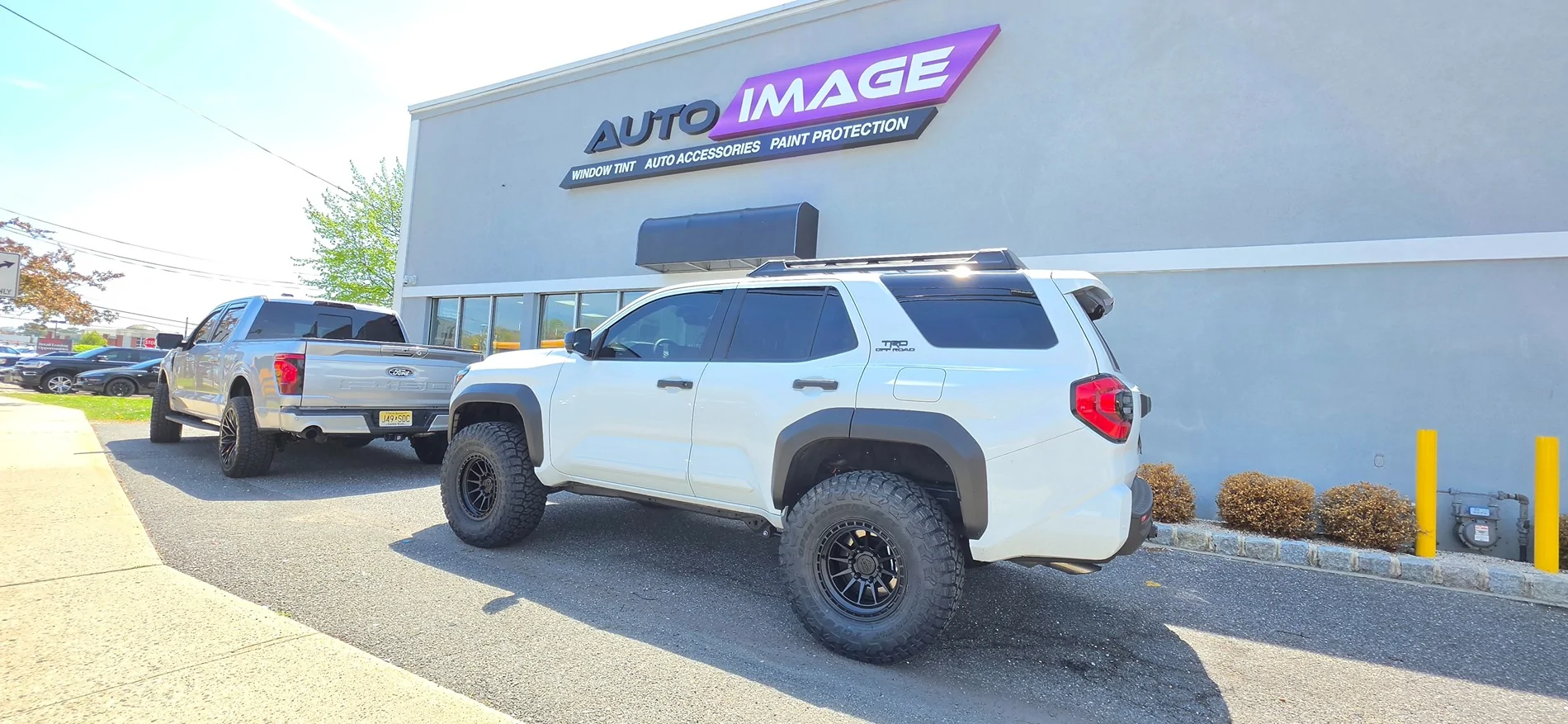

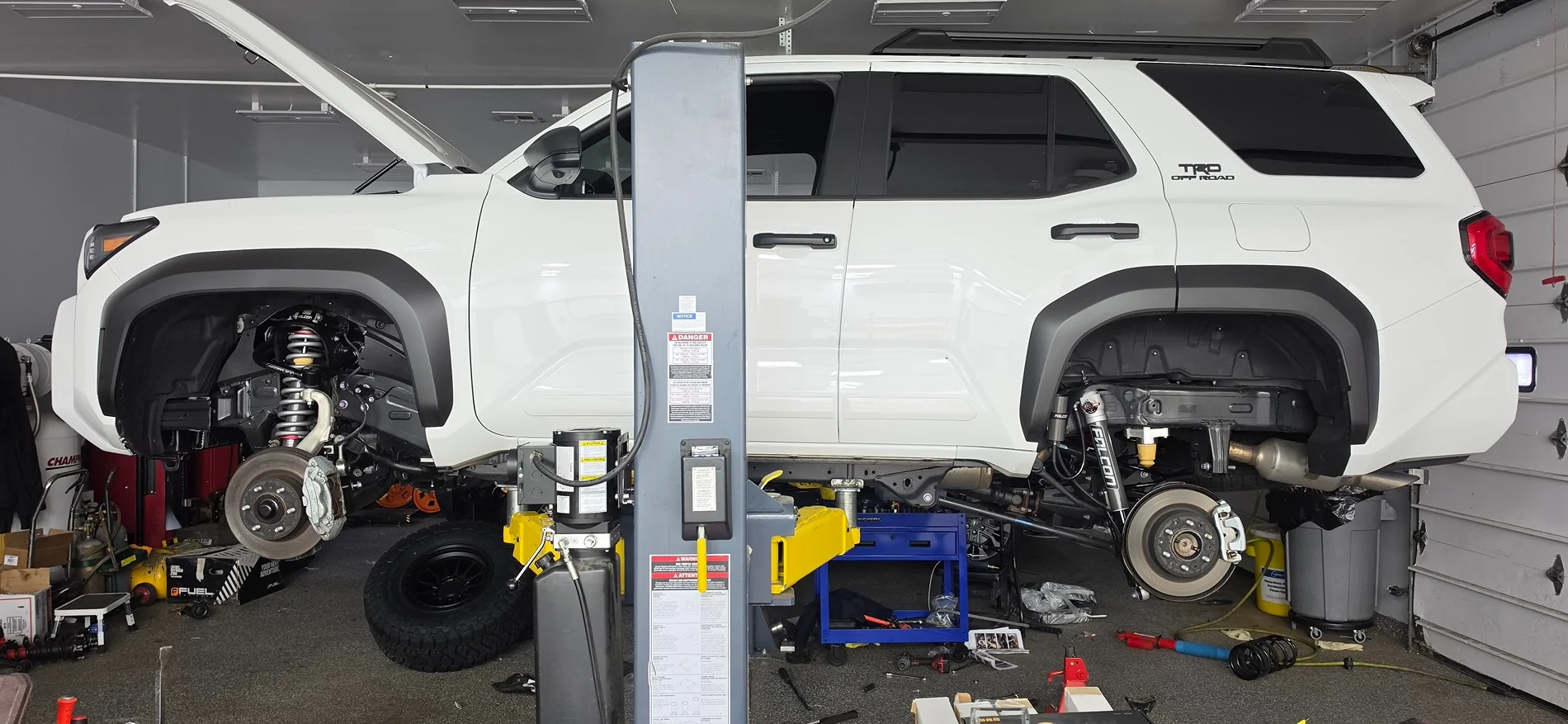

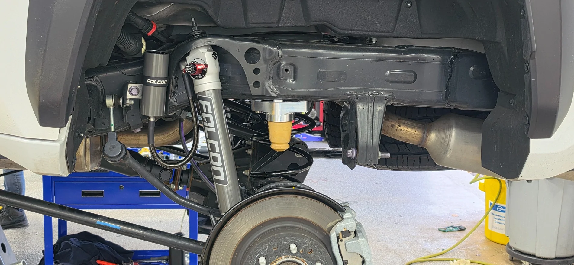

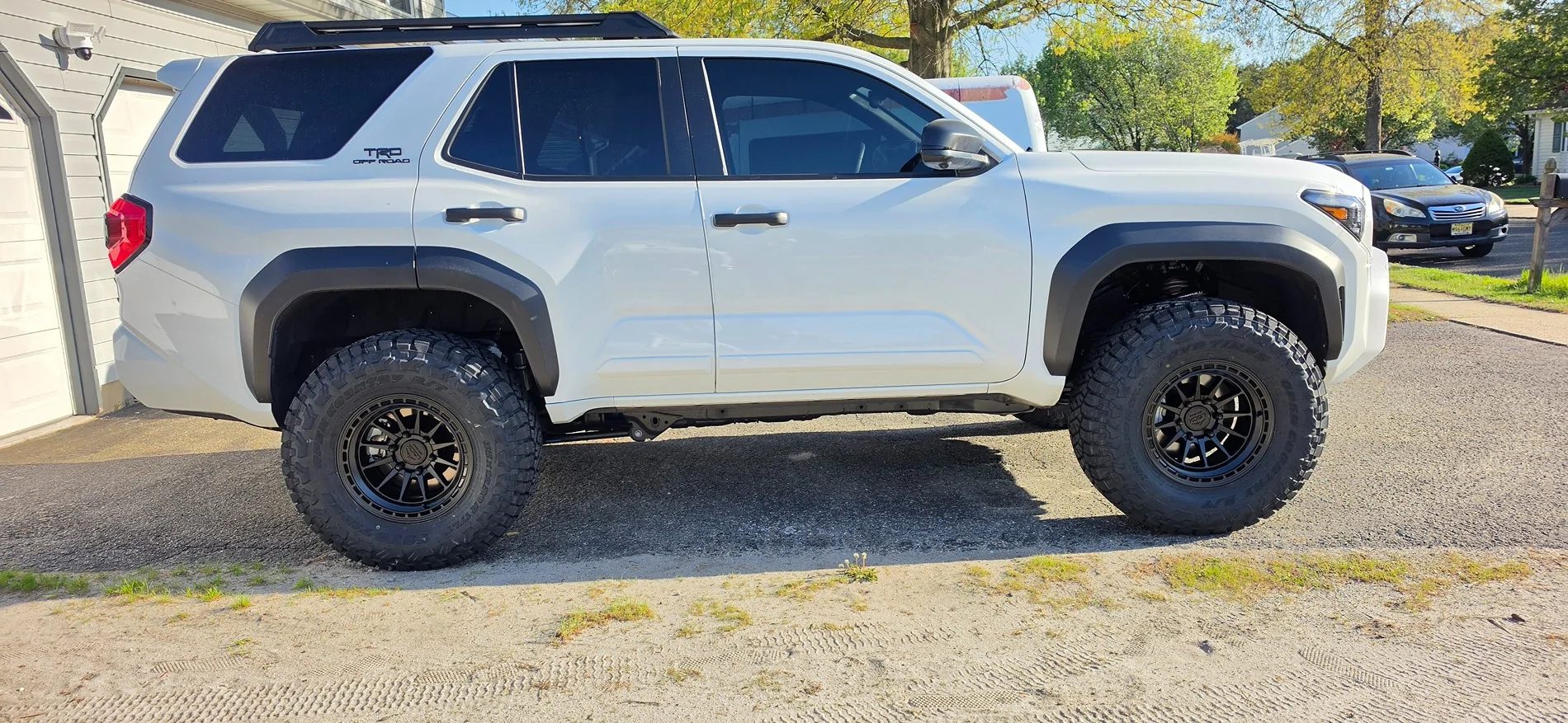

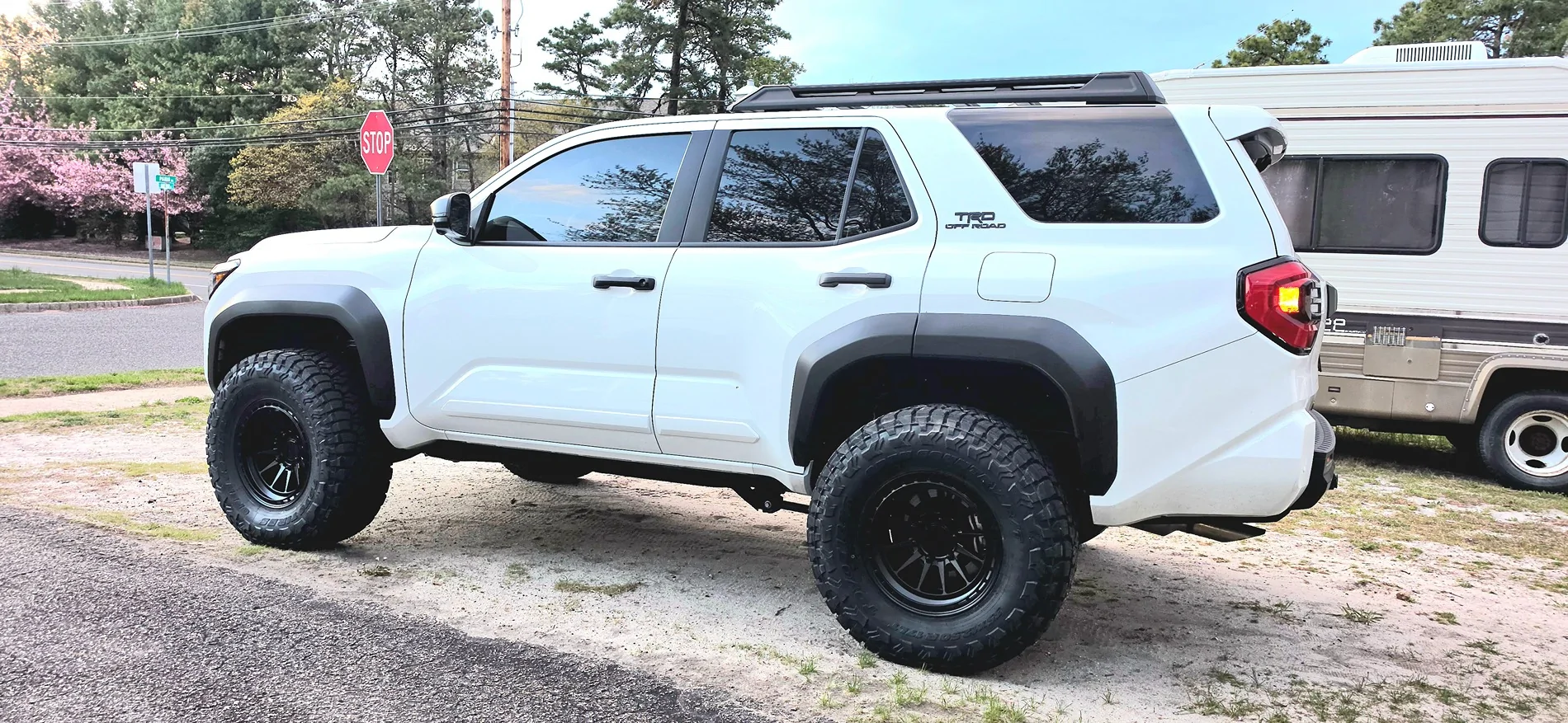

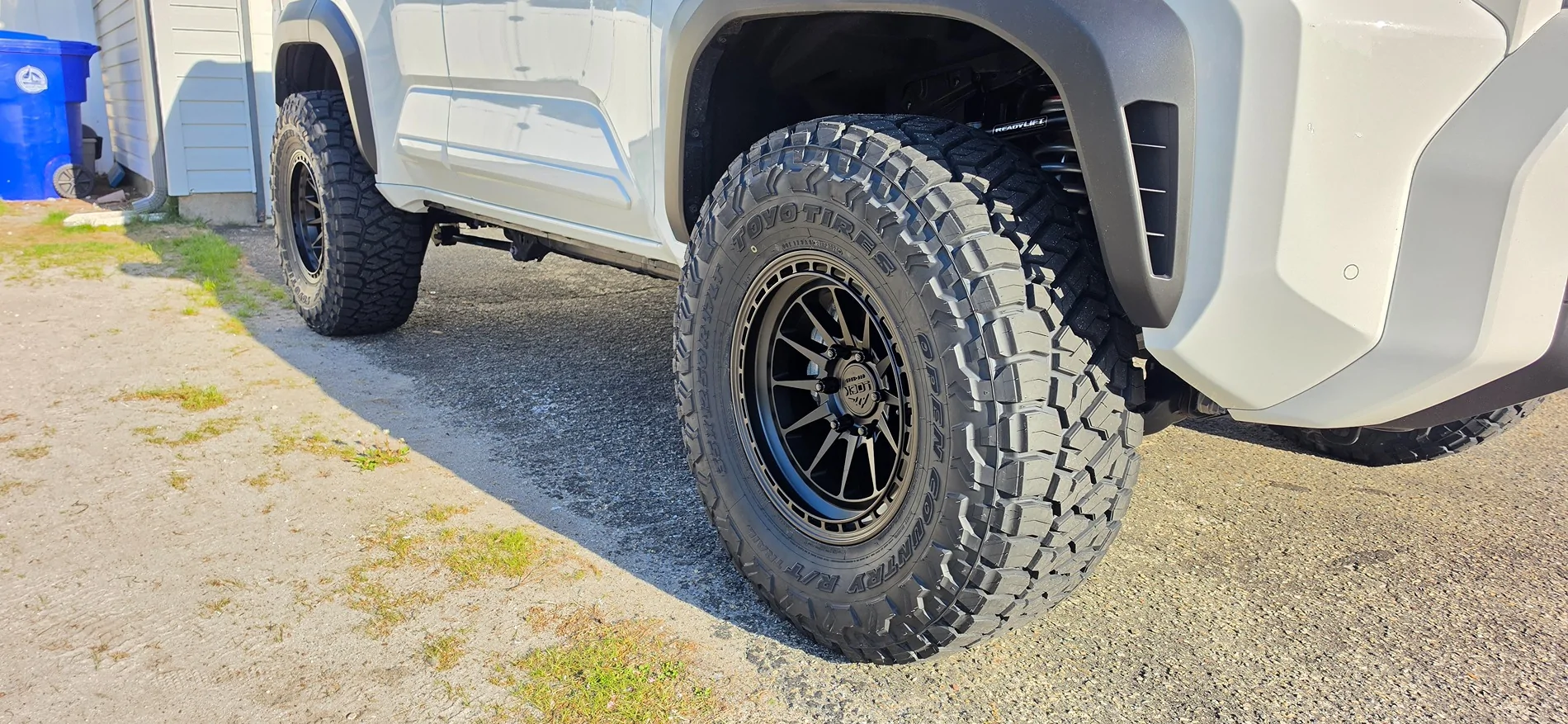

Since I have yet to see a build like this with 0mm offset on 35s, I decided to take the plunge. Absolutely worth it. No rubbing at all with minimal trimming.
Build so far:
3" Readylift SST 2.1 lift
35x12.50r17 Toyo RT trail tires
17x9 0 offset Lock Offroad Baja wheels
Baja Design squadron pro Amber fog lights
Trimming/ work needed
1. Back of front bumper small cut on inside.
2. Push front fender liner forward about an inch and repinned.
3.back of front fender near crash pad trimmed with some rear fender liner.
4. Remove crash pad
5. Good advanced alignment
All in all worth every penny! Feel free to inquire on anything I may have forgot. Hope this helps anyone looking to go big or go home 🏆

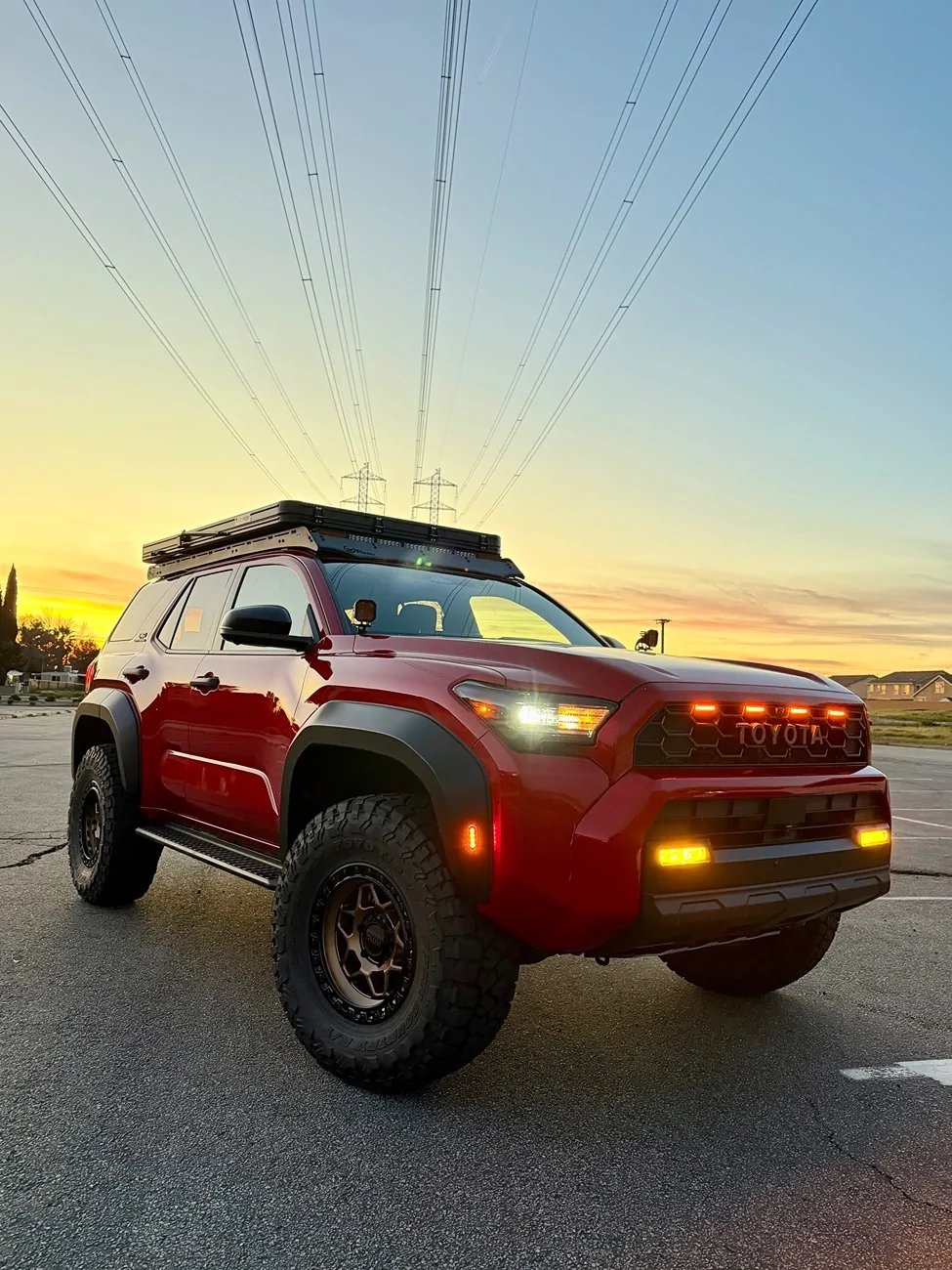

Nice. We have the same setup. You won’t be disappointed with this suspension kit. The ride was great. I installed everything by myself. The only thing I don’t like is the bump stops, they are soft and I changed them with perry bump stops.

I have Prinsu Original roof rack and prinsu ladder. I also have RC wide fender flares.
