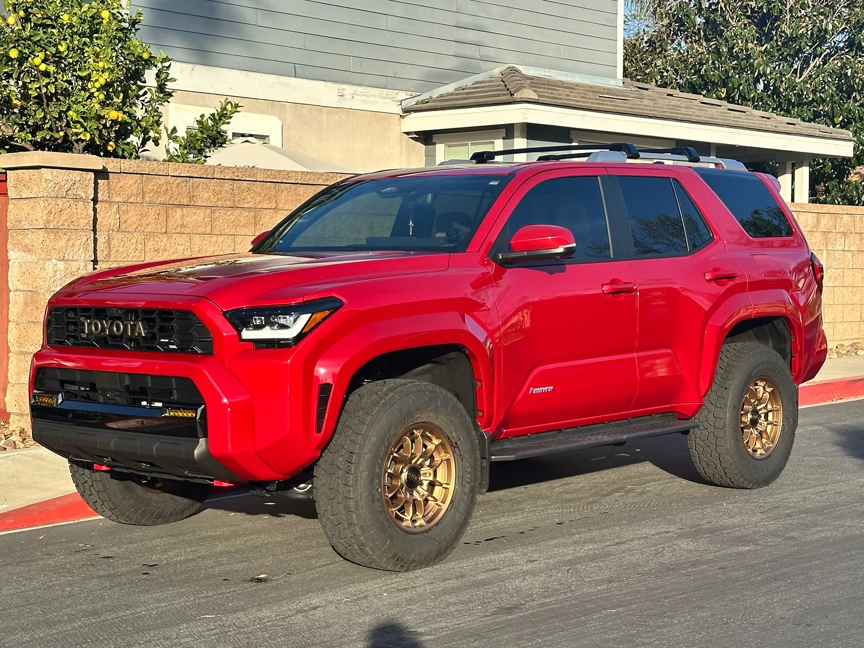

I just got my 2025 4Runner Limited a month ago. I ordered the heritage top grille only from Toyota to swap out, and start making her a look a bit more my style. Now Toyota is telling me this won’t be able to be swapped out because of the birdseye camera. From everything I looked up - the cameras are in the bottom grille. Has anyone come across this issue? Is there an aftermarket adapter piece I need to get or something?

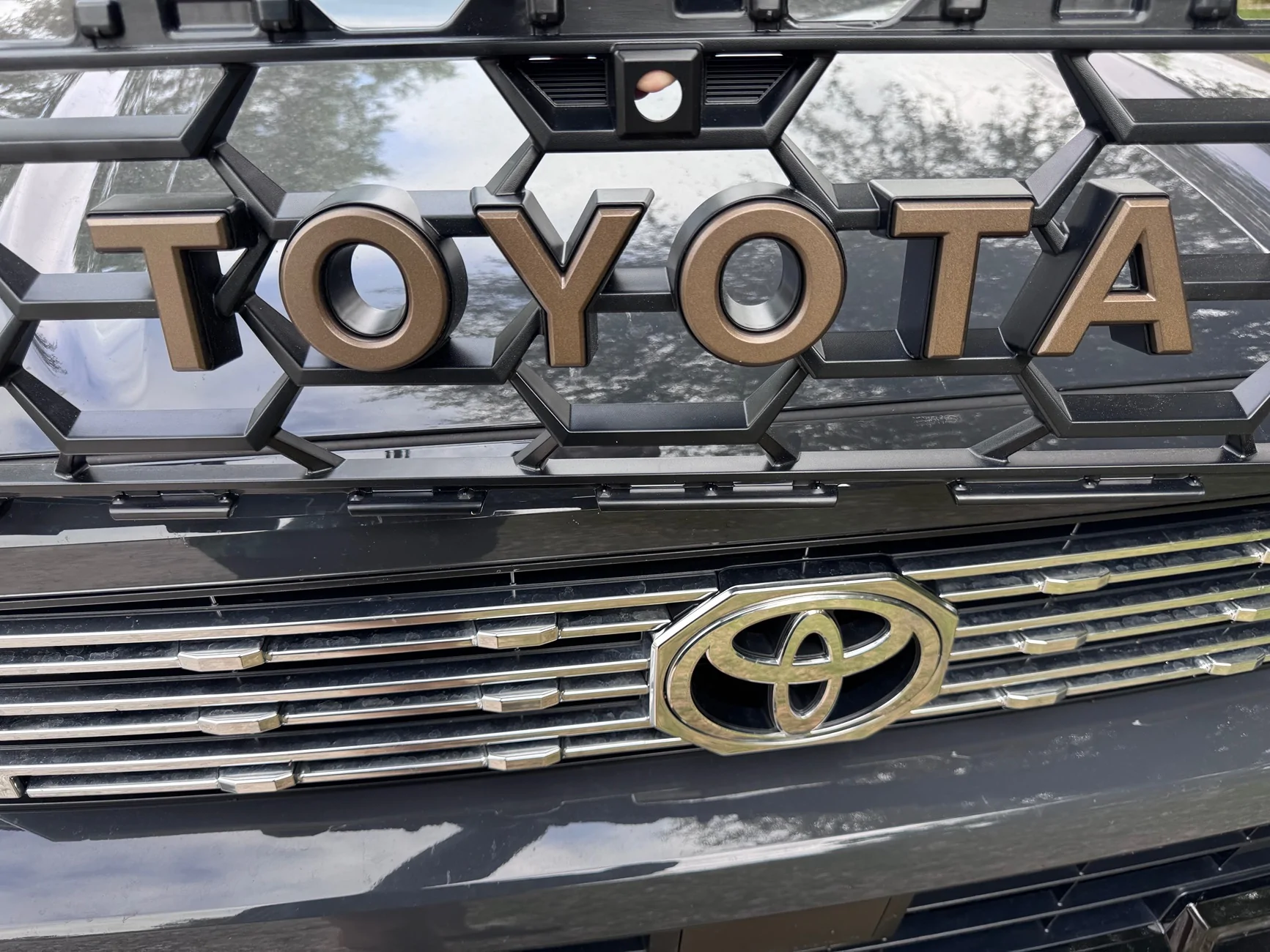

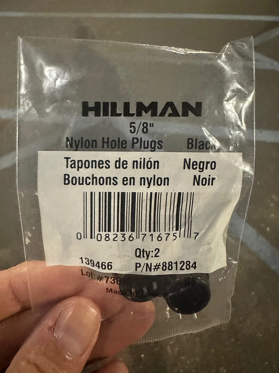

Your dealer is clueless. You don't move the camera, just put a plug in the grill hole. I got this one for $5 and superglued it in. https://kocreations.shop/products/heritage-grill-camera-hole-plug
I got the TRD Pro grill so I just painted mine gloss black (they come matte black).

I suggest you ask to speak with the service manager. You aren't moving anything. Many of us, myself included, have replaced the Limited grill. Nothing moves. Pop out old grill, pop in new grill. End of story (minus the 2-3 hours to do it lol).
