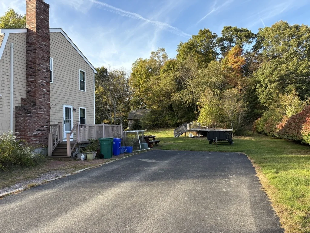

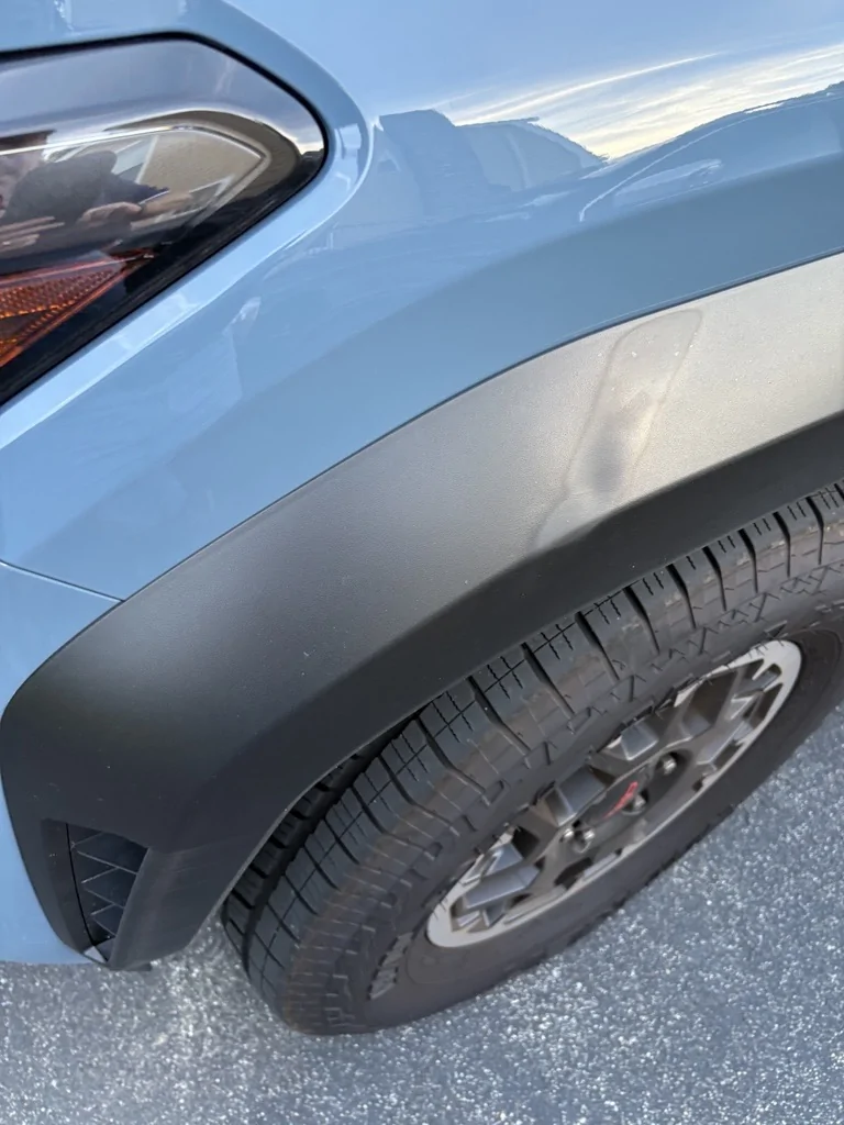

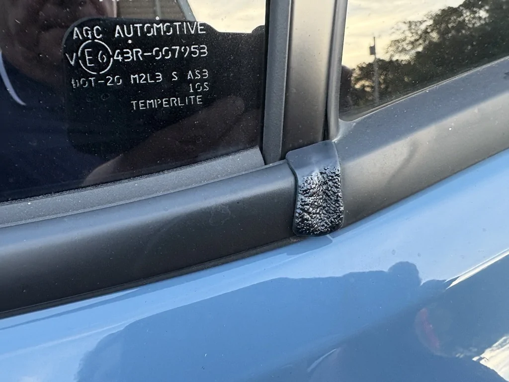

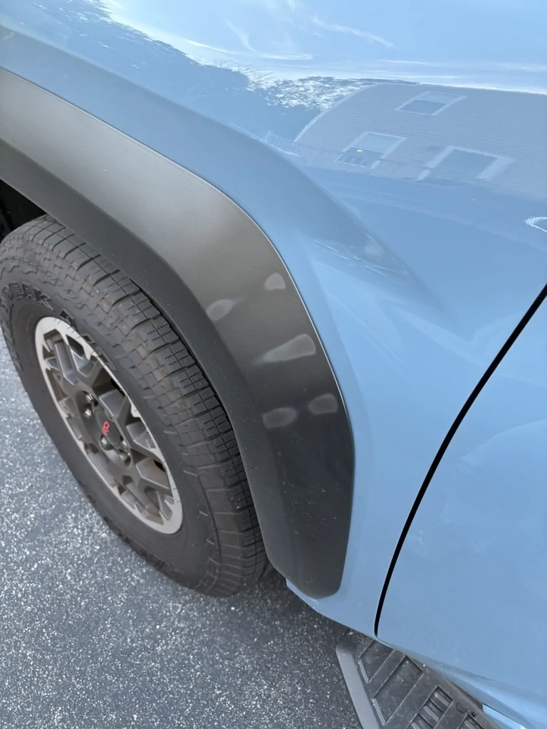

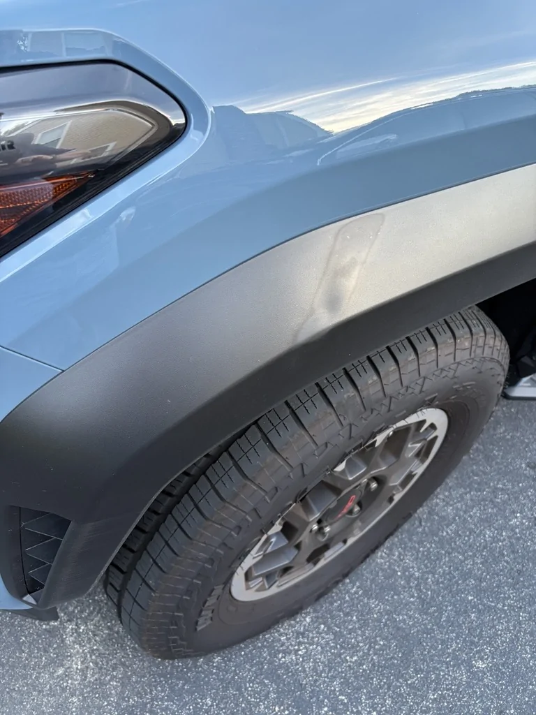

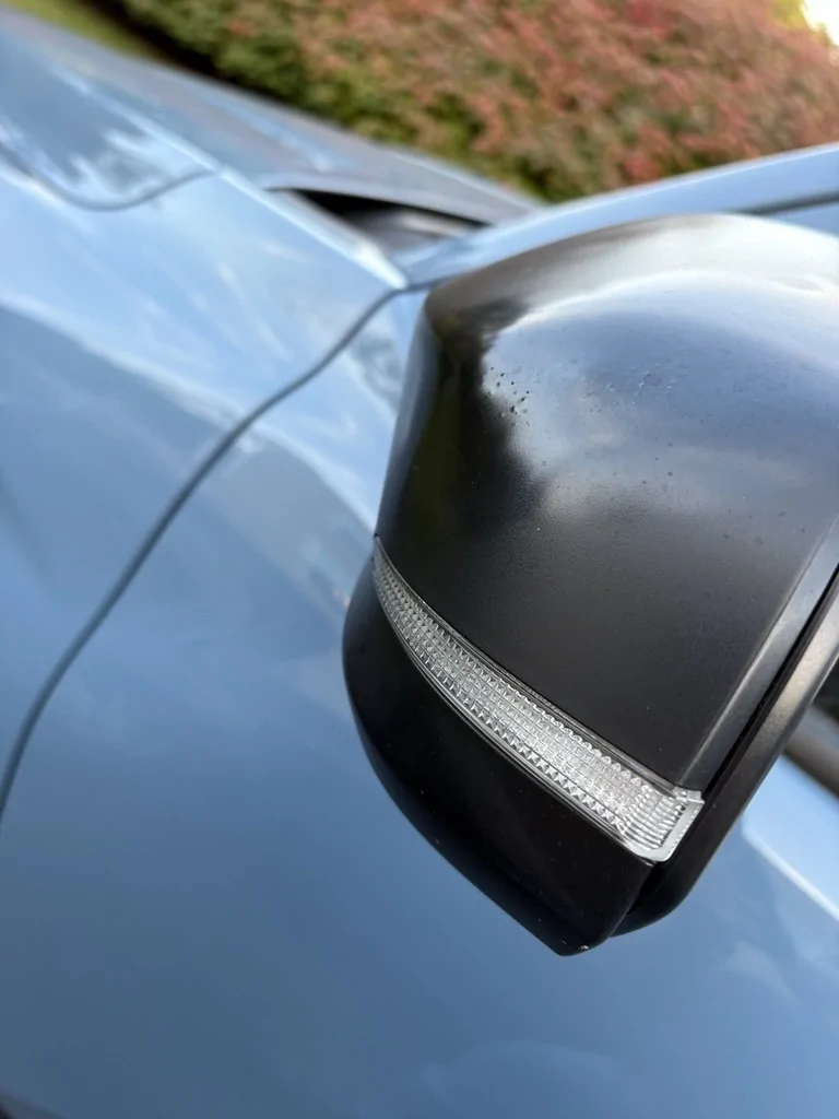

My 3rd 4Runner. 2025 TRD Off-Road Premium. Very disappointed in Toyota!
Driver wheel well trim and side view mirror, and rear window trim melting. Parked in driveway in Massachusetts. Dealer and Toyota refuse to address.

Now that is bizare, I live in Texas so clearly alot hotter and my 4runner was in Death Valley this summer and looks perfect. The fender flares are weird, the mirror caps look like something in the enviornment could have gotten on them and same for the window trim. I say try another dealer and if none will help out those parts are cheap to replace if you needed to.. The trd pro ones go for $230 for the set
2,376
1,352
that looks like heat reflection off something.
you wouldnt have a very specific narrow band of melting if it was just general in the open melting.

This is 100% Sun reflection off low-e glass from a building/house. Either yours, neighbor, or work/street.
I know this because I had it happen to a Subaru I used to own. Sun reflected off my south facing windows onto my driveway.
If your house, you need a (bug) screen over the windows to help diffuse (what I did), or a film that can go over the glass. If neighbor/work... park somewhere else.

Yep. There are many cases where the business owners have paid for the repairs, and the town/city should be notified. However, you need to document time of day and which windows.
In my case, it was my windows on my house. If your house and parking position near absolutely cannot reflect the sun onto your 4R, then you need the above. And, don't park there. ;)
