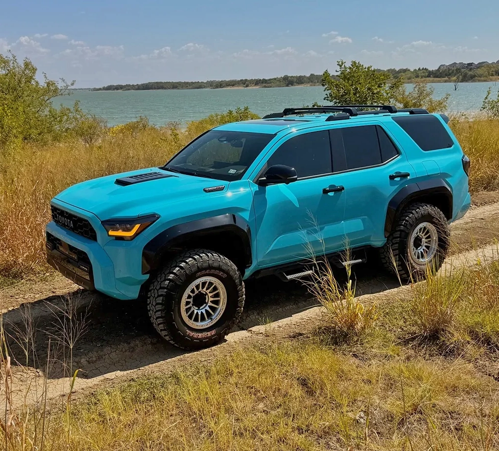

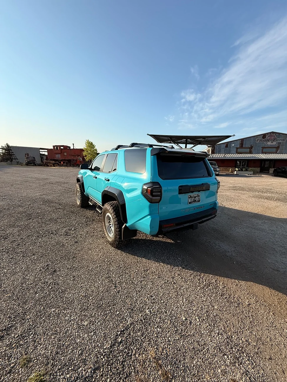

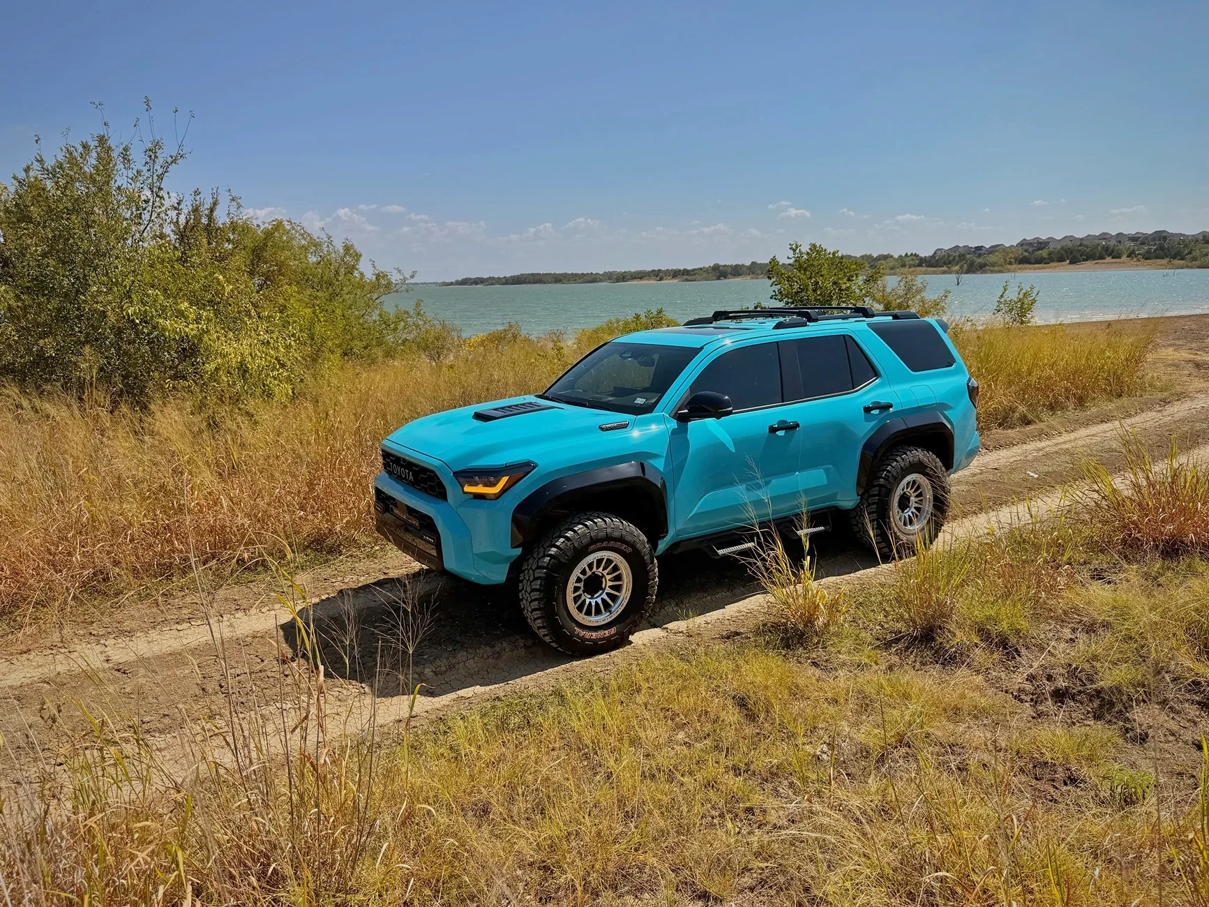

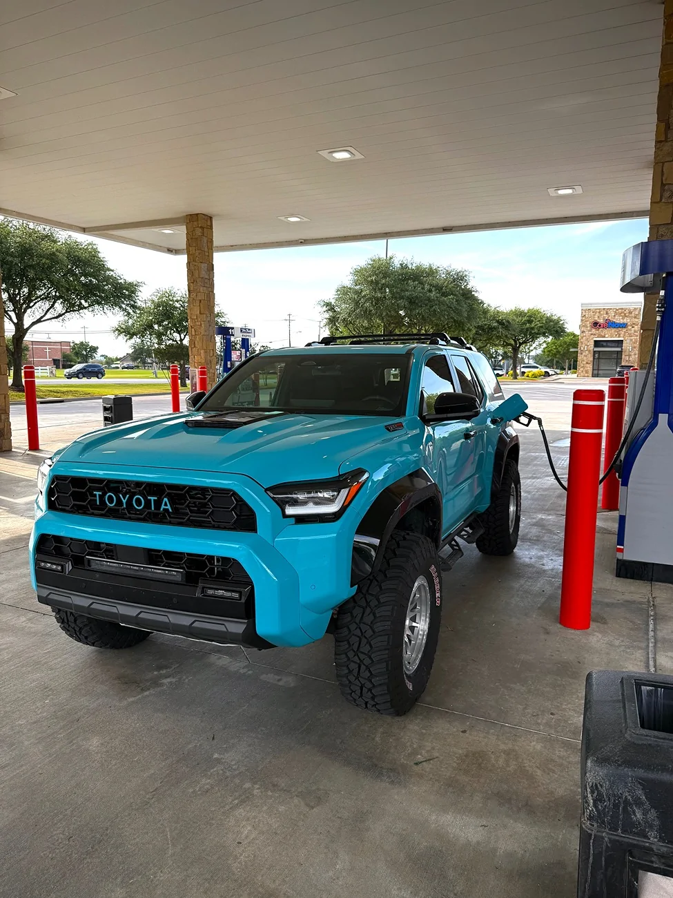

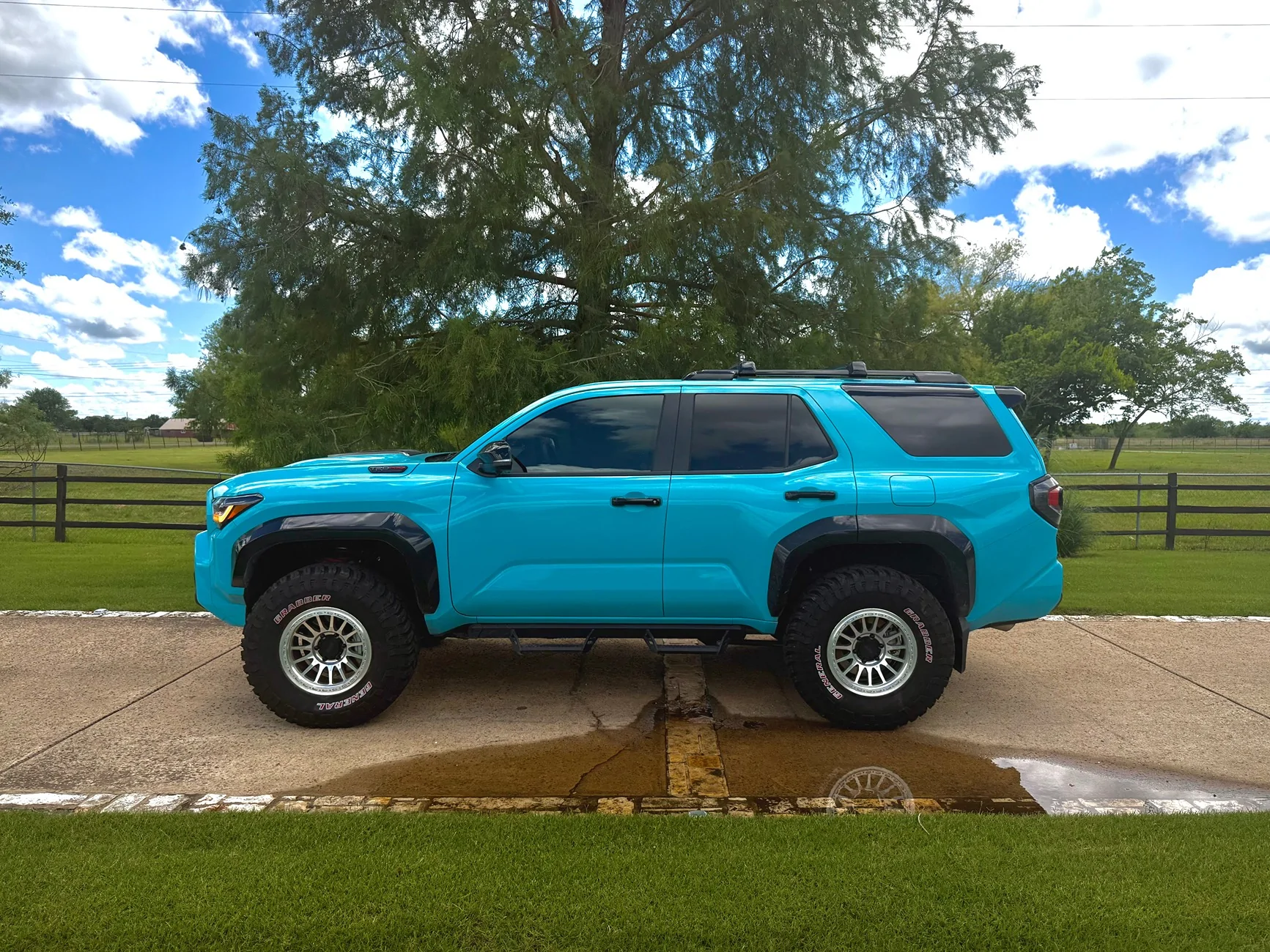

Hello! I wanted to share what I've got going on so far with my 2026 Wave Maker Pro:
Suspension:
  • Westcott Designs Pre-load Collar lift kit
    • Top Hats were included with the PRO trim, they are advertised as optional but I went ahead and had them installed.

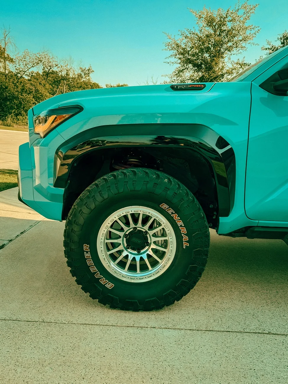

Wheels:
  • Relations Race Wheels (RRW)
    • 17" RR7-H Monoforged 2.0 Hybrid in Brushed aluminum
      • 0mm offset
        • I may add the protection rings later on, which will give it a "true" Beadlock look.
Tires:
  • General
    • Grabber x3
      • 35x12.50R17
I will add that I went with 0mm offset to have some poke since the PRO fenders do stick out a bit further. The crash bars were removed on each side. There was a very slight rub when the wheel was fully turned (hitting the front fender area). But since I have gotten an alignment, there has been no rubbing at all. I'm sure I will have more planned for it, but as of right now, I'm enjoying it. If you wanna see more of it, please feel free to follow me on instagram @Wavy_Baby_Pro

Nice. The only thing is with 0 offset how will that perform under heavy shock compression with the wheels turned. I learned the hard way with my first 4runner, a 1st gen. Got over the wheel poke quickly for better off road use.
