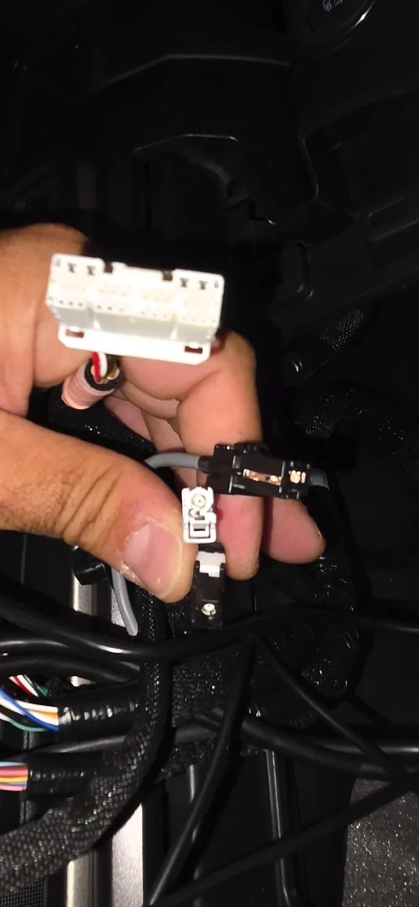

Hi very nice video . I installed mine 3 days ago. I saw that you have only 2 wires that you did not plug anywhere. This is weird because I have 4 of them see attached pictures. The white big one is the one that you said for the white and red RCA cables but they have not sent me anything for this cable. I assume that its for the audio but I am not sure for which speakers is this wires for. I think that all my speakers are working .
I think we have 6 speakers in the sr5 .
The other 3 I assume that they are for the GPS , Sirius and I don't know the 3rd one ( maybe microphone ???)

I was told by car trim home that you may not need the rca cable that attaches to the white plug pictured. Yes, there are 6 speakers in the sr5. You can use the audio options in the unit to balance to each speaker to make sure you have sound just to double check.
if you could give me some time I will pull my unit and double check which wire you have left unconnected, did you connect your head units usbc?

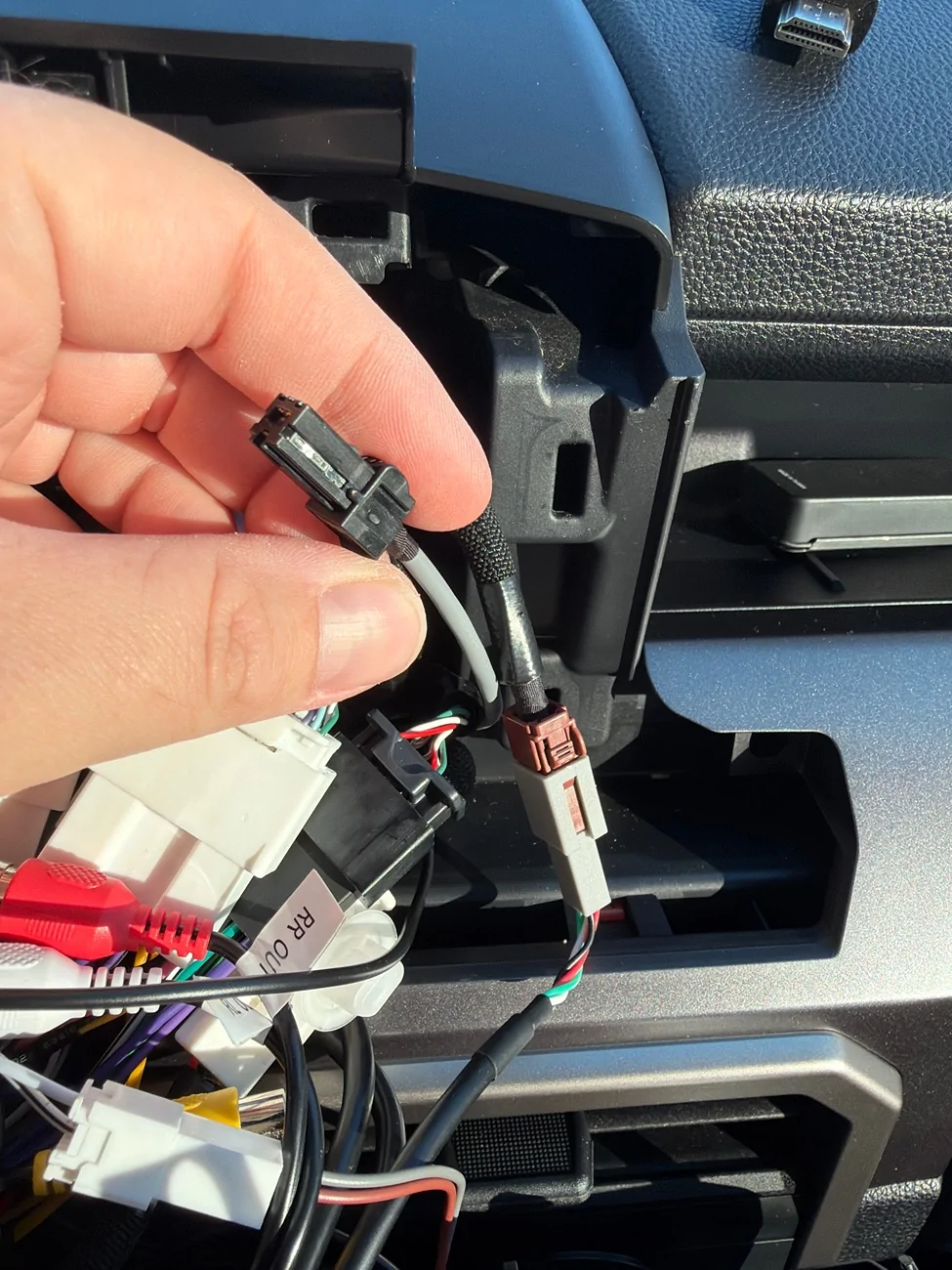

Ok, I see you have 4 connectors there. I only have one of the black connectors left. I could not locate an additional one. Cartrimhome is very responsive to any emails though so far in my experience.

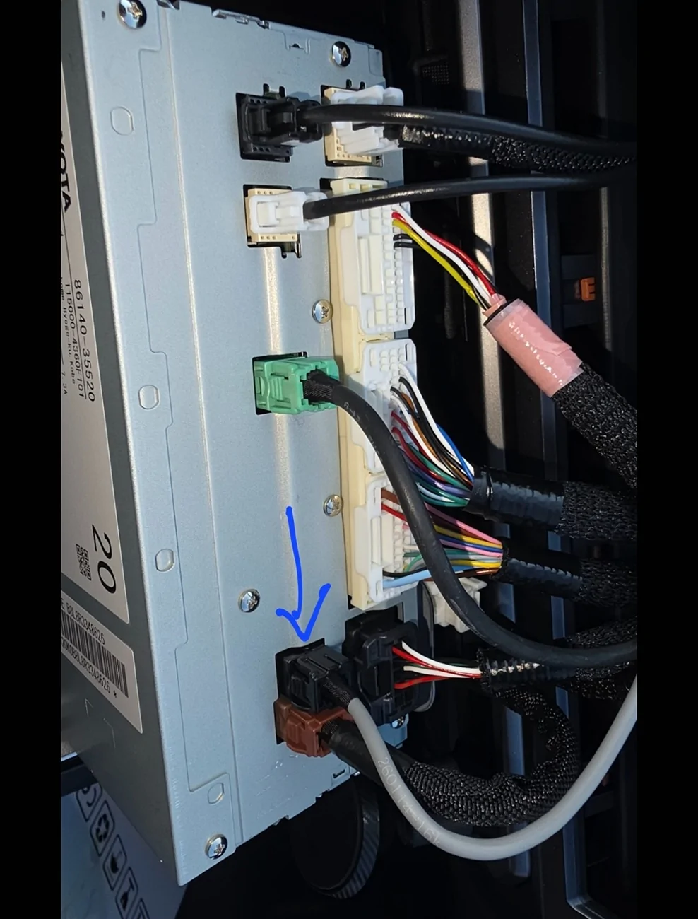

This is the 4th cable . Do you remeber connecting it this cable anywhere ?
I have already asked CTH if they know what those wires are but they don't know exactly.

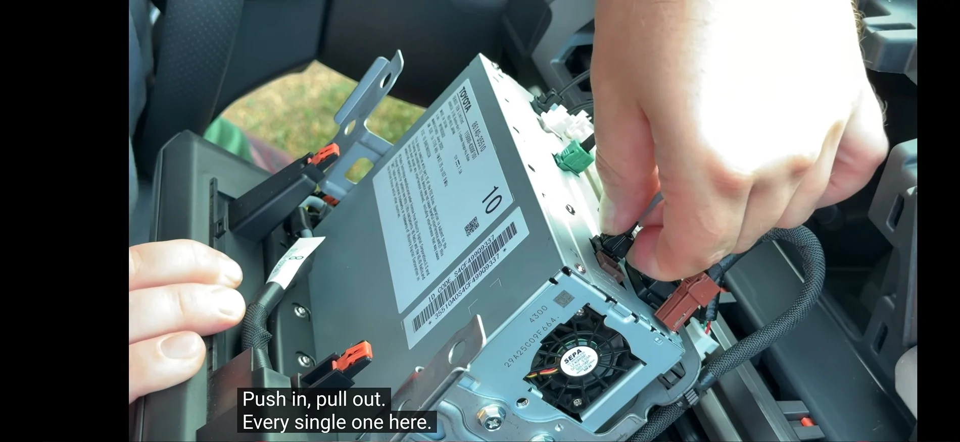

From your video its the wires that you are pulling

That is not attached to anything.

Yes ok I am thinking that this maybe is the digital microphones but I am not sure
That makes sense because the microphone built into this unit is no good. I plan on buying a mic that plugs into a mic input on the back. You should look into too if you it’s on the same cable harness that I plugged the Nintendo into.
