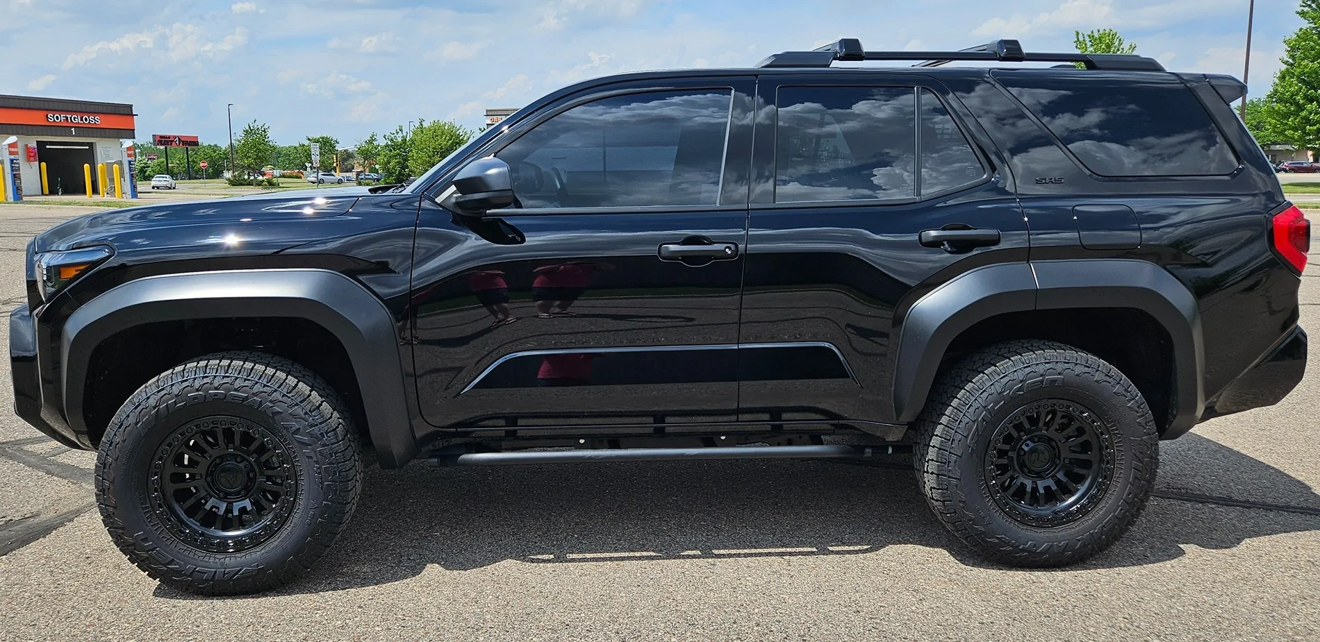

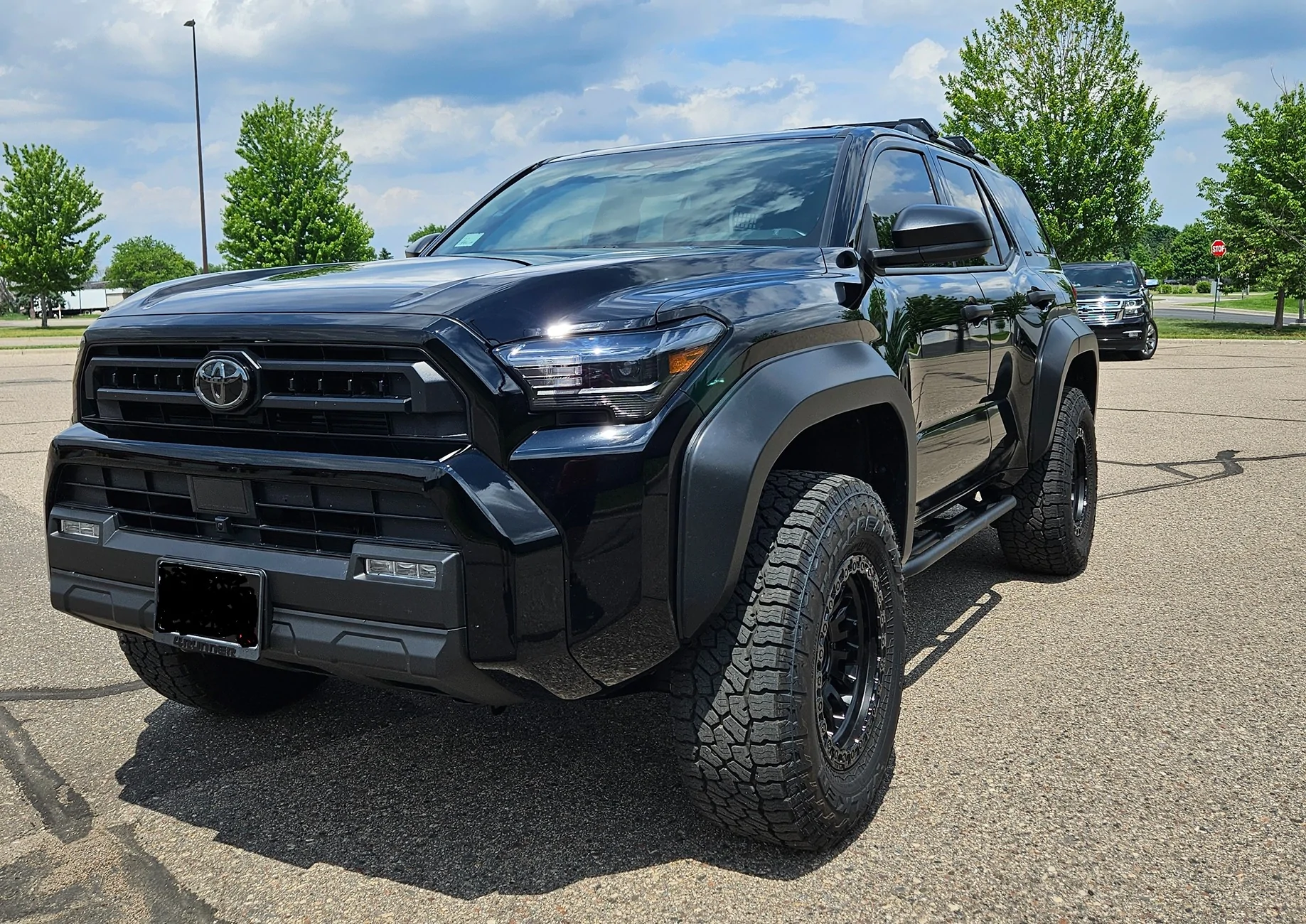

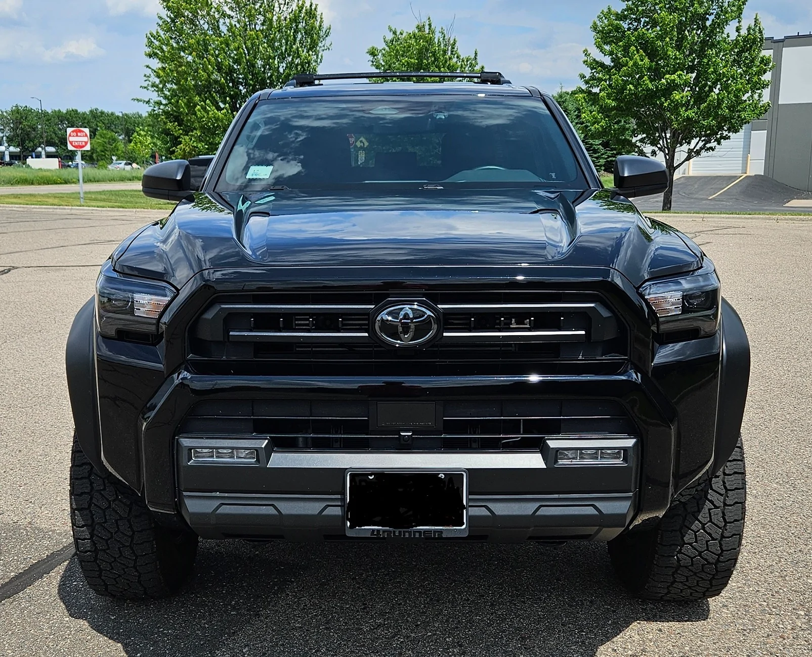

Got this 1 year ago today and have never had so much fun in a vehicle. I tried to keep aftermarket modification simple and clean. Just thought I'd share, I love how it turned out.
-Rough Country M1R loaded struts in the front (3") and Westcott coil spacer in the rear (1.5")
-Fuel RINCON wheels 17x9 +1 offset. Needed to put on extended fender flares for these due to the big offset change and an extra 1.5" of wheel width, gave an estimated ~2 inches of extra poke which looked great but was shotgunning my rocker panels with gravel
-Falken Wild Peak 285/70/17
-Cali Raised rock sliders and interior MOLLE paneling

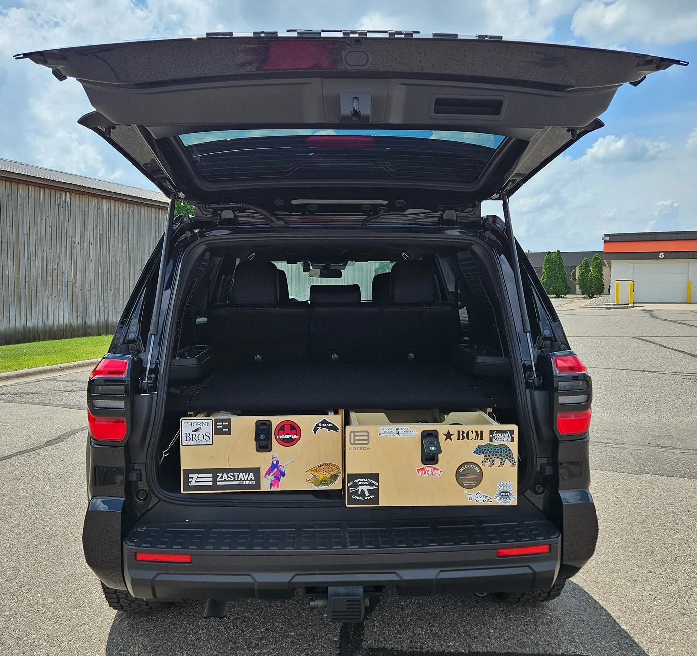

-Slideout locker system/sleeping platform by Colfax Campers

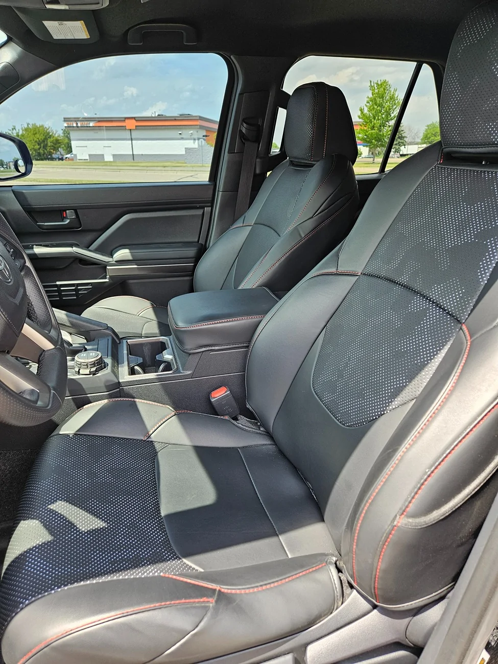

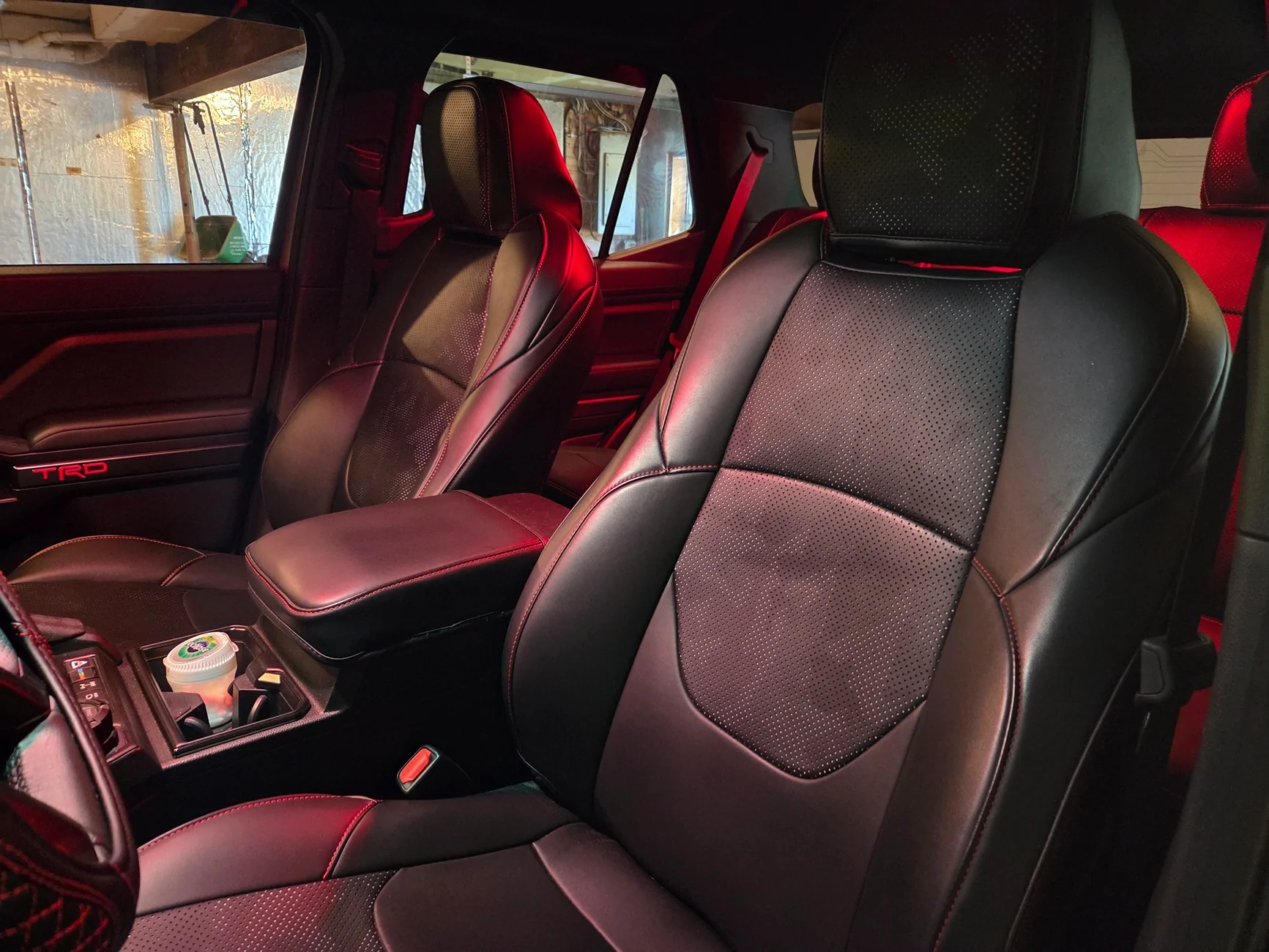

I have the same seat covers and can attest to the good quality, fitment, and durability.

Yep they provide great coverage and are meant to replace flaps. I love the wheel setup, gives a noticeably wider stance and looks very cool in my opinion. I had the extra wide TRD mud flaps on there to cover the 285 tires before I switched to these and when the new wheels got put on, the flaps looked very tiny. It's a pretty significant change compared to stock. To note, the big offset change with the bigger tires did add a little rub when reverse at full turn. I rarely have to full turn in reverse so its not an issue for me. Going forward, no rub even at full turn. Congrats on the new ride
