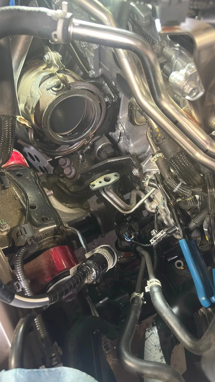

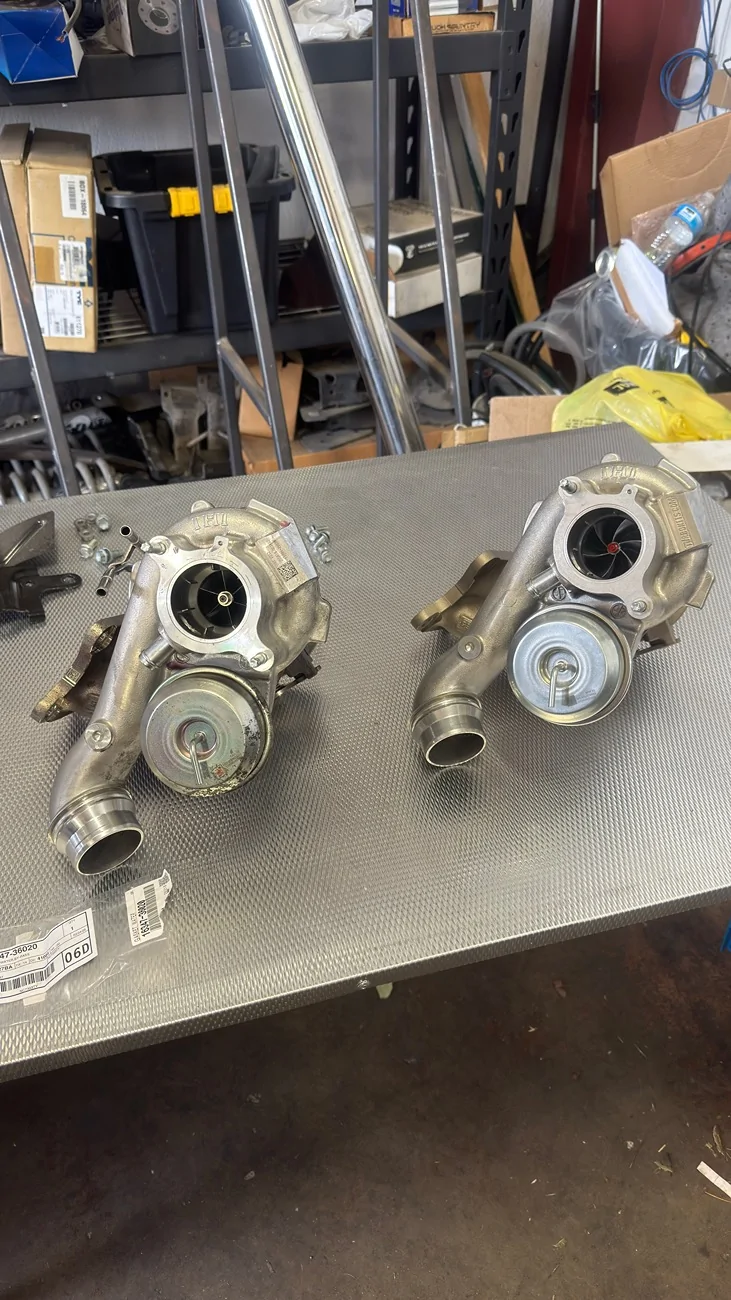

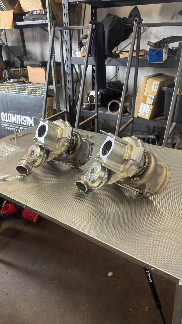

What’s up guys! Got the upgraded bolt on oem replacement turbo from Big Dawgs Toyota Tuning installed today. Have a YouTube video coming soon.
We still need to grab some dyno numbers, so I can’t give an accurate number there yet. But it’s a pretty sweet upgrade paired with the OTT tune.
Mods needed for this will be: intercooler, tune.
Can get a downpipe later but it’s pretty recommended to snag one also.

It’s actually an oem turbo - just upgraded internally.
