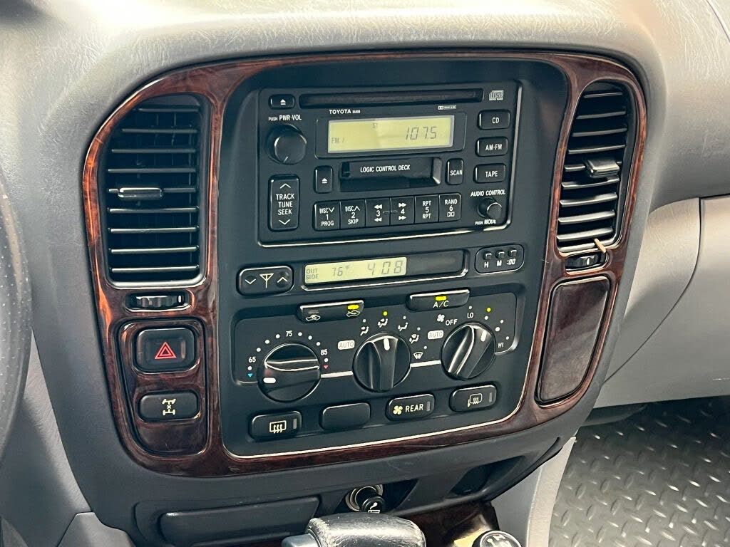

Hmm. I wouldn't consider myself an expert, but every 100 Series I've ever seen has the CDL button for a center diff lock. This is a picture of a 1999 LC, and the CDL button is in the lower left corner--the depiction of the drivetrain with an X for the center diff. Perhaps it functions differently on the earlier LCs--again, I'm no expert.

you have a picture of a 99 land cruiser, I had a 99 land cruiser. That button is how you lock the center diff in 4 hi. As soon as you pull the shifter back and put it in 4lo, you hit a switch in the transfer case. This switch locks the center diff, turns on the 4lo light on the dash, turns off the abs and vsc, and allows the rear diff to lock in vehicles equipped with one. See post number 4 in this thead. the person modified their LC to allow 4lo without the center diff lock.

Interesting! After poking around a bit, it appears that only the 98 and 99 LCs could not run 4 LO unlocked without the mod you referenced. 00-07 you could (which is what I was familiar with--I assumed all 100 Series were the same.
