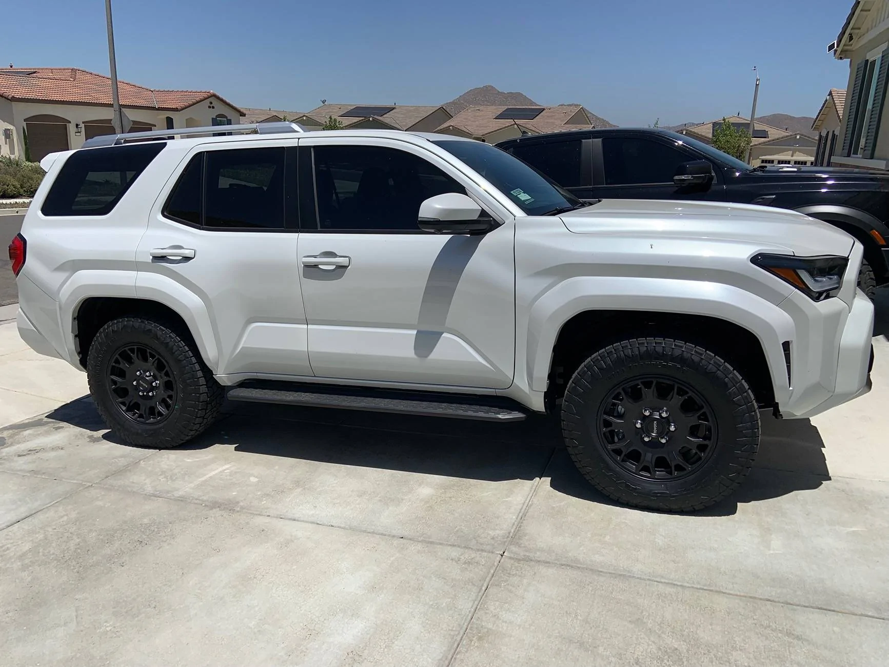

I upgraded to the 20 inch rims and Nitto Grabbler tires.

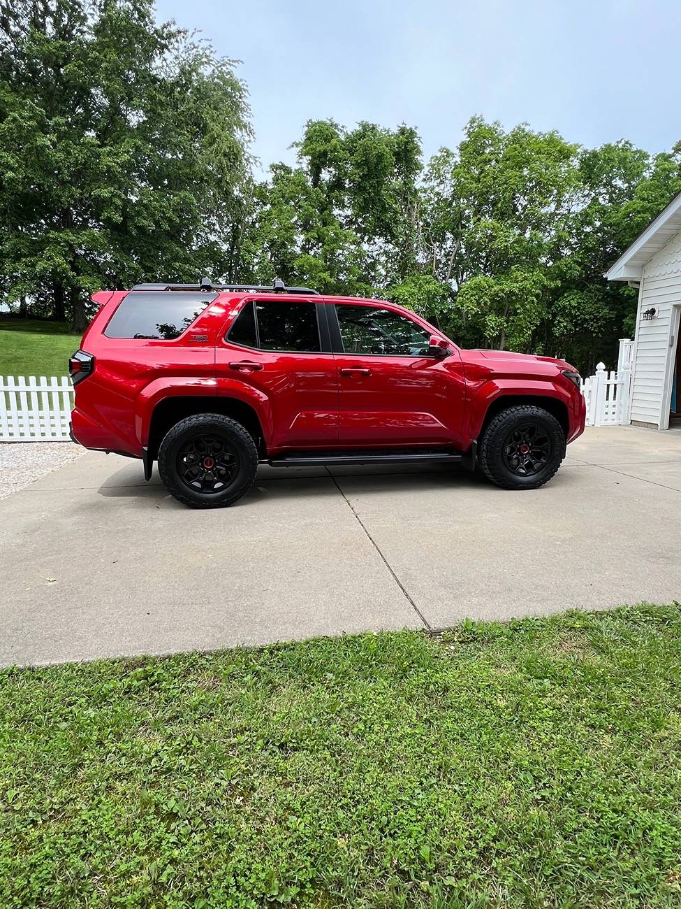

I went with a 265/65/r18. Almost identical at 31.6”. OEM tires are 31.5”. 2025 TRS Pro 18” wheels.

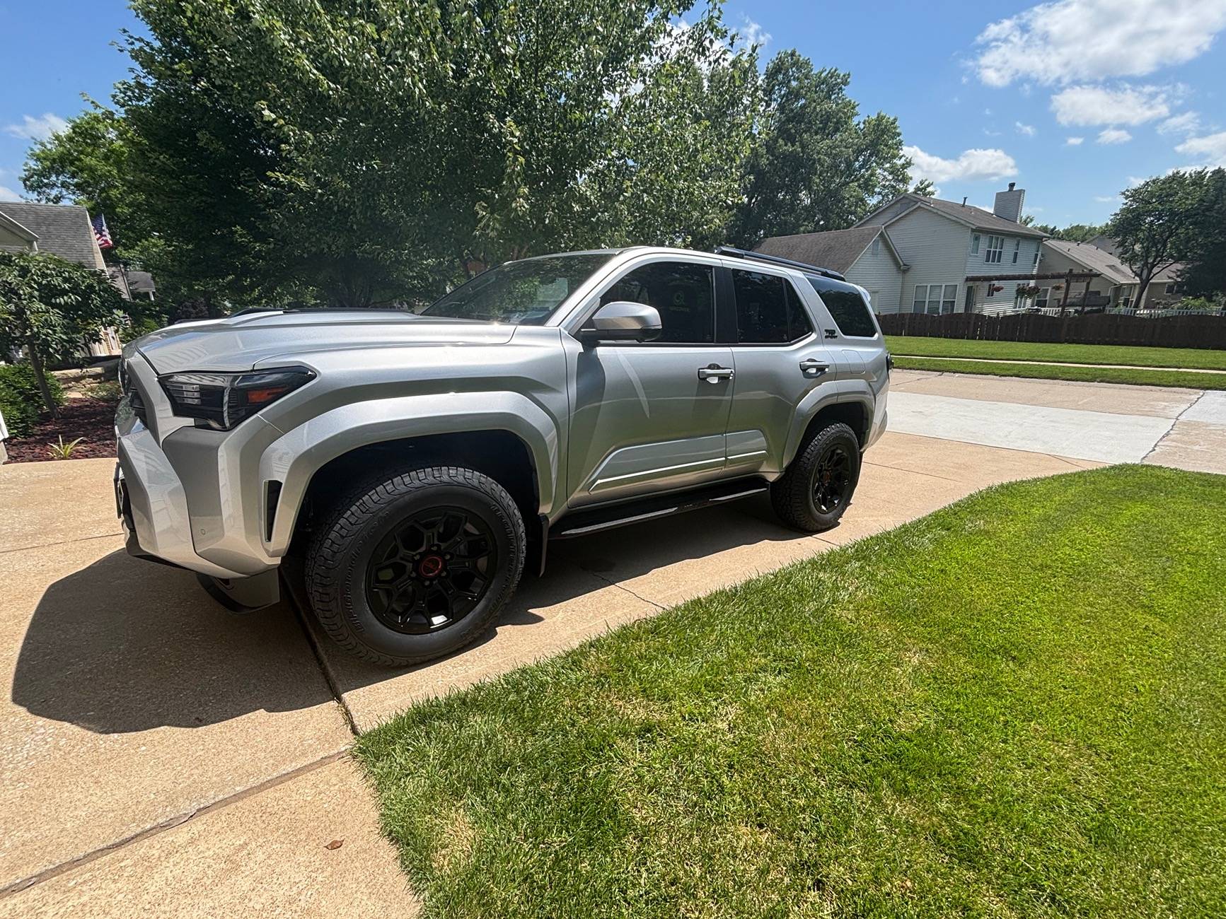

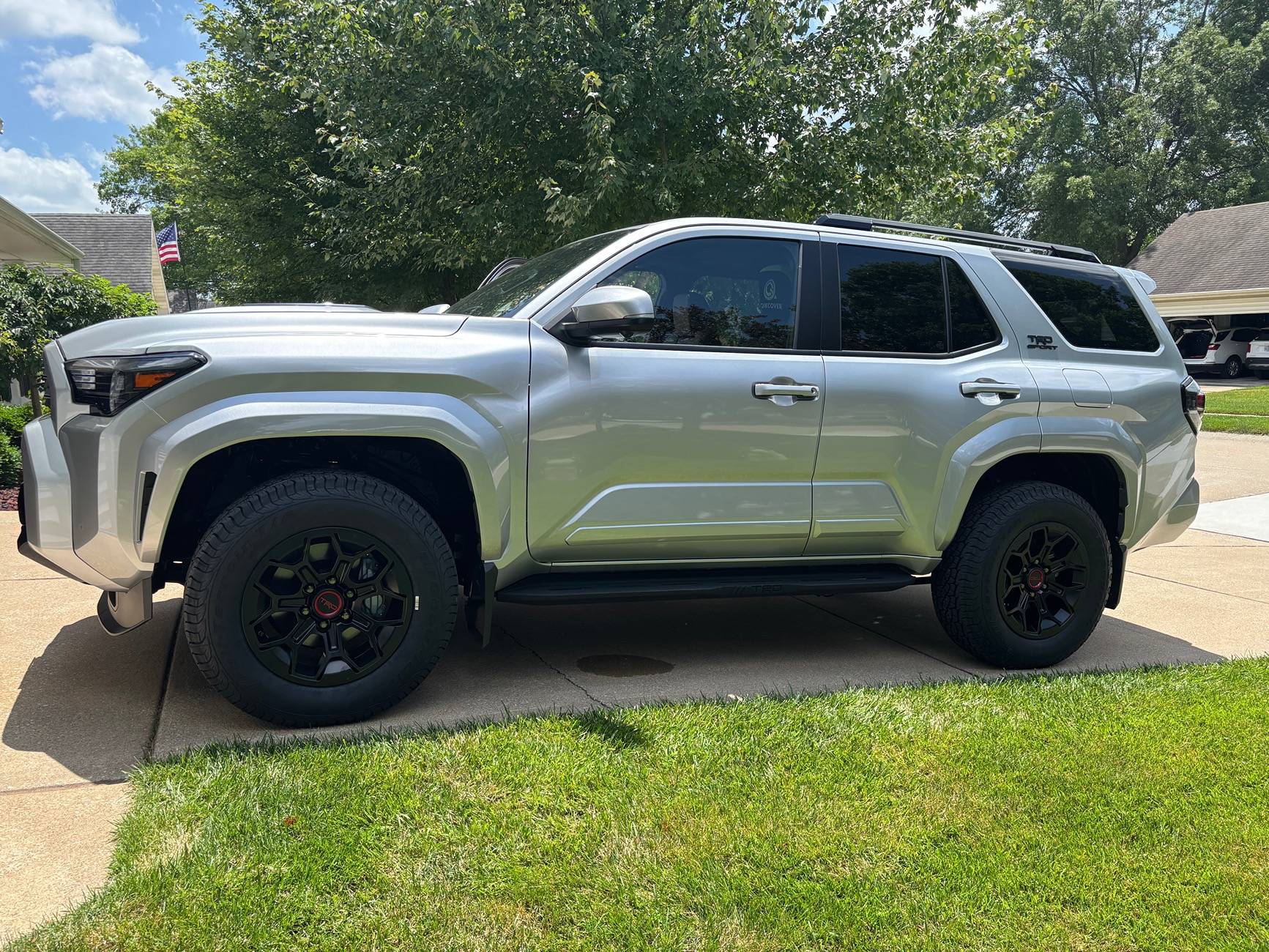

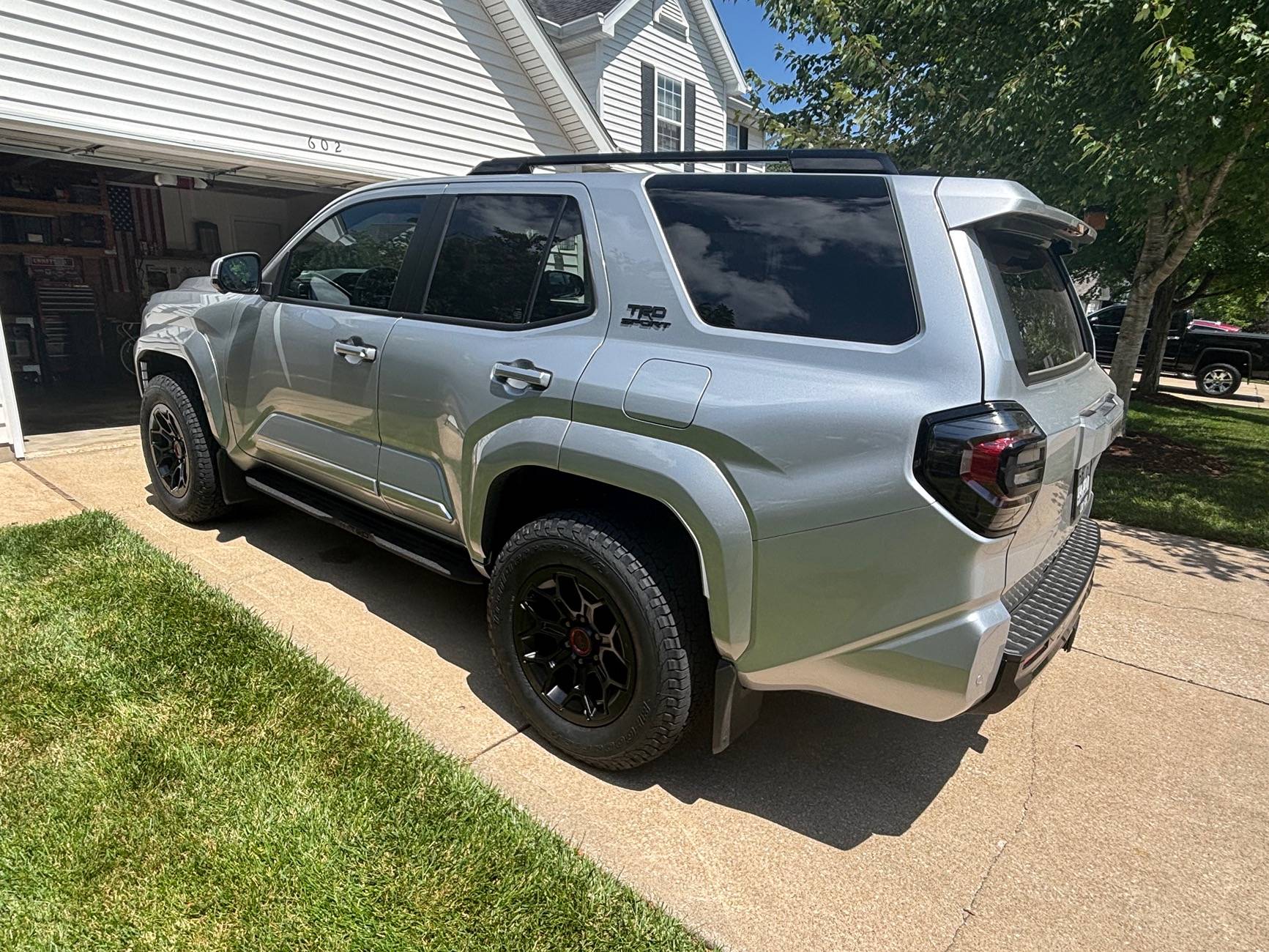

don’t those wheels push the tires outside the fenders?
perryj101
Joe
Apr 24, 2025
58
St. Peters, MO
2013 Toyota Venza XLE
They do stick out past fenders about 1/4 inch. No level or lift kit. No rubbing.

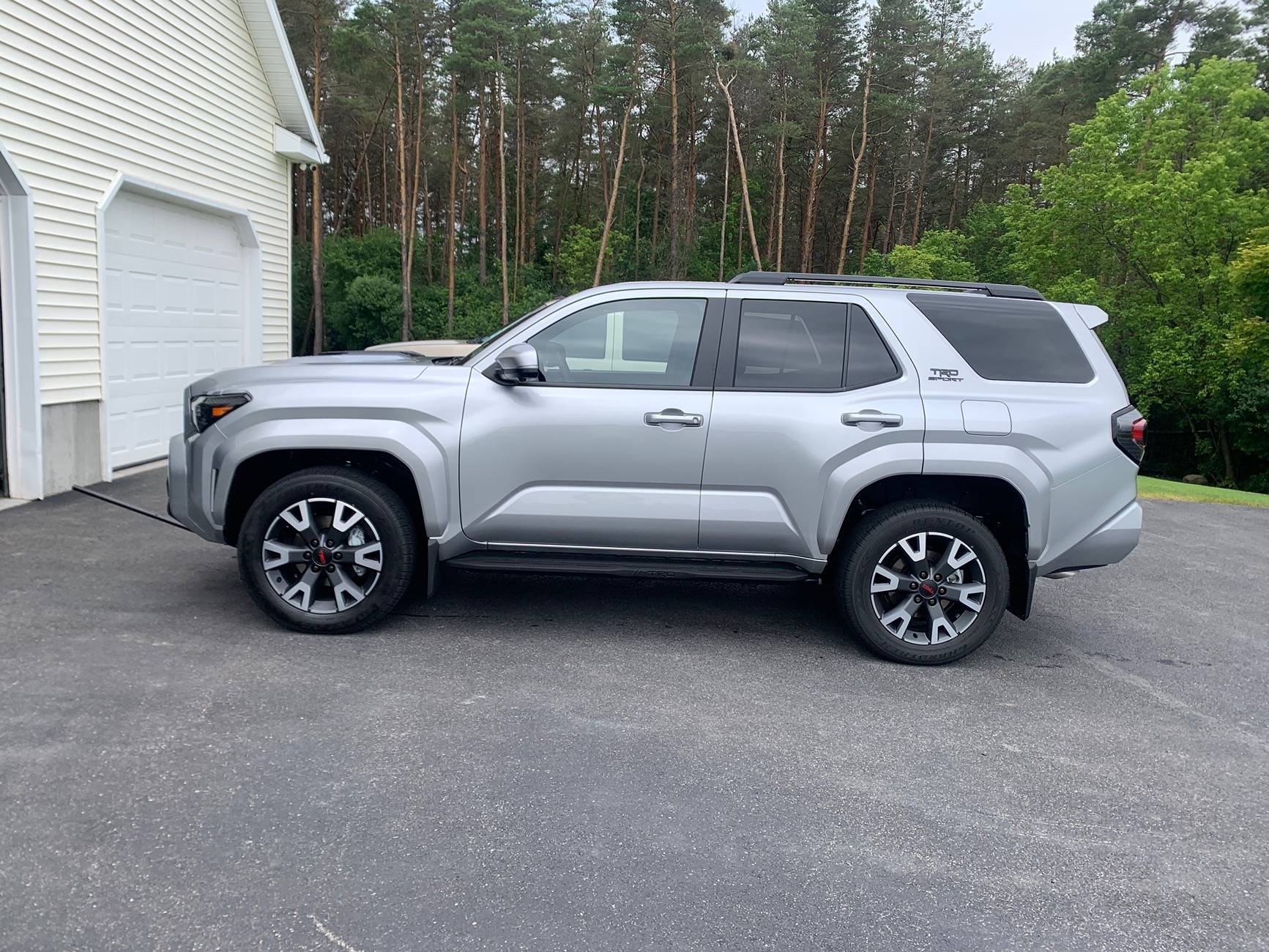

No. Same offset as factory. . +25 mm
We have a trd sport the offset is +55 I think the fender flares are wider on the trd off-road and trd pro

I stand corrected. I’ll post a picture later. They don’t stick out much.
