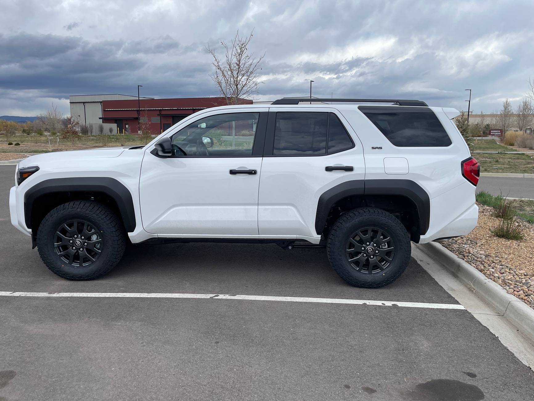

Looks really good. Any rubbing with the wider tire? Read 285 done even rub but thought I would ask.
Yeah no rubbing, not even close. I really like this size. It did drop mpg from 26 to 21 (I drive light and live at altitude which helps) but really like it.

Sweet! Is that highway mpg? I’m getting about 23 combined on the stocks. I get your same tires put on Friday ?

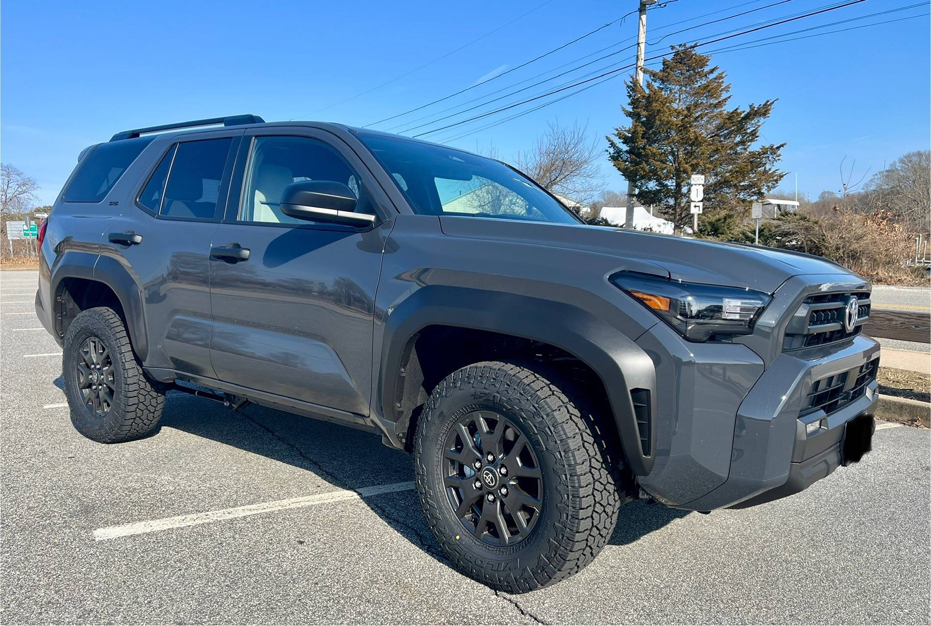

That was total combined with me trying to be super easy on it. Nice, such a good tire!
I have about 2,200 miles on mine now. Odometer is at 20.0 mpg with about 65% city / 35% highway driving. I think I lost about 1mpg from removing the air dam and about 1mpg from the tire change, so overall I'm happy with it but hope I bring it up (kind of a fun game).

Interesting, I was going to remove my air dam this weekend and was wondering what the mpg penalty would be, if at all. Thanks

There's a video out covering this, the do a 50mile run and get about 0.7mpg loss with air dam removed vs. with installed.

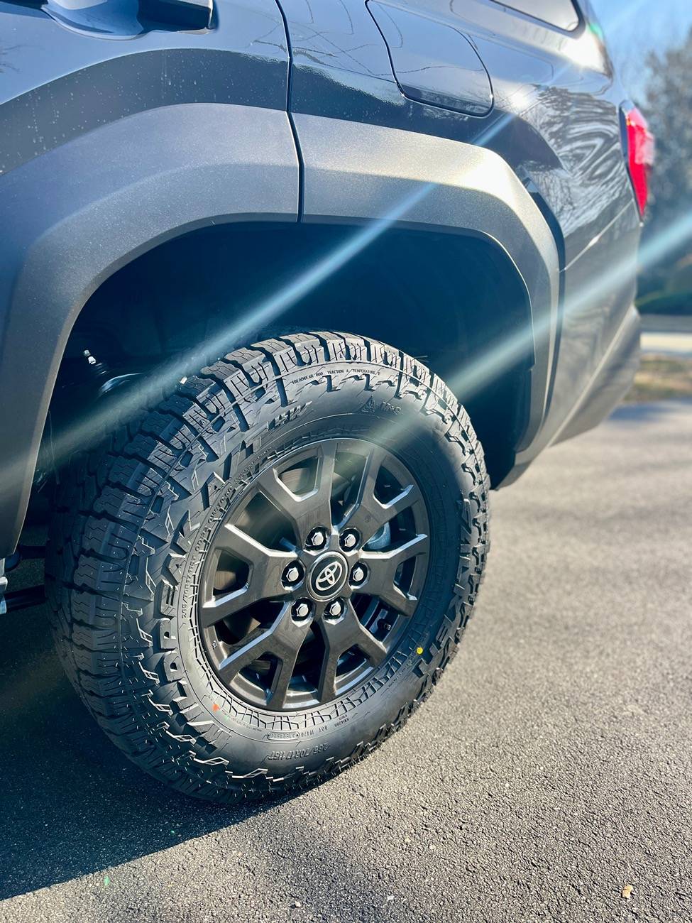

Wanted to bump up the OEM SR5 tires just a bit, which were 245/70R17 (30.5” diameter).
Installed 265/70R17 Falken Wildpeak AT4W tires (31.5" diameter) on the stock SR5 wheels.
Any rubbing issues ?
