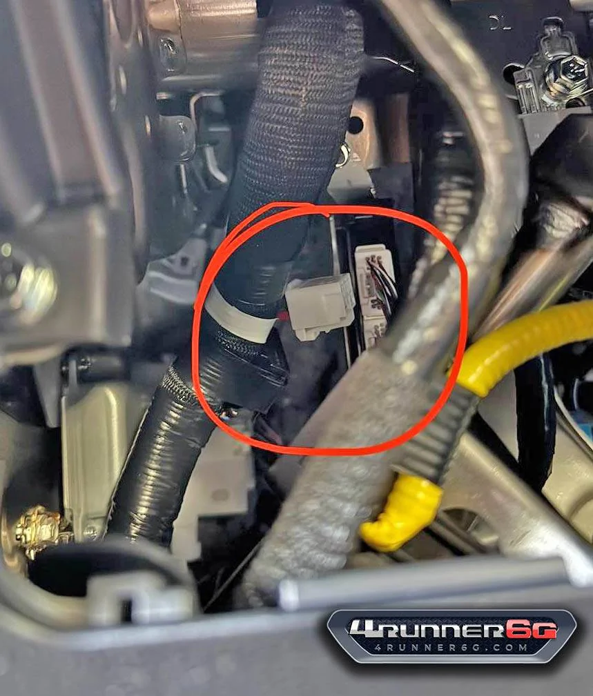

Still digging here. These might not be the wires we are looking for :(
I was under the impression the controller plug would be on the left of the steering wheel but it may be on the right.
Will update later!

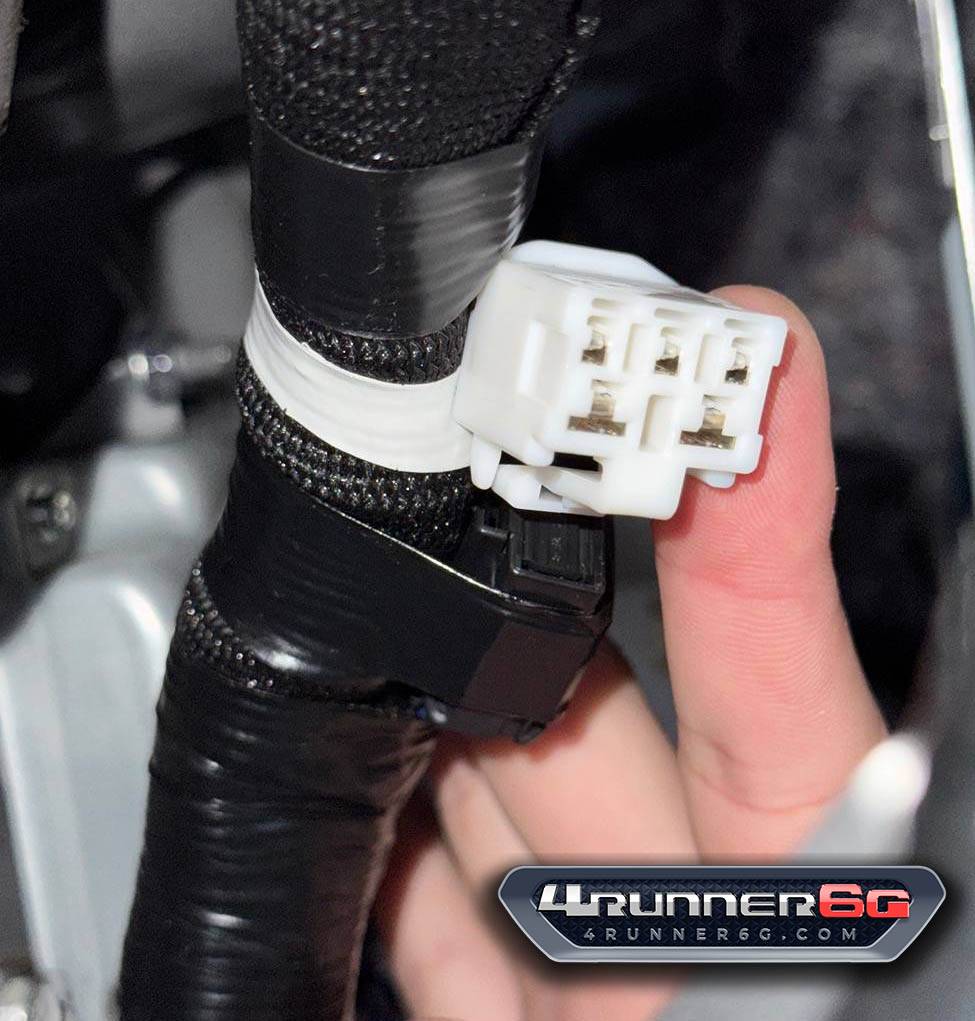

I was unable to find anything similar to what the tundras have in terms of color of wires and position but this connector type is exactly the same as what should be compatible with a trailer brake controller. I’d be interested to see if this is in fact the right connector if anyone has a redarc to connect to it using the tph-021 harness.

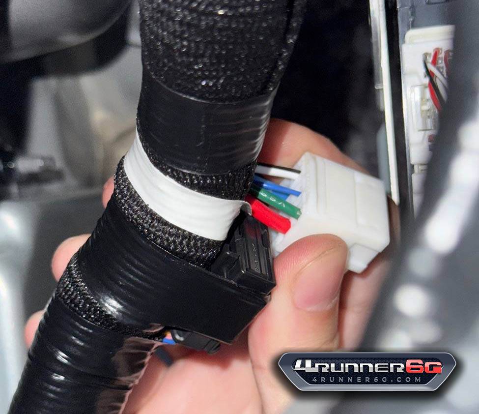

Just a little comparison with zoomed in pics.
First the Tundra
2025 2026 4runner 6th gen Trailer Brake Controller Prewiring IMG_1072
Then the 4Runner
2025 2026 4runner 6th gen Trailer Brake Controller Prewiring IMG_1073

Unsure. This white harness is the prewired that tundra users can install trailer brake controllers with. If it is what it looks like you can very easily install something like a Redarc in just a few minutes. It just doesn’t work with the OEM brake controller.
