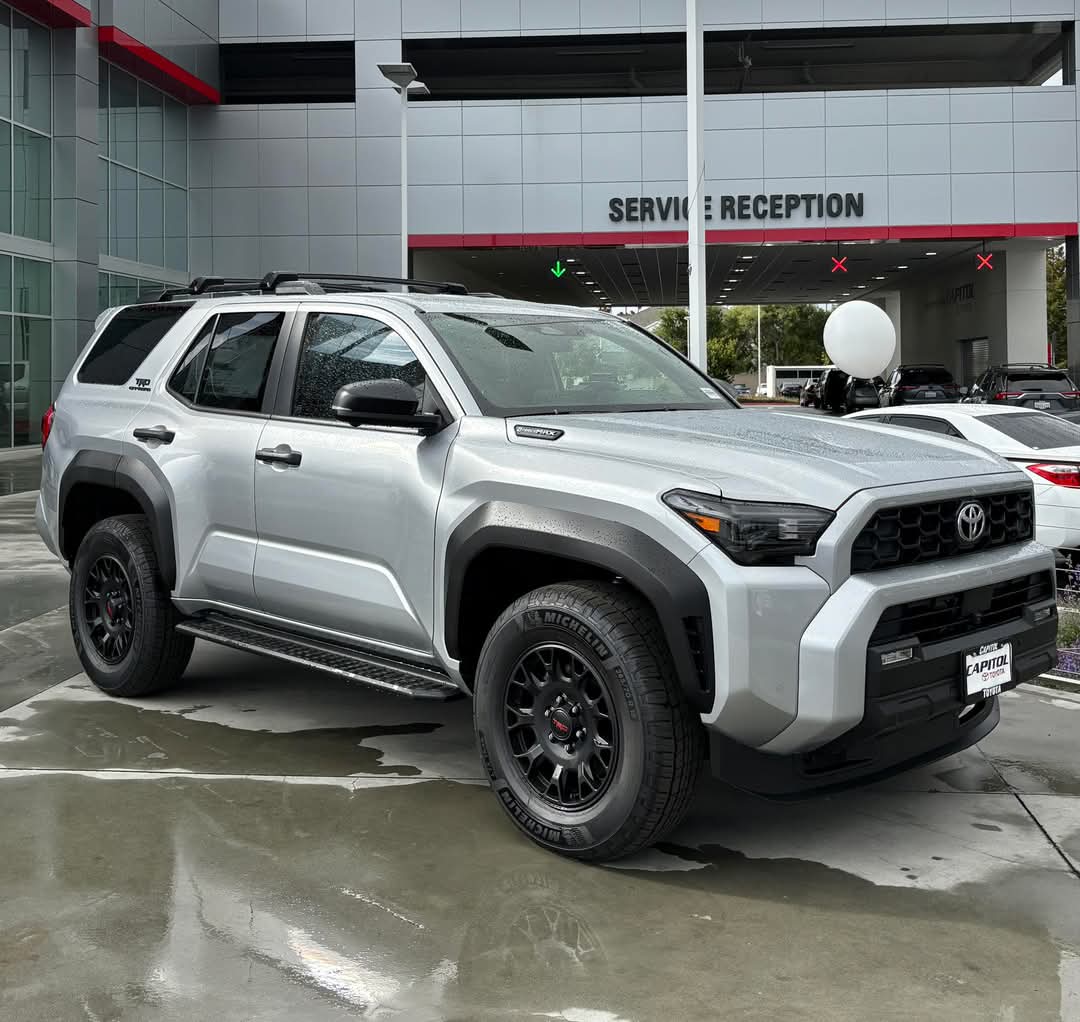

They are the same size so I assume they do and this Pic from FB kinda proves it. I have a set on order but they are backordered nationally.

The +45mm wheels with those tires will be inside your fender flares. Nicely pictured above.

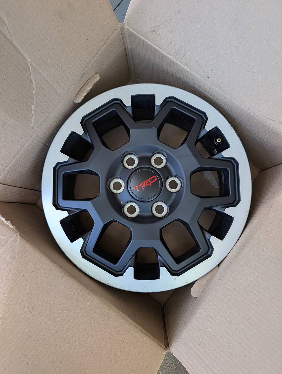

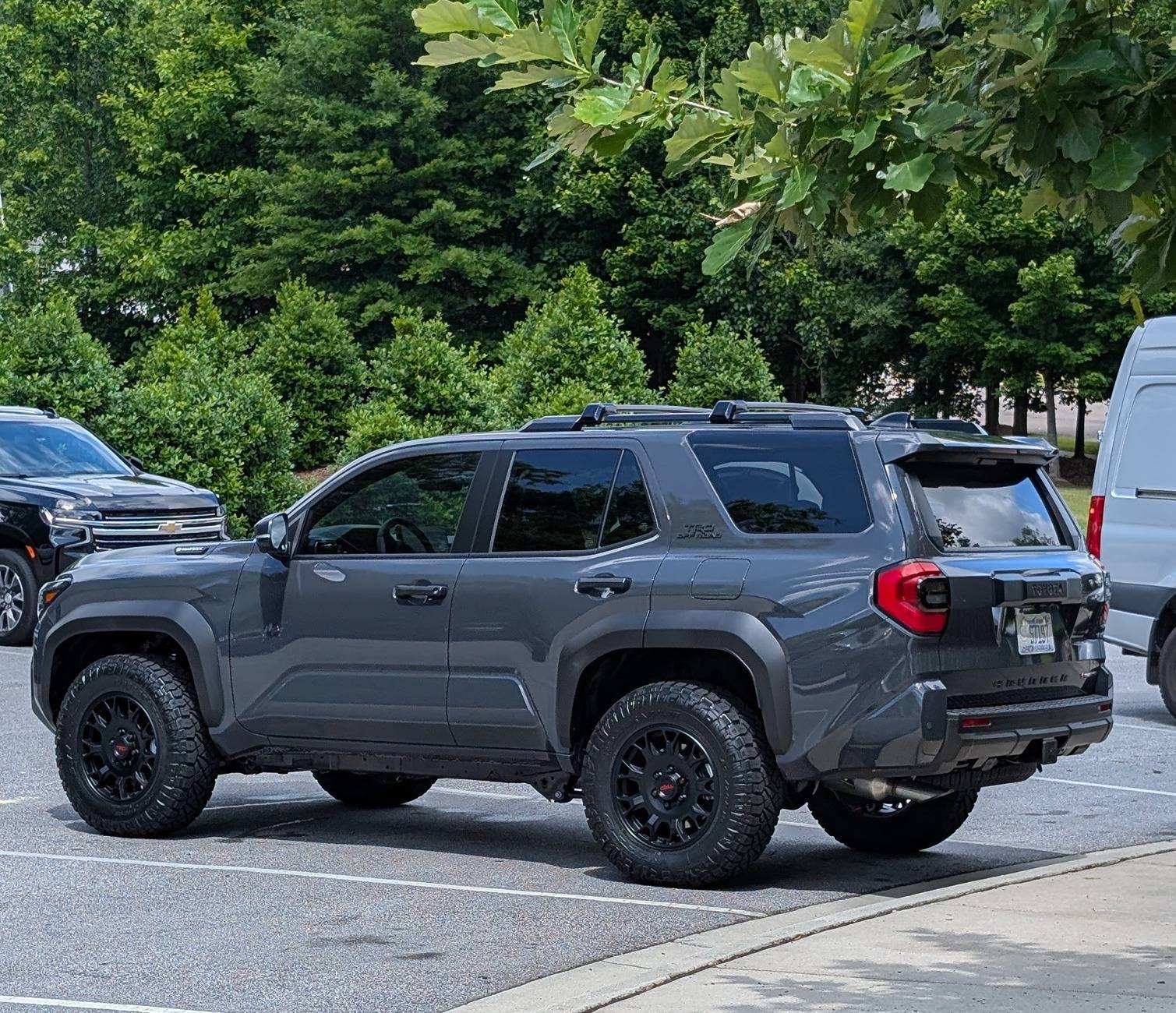

Yes, those tires will fit on the TRD black matte rims. I did the exact rim swap you're talking about on my TRD ORP hybrid, except the tire that came on my stock rims were the nitto grapplers (but still 265/70R18). See pics below of an original rim now sitting in my attic in a box vs the rims on my truck now. You should not have any issues with the swap you are wanting to do even in keeping the stock tire.
