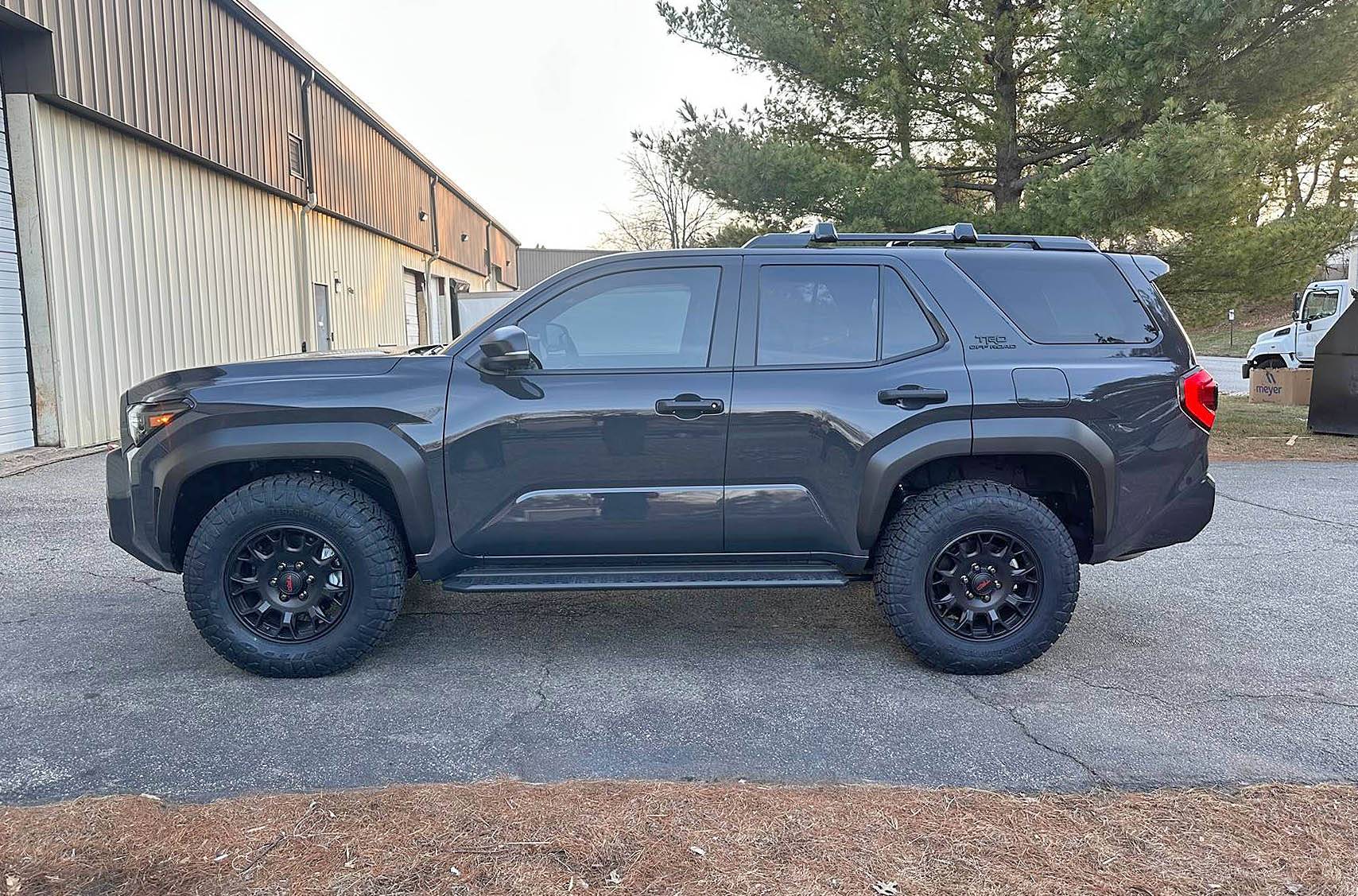

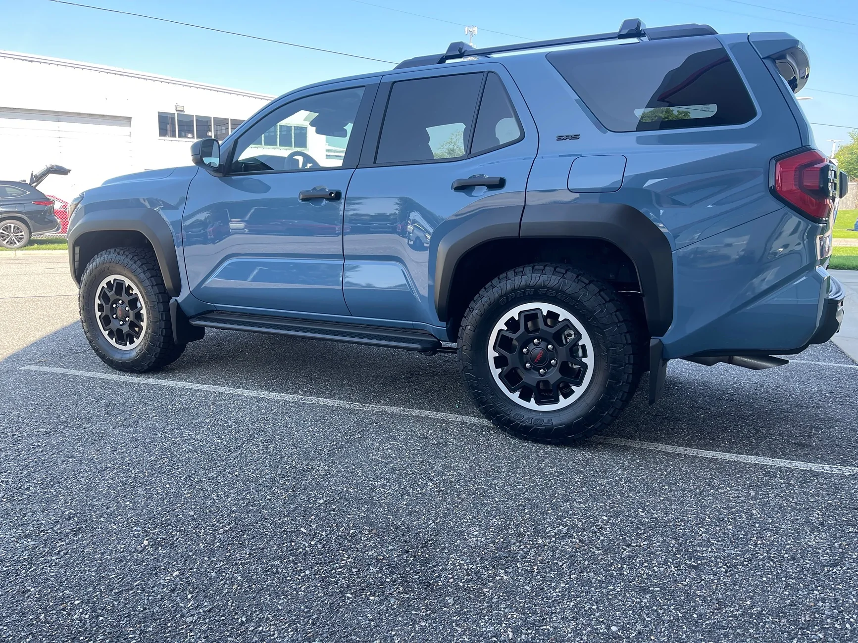

275/70/18 33" Nitto Terra Grappler tires installed on 18" Factory Upgrade TRD Wheels w/ no lift.

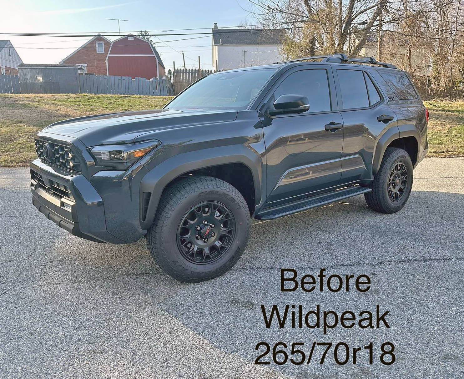

So I pulled the trigger on some 33" Nitto Terra Grapplers tires (replaces the Falken Wildpeak AT3WA that comes with 18" TRD Wheels package upgrade). At first I wanted to go 34" with a 285/70r18 but there were not many options for the 18" wheel. Most were E load and the only nice C load I could find were the Wildpeaks but they are Heavy! 70lbs per tire.
That being said this is my wife's car, I did not want to run the E load or the heavy tire so I chose to go with a 33s and I am happy. It drives very smooth on the highway with minimal noise and I like the way it looks for now but might add a lift in the future.
2025 Toyota 4runner 275/70r18 33" tires on TRD Off-Road Premium ORP no lift (Nitto Terra Grappler on 18" Factory Upgrade TRD Wheels) beforewildpeaktires
2025 Toyota 4runner 275/70r18 33" tires on TRD Off-Road Premium ORP no lift (Nitto Terra Grappler on 18" Factory Upgrade TRD Wheels) afterwildpeaktires

As far as you can tell, would 34” tires fit without a lift?
