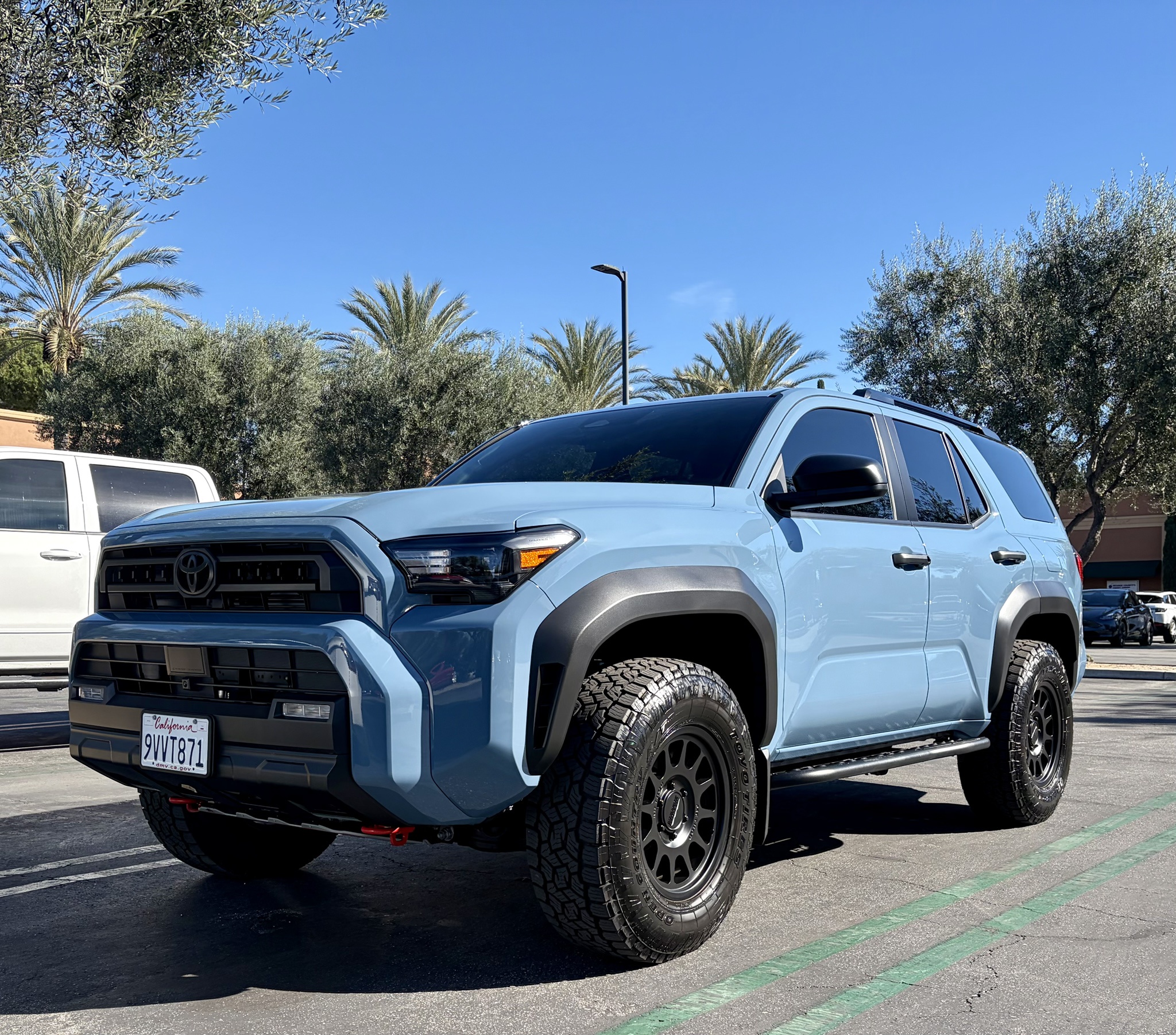

It will work just fine. Might be one of the more common set ups.
I have those exact wheels and tires on mine. I do have a ReadyLift leveling kit, but its not needed for fitment, more so just looks:

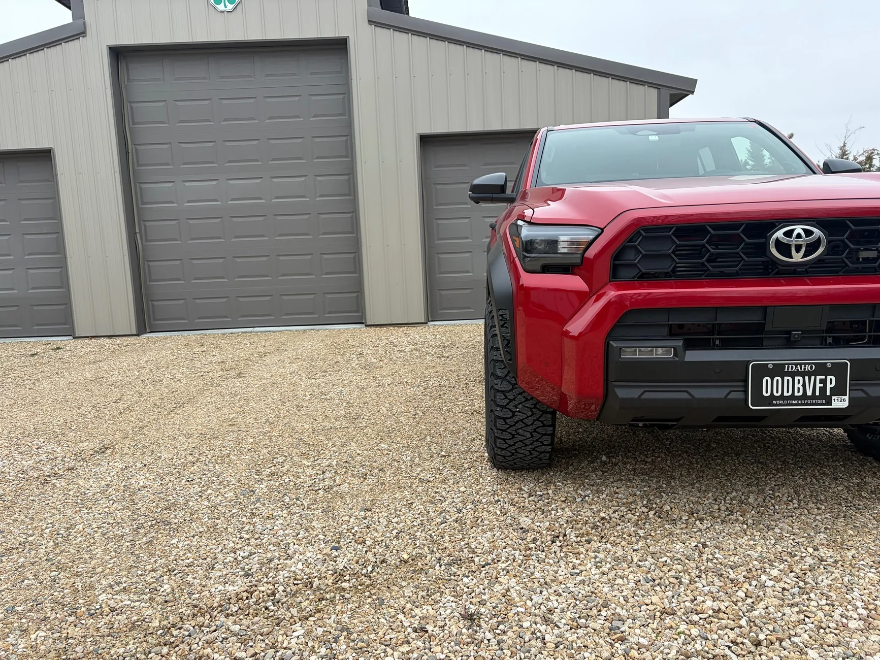

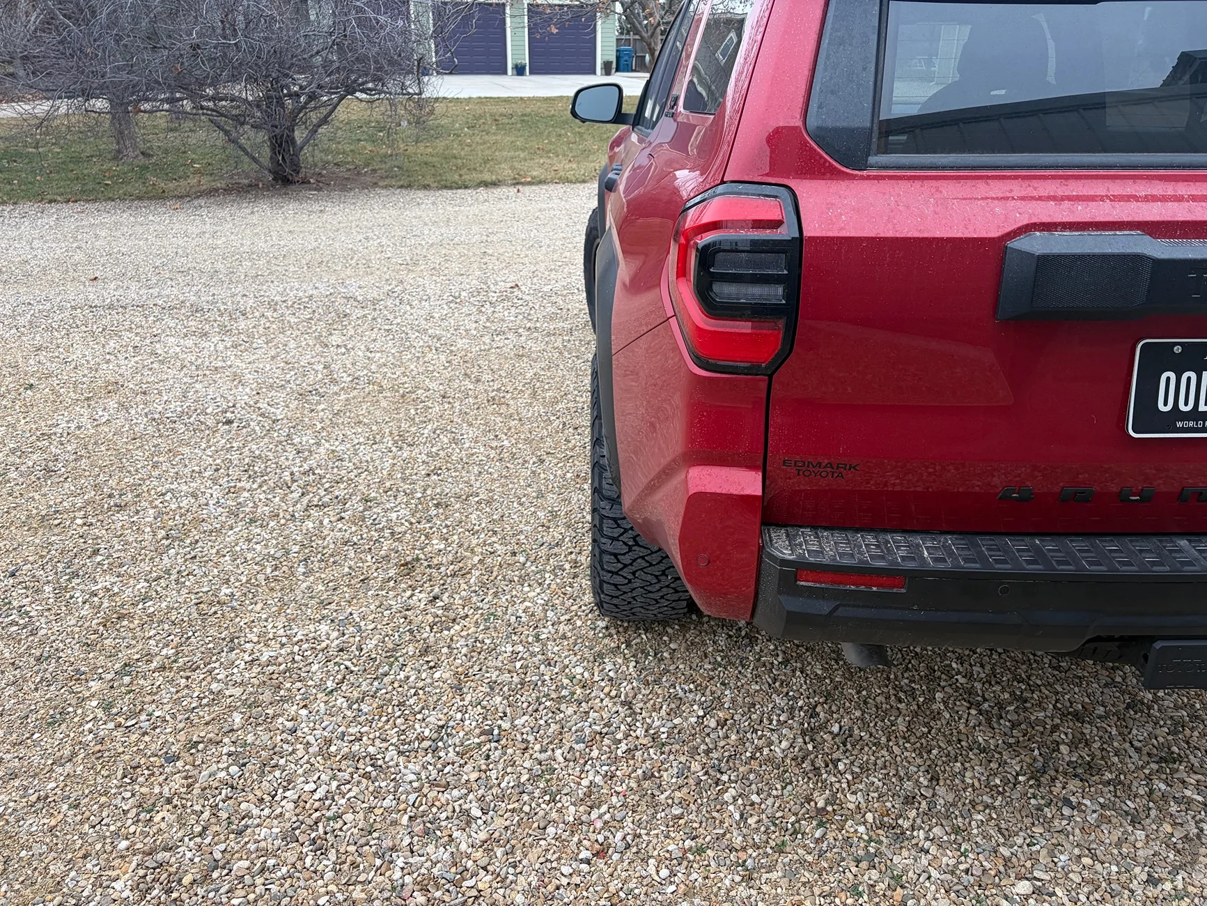

ECK
Evans
Nov 10, 2025
Idaho
2025 4Runner TRD ORP
Yes, it’ll fit.
I’m running the same Method wheels and also have 285/70/17 tires on stock suspension w/ no lift.
+35mm offset will result in the sides of the tires being close to flush with the fender flare.

existentialshirt
Feb 9, 2026
2026 4R ORP
Yes, it’ll fit.
Great looking truck. Thank you!
existentialshirt
Feb 9, 2026
2026 4R ORP
Thanks!

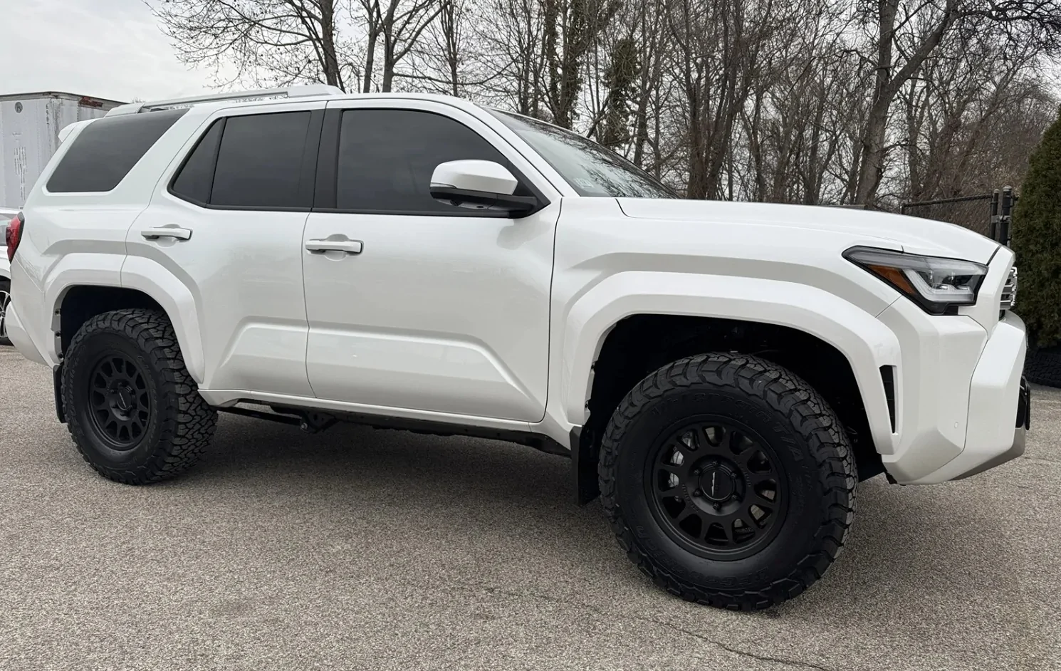

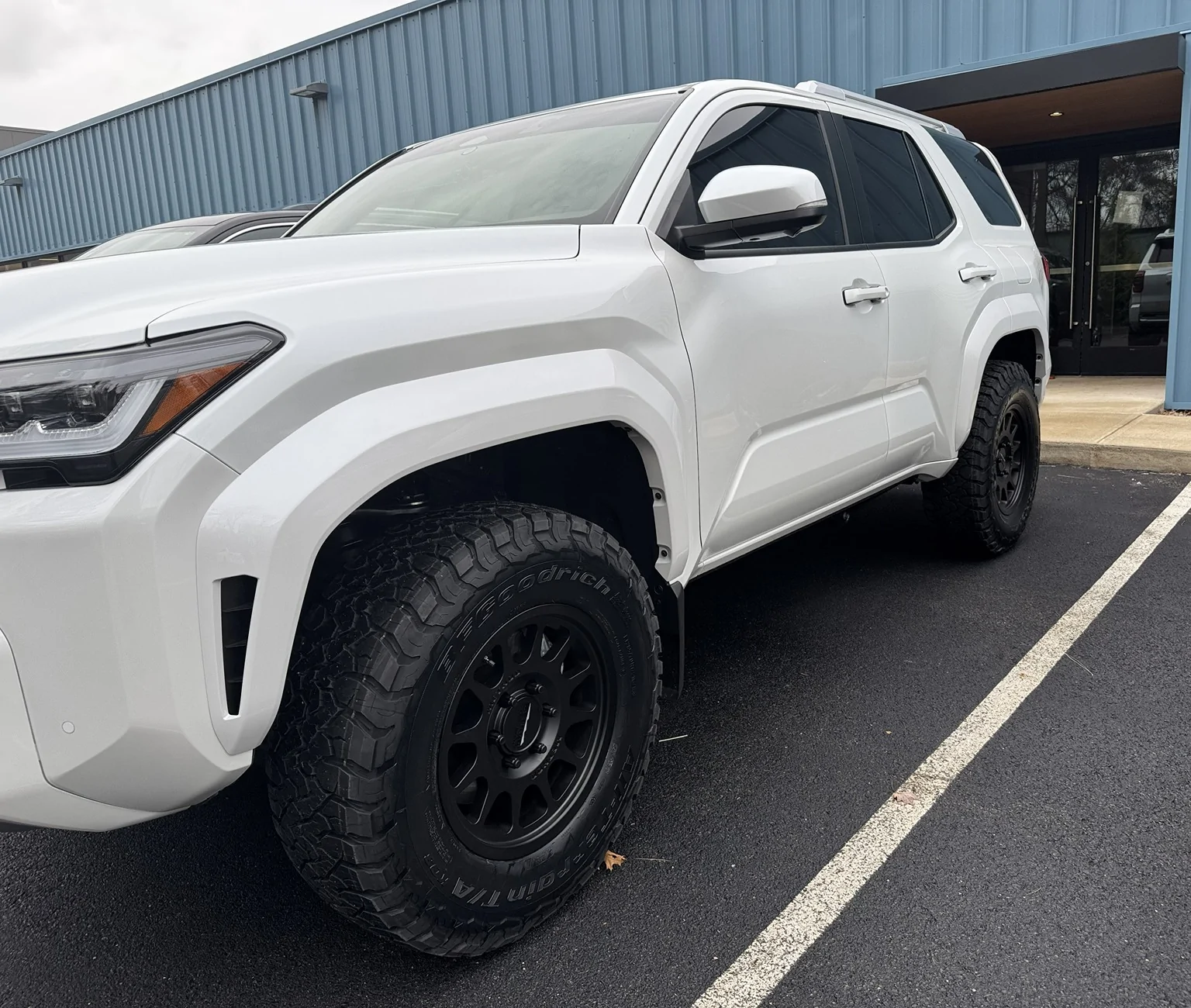

kzanard
Kevin
Sep 10, 2025
Weymouth, MA
2025 4Runner Limited, 2023 Dodge Challenger Scatpack widebody, 2018 HD RGS
I run those wheels (Method 703) and offset (+35), Tires (285/70/17 - K03's) and fit is fine. I also added a Readylift leveling kit in the front, but fitment was fine without the lift. I have a Limited trim.
