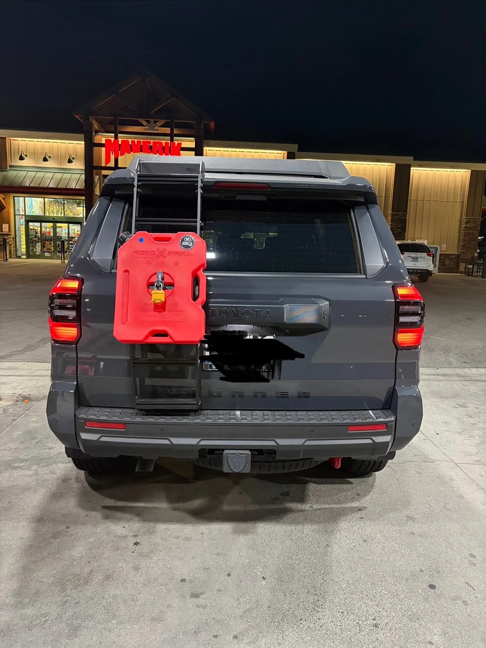

Hi, I just wanted to give a heads up to people who are going to install the Rotopax mount on their Westcott designs ladder. If you watch the install video online it’s not a 6th gen he’s installing it on, therefore the step of the ladder he shows removing is the wrong one ( I learned this the hard way ). It’s the step above the one shown in the video. That’s the correct one to remove. Hope this helps anyone looking to add the rotopax to their ladder
