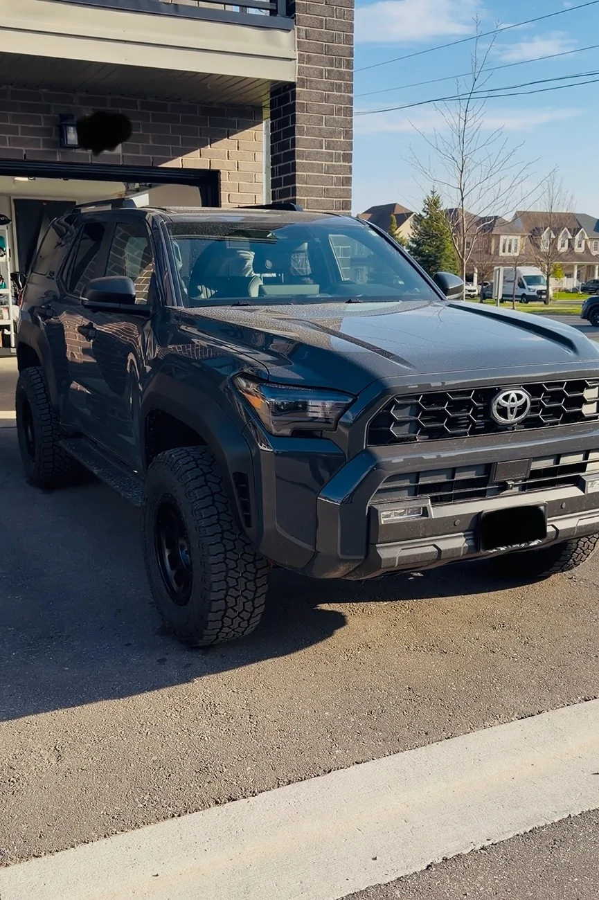

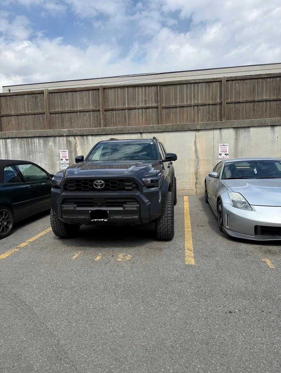

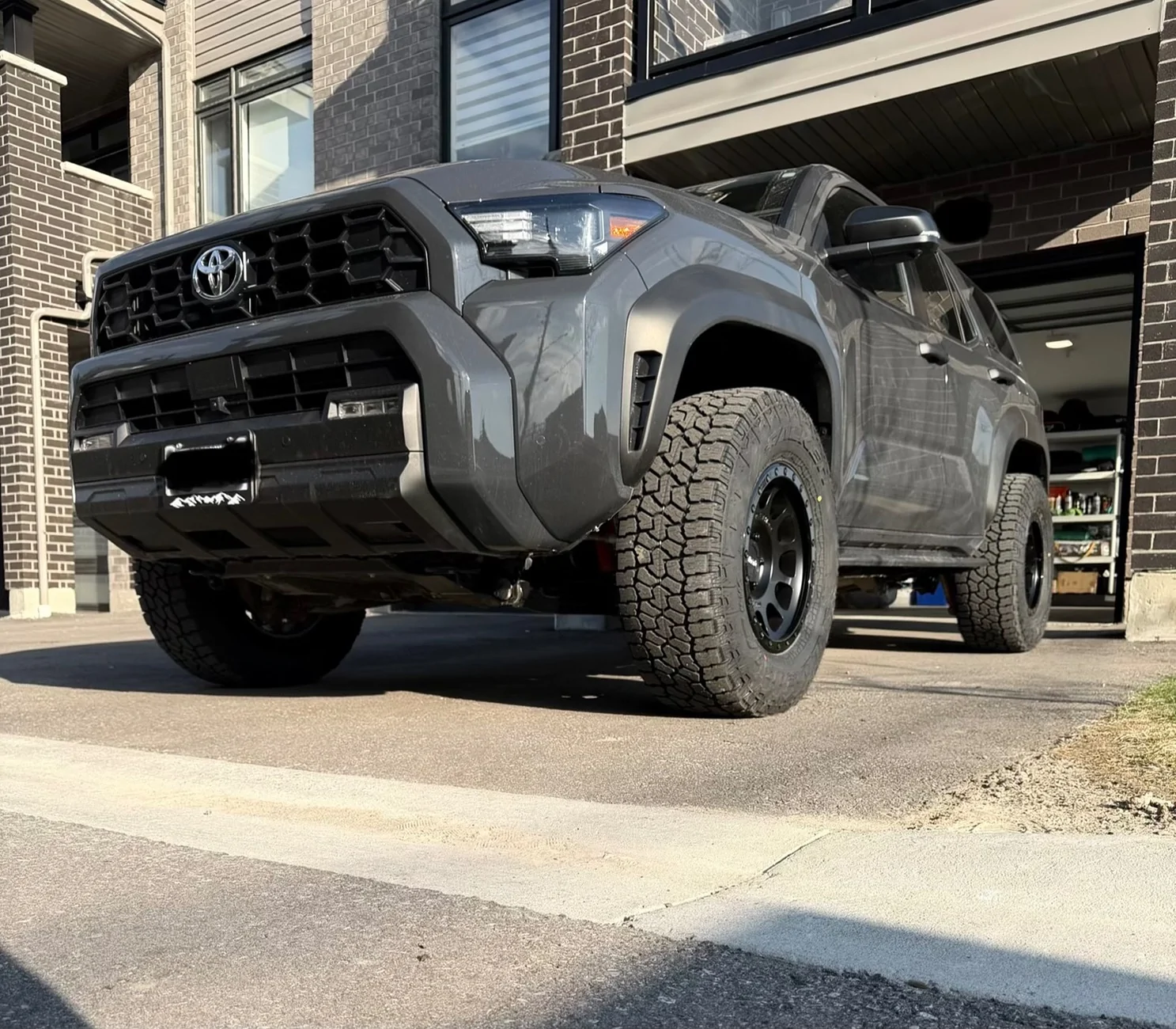

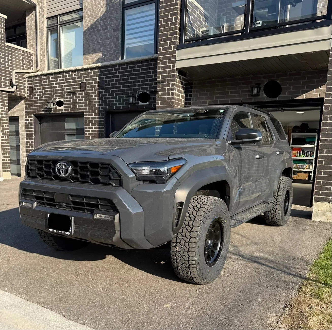

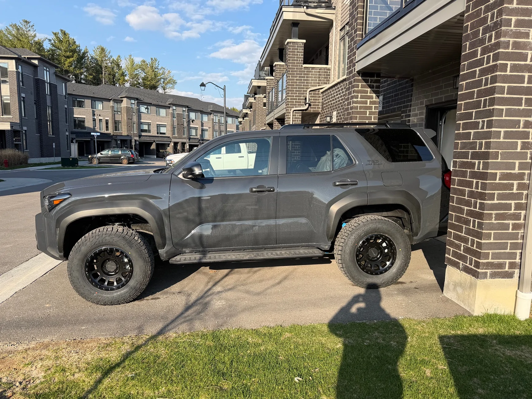

Installed the tires / rims / lift today on my 2026 ORP. Didn’t have to remove the crash plate or tuck anything back or cut. Super happy with the results. The wheels are +0 offset.
detailed specs:
Tires: Falken WildPeak AT4W 285/70/17
Load rating: SL
Rims: Method 305 NV Double black 17inch, +0 offset
lift: Westcott designs Pre-load collar lift. 2.5” front / 0.75 “ back
